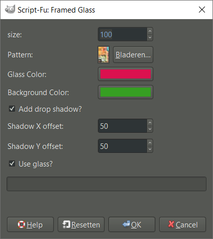

Yes, here I am again. I found something nice again. Does not work in Gimp 2.10, but it works in 2.8
Here is an example and the file.

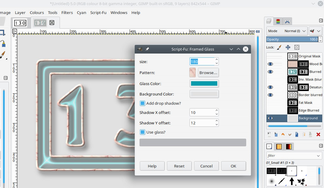

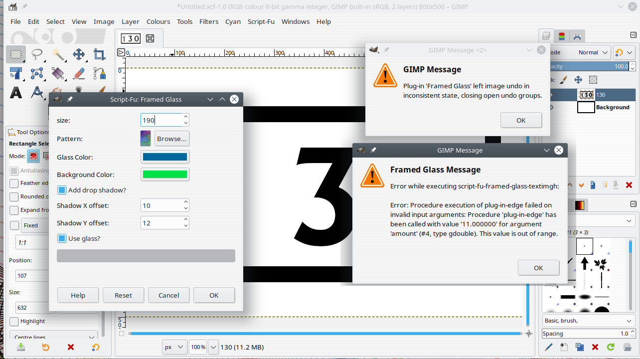

This is one problem, line 383 which uses plug-in-edge. Putting in a large value for size into the script can give an error but it also depends on canvas size.
The plugin changed from
Gimp 2.8: amount FLOAT Edge detection amount
to
Gimp 2.10: amount FLOAT Edge detection amount (1 <= amount <= 10)
Probably not going to bother most users. however a quick remedy is fix the value of amount in the script.
