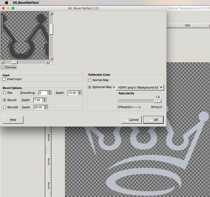

Anyone have an idea about this error I'm running into? Notice the missing scroll button, cancel, and OK. All of the files are in place (but the script may not like the location). I'm not certain if its not finding the loader, or if its not finding the icon. Maybe I'm missing a dependency? Any thoughts?
(mlbevelreflect2:78734): LibGimp-CRITICAL **: 17:02:07.246: gimp_drawable_preview_set_drawable_id: assertion 'priv->drawable_ID < 1' failed
(mlbevelreflect2:78734): Gtk-WARNING **: 17:02:07.895: Error loading theme icon 'gtk-cancel' for stock: Unable to load image-loading module: gdk-pixbuf-2.0/2.10.0/loaders/libpixbufloader-svg.so: dlopen(gdk-pixbuf-2.0/2.10.0/loaders/libpixbufloader-svg.so, 1): image not found
(mlbevelreflect2:78734): Gtk-WARNING **: 17:02:07.896: Error loading theme icon 'gtk-ok' for stock: Unable to load image-loading module: gdk-pixbuf-2.0/2.10.0/loaders/libpixbufloader-svg.so: dlopen(gdk-pixbuf-2.0/2.10.0/loaders/libpixbufloader-svg.so, 1): image not found
(mlbevelreflect2:78734): Gtk-WARNING **: 17:02:08.009: dlopen(gtk-2.0/2.10.0/immodules/im-quartz.so, 1): image not found
(mlbevelreflect2:78734): Gtk-WARNING **: 17:02:08.009: Loading IM context type 'quartz' failed
(mlbevelreflect2:78734): Gtk-WARNING **: 17:02:08.011: dlopen(gtk-2.0/2.10.0/immodules/im-quartz.so, 1): image not found
(mlbevelreflect2:78734): Gtk-WARNING **: 17:02:08.011: Loading IM context type 'quartz' failed

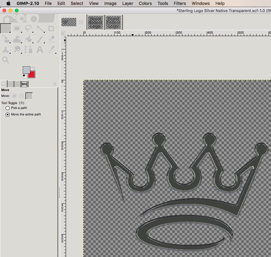

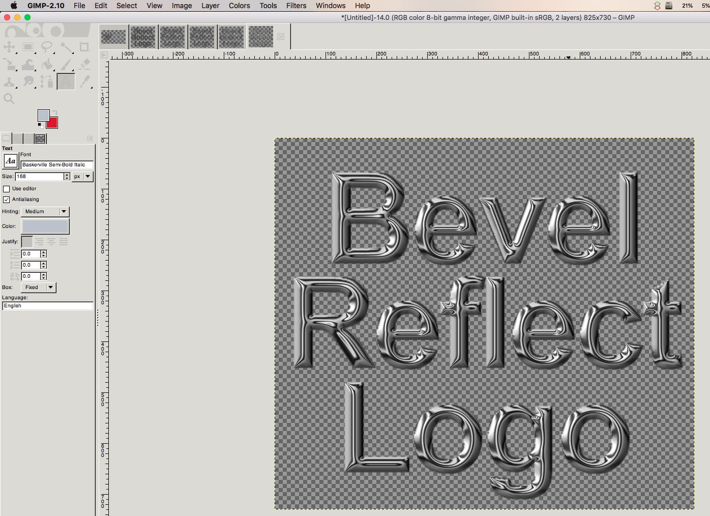

Here are some screenshots:

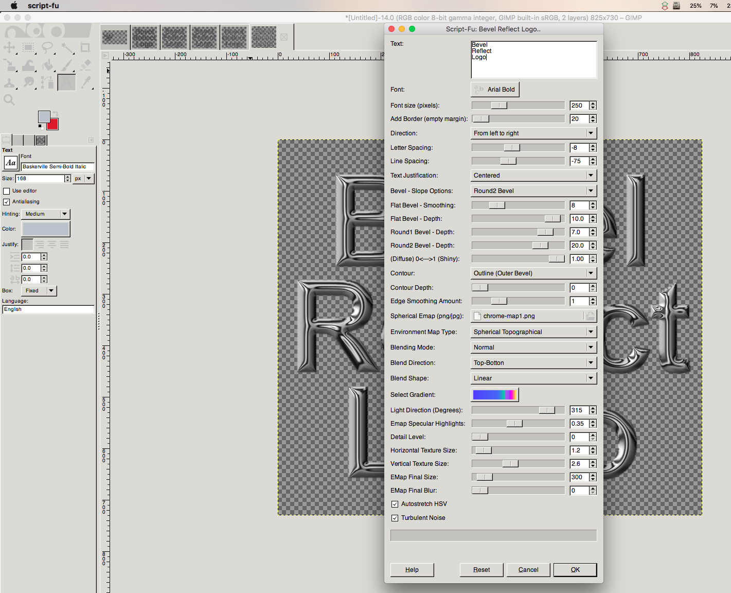

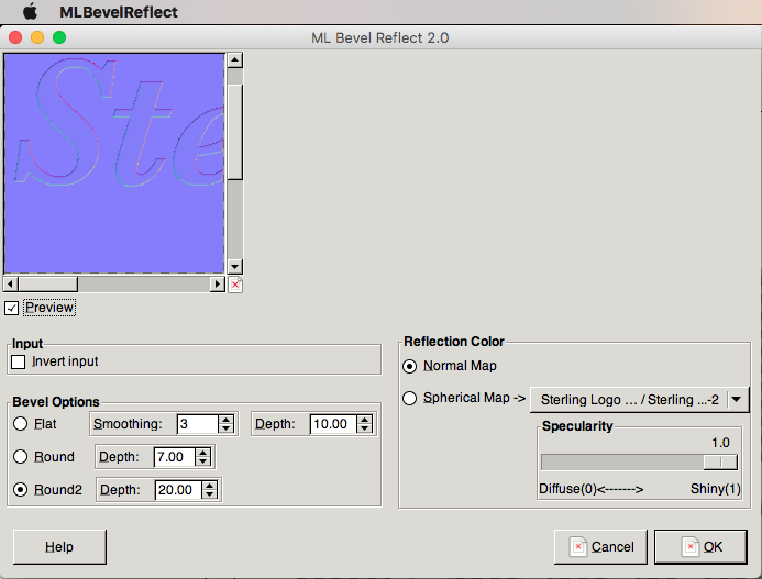

Here is another:
