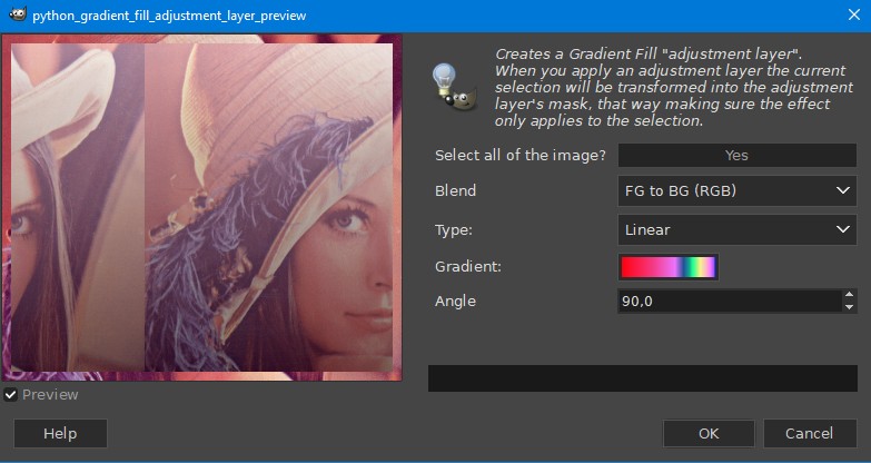

Here is a "with preview" module (It's just a modification of "gimpfu.py").
It enables you to code "from fu_preview import *" in your python plug-ins to add a preview.
It's given with no warranties at all. It's just a "proof of concept".

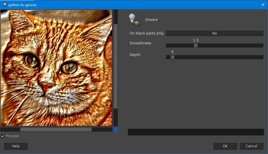

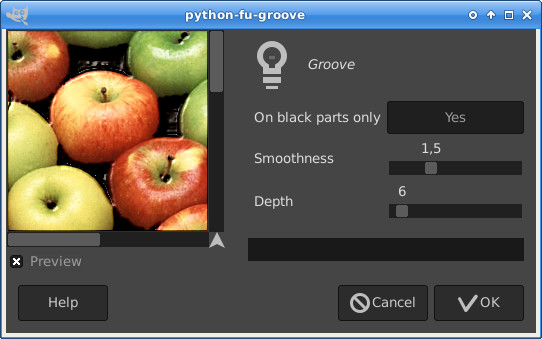

Here is an example (the preview has been added to the "groove" plugin):

Groove.py works fine with preview.
BoxEffect.py doesn't even register in the menu.
Trying to increase the preview by dragging will usually crash Gimp (but not always) - how to increase the preview window in fu_preview.py?

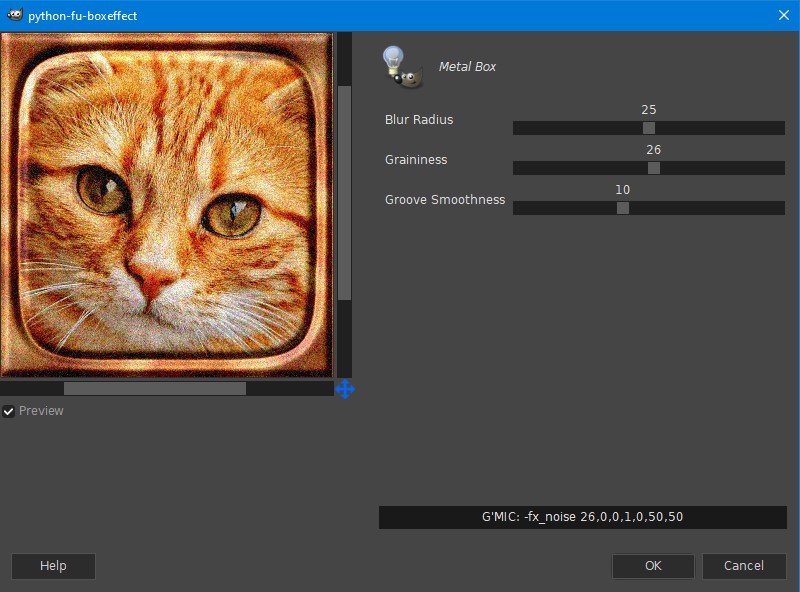

By analyzing the last test from boxEffect.py, I discovered the cause.
In boxEffect.py, gimpfu appears twice (from gimpfu import * and from gimpfu import _query) - after changing gimpfu to fu_preview twice, the plugin works with preview.
Another solution (I tried it - it works) might be to add the code fu_preview.py to each plugin we want to preview (it's only 971 lines of code with a comment - and in Windows there is often a problem with multipart plugins).
Another point is completely different - groove.py needs to be upgraded for gmic-2.9.8. (different number of parameters for fx_curves_interactive).

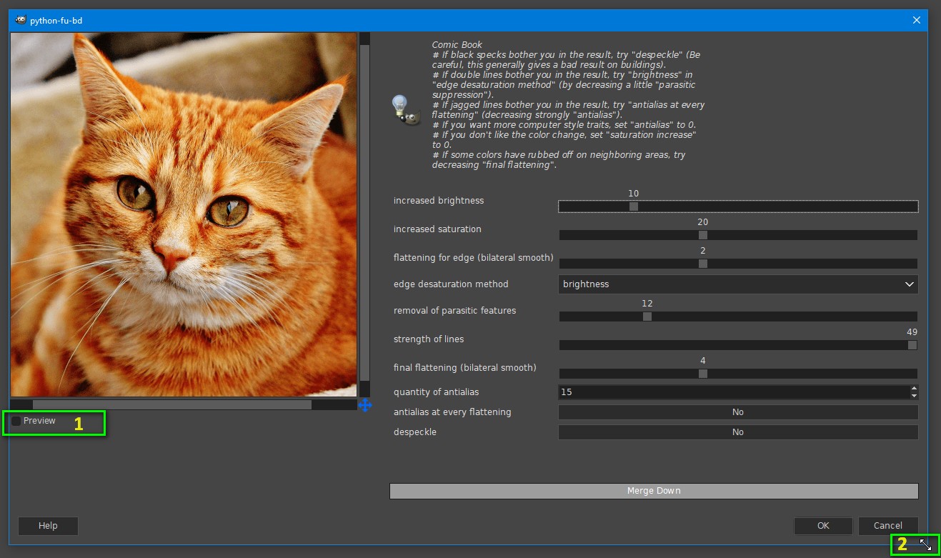

A simple way to enlarge the preview window (without crashing Gimp):
1. Disable preview.
2. Drag the corner.
3. Turn on the preview again.
Example with embedded code for fu_preview (and customized fx_curves_interactive).

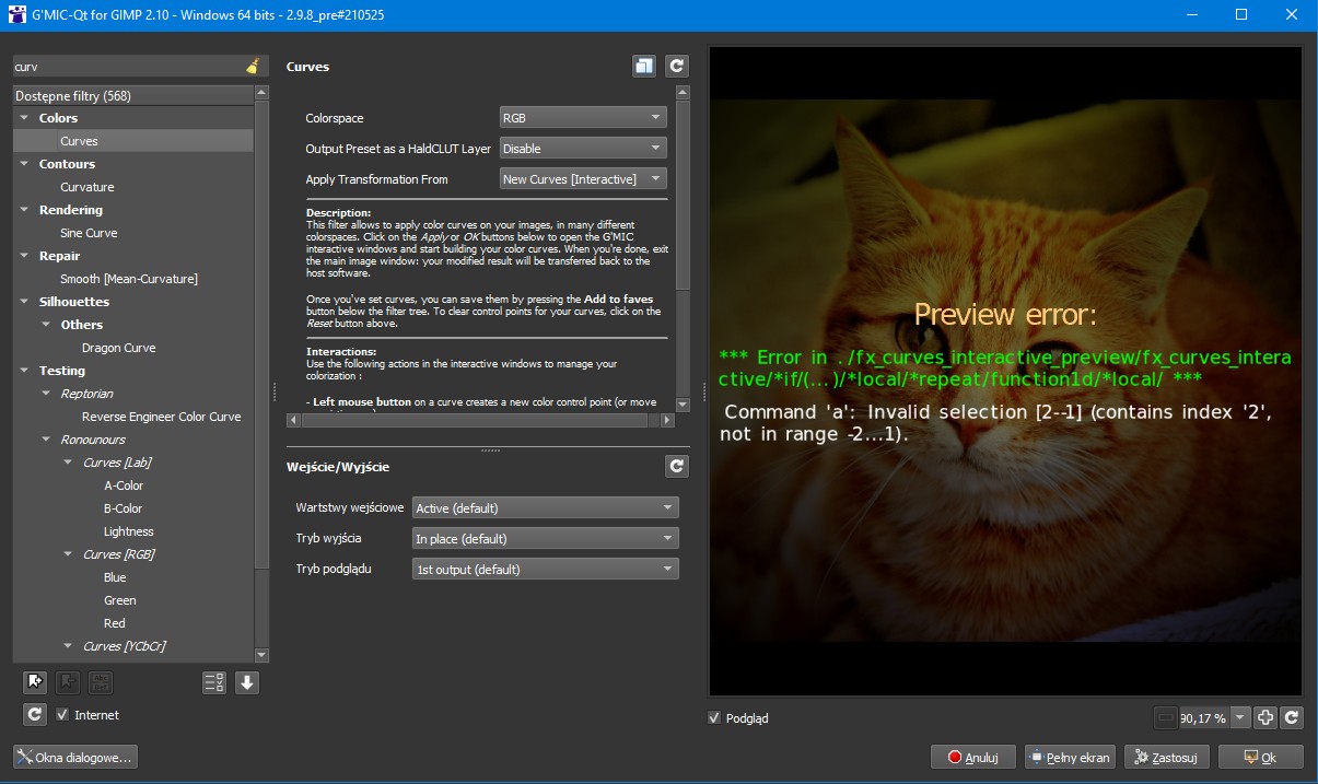

As with groove.py there was a problem with GMIC -fx_curves_interactive (but this is probably a temporary bug with the number of parameters in GMIC because running it gives an error).

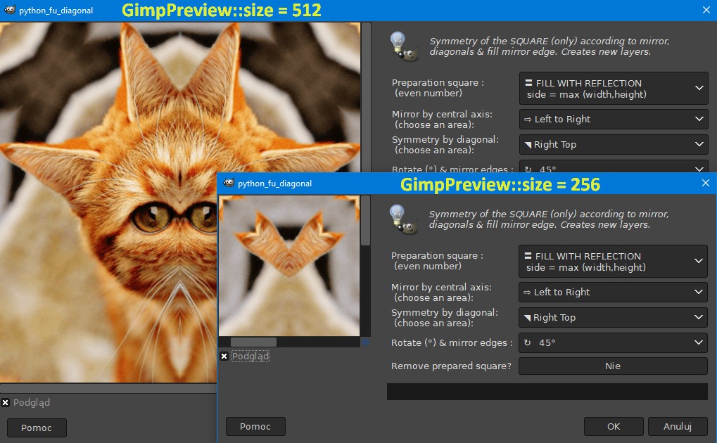

I remembered (Ofnuts tip in another thread) how to enlarge the preview window on startup (without dragging the edges).
You need to edit the file gtkrc [... etc\gimp\2.0\gtkrc]
Replace the following lines:
style "gimp-large-preview"
  GimpPreview::size = 256
# class "GimpPreview" style "gimp-large-preview"
on:
  GimpPreview::size = 512
Maybe there are other ways? :hoh

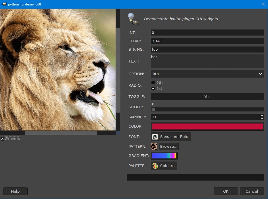

I've made an implementation for PF_COLOR, PF_SPINNER, PF_FONT, PF_STRING, PF_FLOAT, PF_INT, PF_TEXT, PF_PATTERN, PF_OPTION, PF_GRADIENT (not tested), PF_PALETTE (not tested)

Many thanks for the new features. :jumpclap
I tested new functions - everything works. :yes

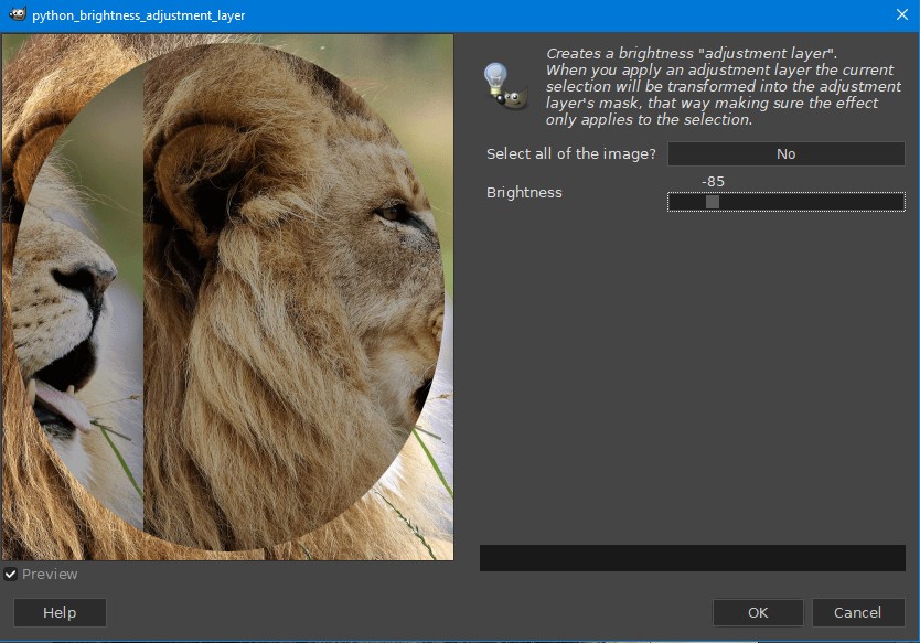

- There is a problem when you use the selection
preview (strange shift) - but the result is correct.

There is a problem when you use the selection preview (strange shift)
I have not even thought about the possibility of making a selection before using a filter.
This problem seems more complex to fix.
