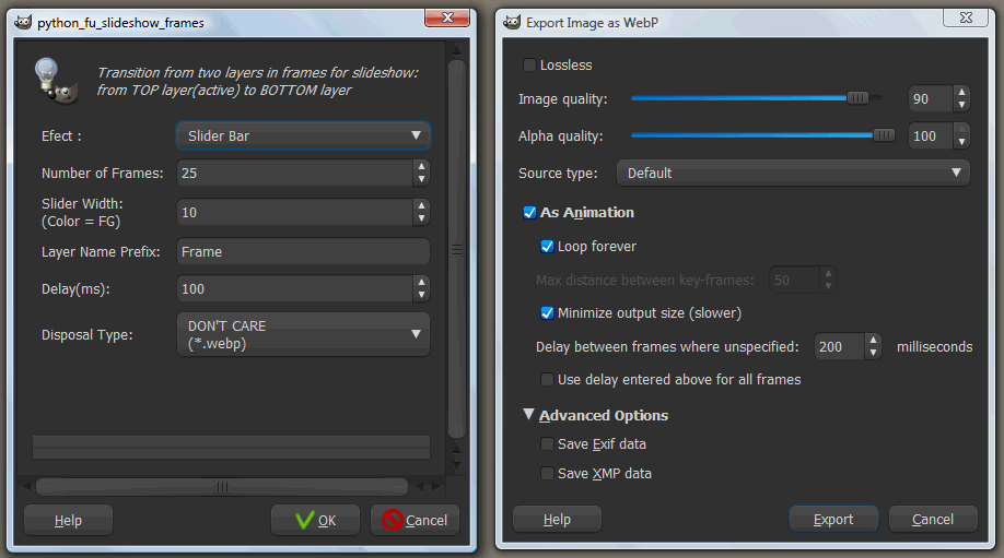

Trandoductin presented very interesting effects for video.
Since Gimp supports the webp format very well, you can use it instead of gif.
It's the perfect format for small presentations/slideshow.
With very good examples of the Tin Tran code, I combined it into one of its three plugins:

You can use the IrfanView 4.52 program (for Windows) to play as animation webp files:
https://www.irfanview.com/plugins.htm

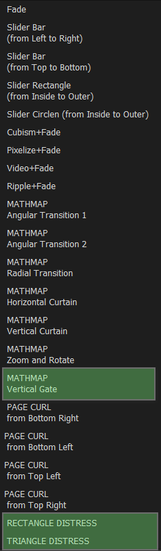

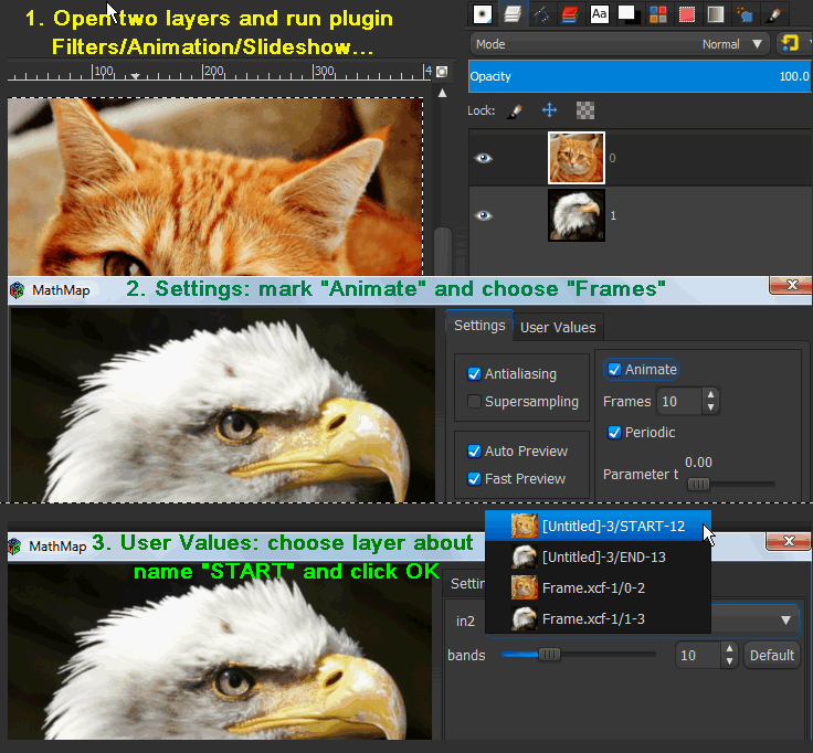

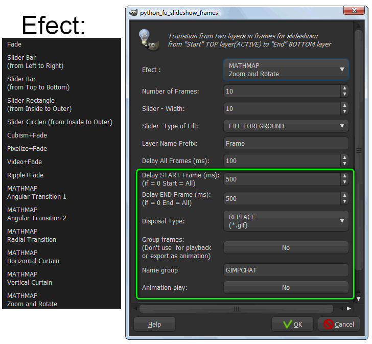

Ver.2
Add efect:
- Slider Bar(from Top to Bottom),
- Ripple+Fade,
- MathMap: Angular Transition 1, Angular Transition 2, Radial Transition, Horizontal Curtain, Vertical Curtain, Zoom and Rotate.
Add option:
- Type of Fill for Slider: FILL-FOREGROUND, FILL-BACKGROUND, FILL-WHITE, FILL-TRANSPARENT, FILL-PATTERN,
- Delay START/END Frame (they should usually be displayed longer than the change itself/efect).
- Group Layers/frames (useful for combining more photos),
- Run Playback(interactive: animationplay).
