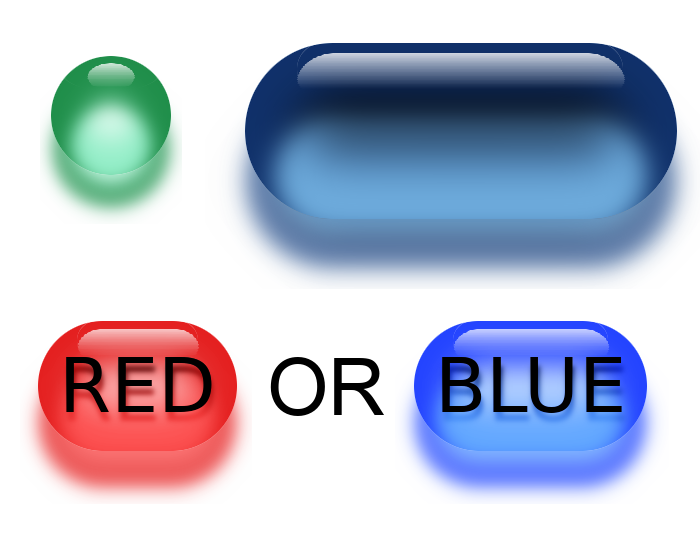

I sometimes use this script in Gimp 2.8.
Could it be fixed so I can use it in Gimp 2.10!

File->Create->AquaPro2
edit: Fixed displace type & LINEAR. Download from post #5.

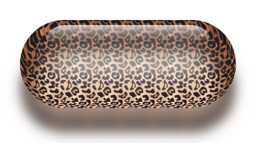

Script works in 2.10. I did notice that if I want to use a gradient or a pattern the script will not work. Do you have a solution for that?
 Post subject: Re: iccii-aquabou.scm
PostPosted: Wed May 19, 2021 12:41 pm  (#5)
Posts: 1435
Location: FInland
Yes, fixed.

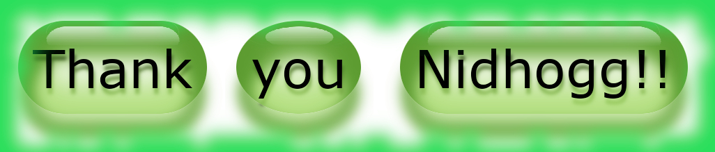

Joined: Jan 06, 2020
Posts: 401
Location: The Netherlands
Thank you ... now I am really completely satisfied!

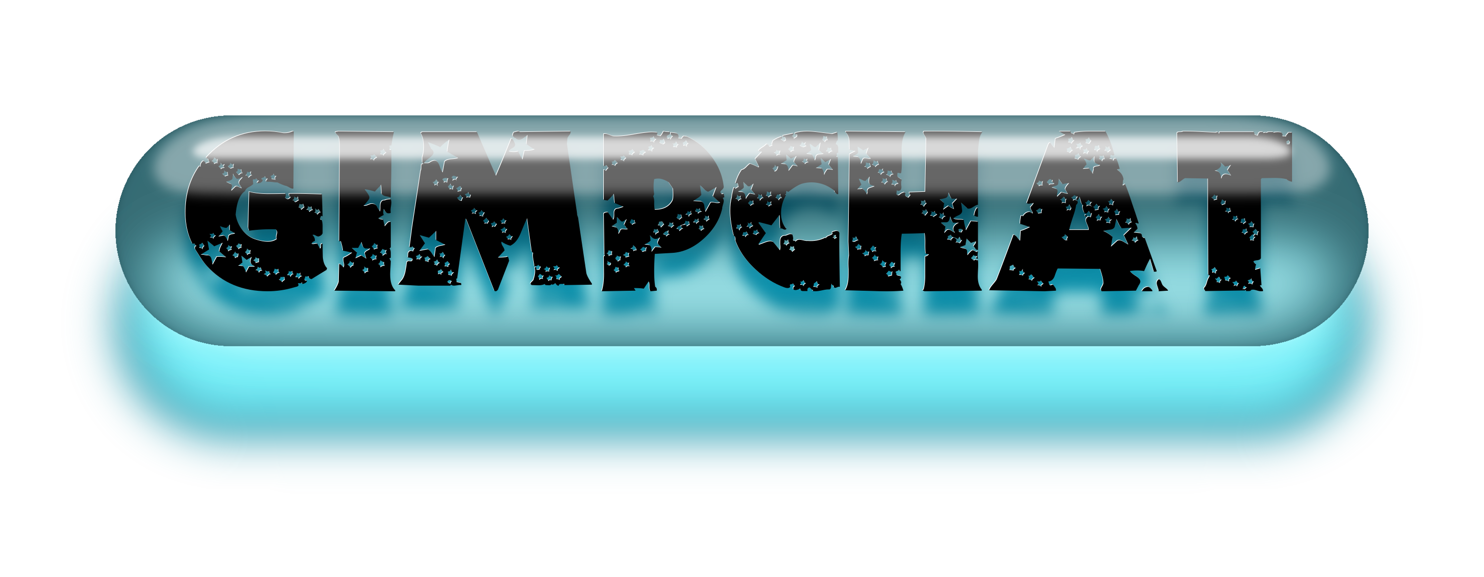

One thing I noticed from the first time I tested the script is that it doesn't warn about the user not having the default font.
I don't have the font classicheavylight. The script selects another font and runs without giving the user any information about which font they are using.
I also noticed that with the Logo In Pill:
01- If I enter 3 separate words in the Text field, 3 individual blocks are generated for each word.
02- But if I enter only one word, instead of generating a block with this word, the script generates a block for each letter of the word.
This result (individual blocks for letters of a word) is welcome, but it would be nice if the script also generated an entire word per block.
Thx.
Edited (PS)
I think I get it... with the Button option you can generate a whole word per block.

He now got a slider and an input box with arrows up and down at the same time (no need to tell how Patrice is now happy), but in the end why tinyscripter don't do that?
Anyway thanks AlSchemist for me for having a look at this script :bigthup
In the very end I'm exhausted to speak about me at the third person, and about you at the third of the third person, my next post will be back to "normal mode" ;)
Patrice
