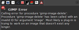

For Gimp-2.10.30 two problems combined:
- changes to Glib (this can be fixed by recompiling dbp),
- outdated code needs updating but the author abandoned the plugin 9 years ago.
Therefore, the older build for Windows has also been removed from gimpscripts.net.

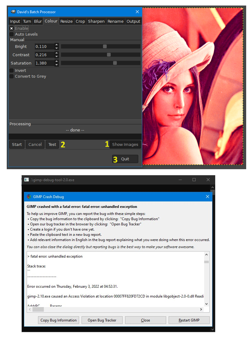

Who will remember that tomorrow? :hehe
Load image, click 1,2,3 and Gimp Crash. :gaah
Who will be "guilty": You? maybe me? or Samj? or maybe Gimp developers? :ninja

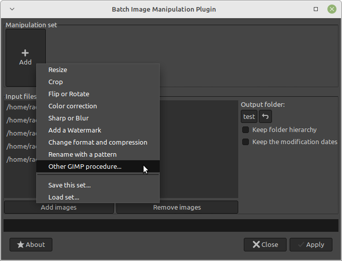

I have a question about the BIMP plugin.
Is there a way to add a GIMP procedure to the manipulation set that doesn't show up in the procedure list?
Thanks.
 Post subject: Re: Problem with David's Batch Processor plugin
PostPosted: Sat Feb 12, 2022 4:49 pm  (#8)

racer-x wrote:
When I do that, that is when the procedure that I want to do does not show up in the procedure list.

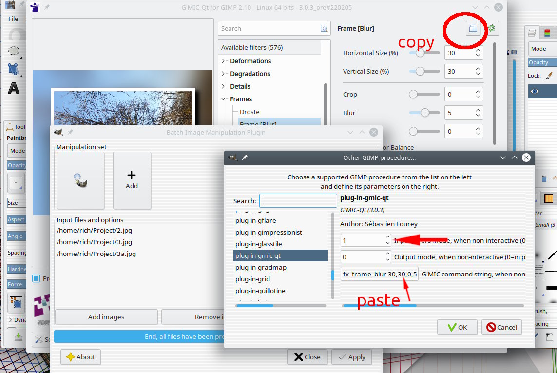

BIMP has a whole list of restricted terms that can stop a script-fu or plugin working. Not everything that registers can be used without a modification/work-around.
However BW-border-ENG-v2.scm see: viewtopic.php?f=8&t=6164&start=20 is not one, it just registers in a strange way.
In BIMP and Other GIMP procedure search for start (that's right start) That gets the dialogue where you can enter the values previously determined. I have tried it in linux Gimp 2.10.22 / BIMP 2.6 looks like this. Seems to work but not very well, Rounded corners not working ?
A better alternative for borders (and lots of color tweaks) is the Gimp gmic plugin http://www.gmic.eu. You determine the effect, copy the parameters to clipboard and paste straight into BIMP. All-in-one screenshot, once you have the gmic parameter, you can close gmic.

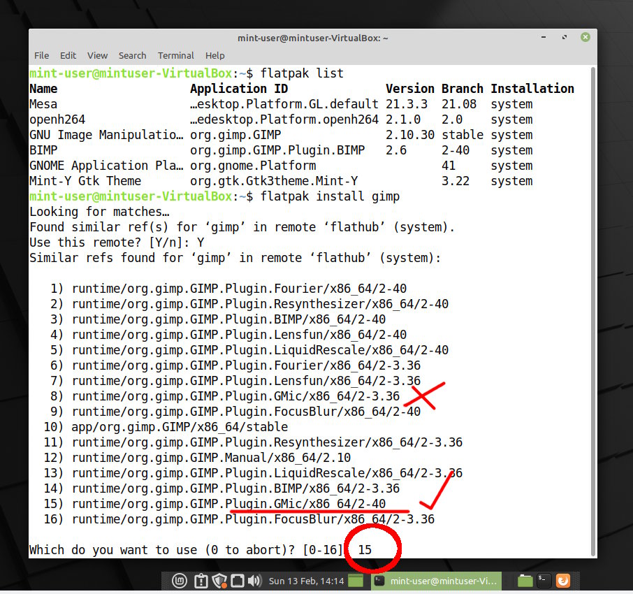

You mentioned GMIC. I used to love GMIC but I haven't been able to get that to work for me for some time. Any suggestions on that? I am using Gimp 2.10.28 flatpak on Linux Mint 20.2.
You should probably update to Gimp 2.10.30 however for a flatpak
Open a terminal and 1) flatpak list to see what is installed.
Then, 2) flatpak install gimp which should give a listing of what is available
You should be using the 2-40 gmic (I think) type in the relevant number and follow the instructions.

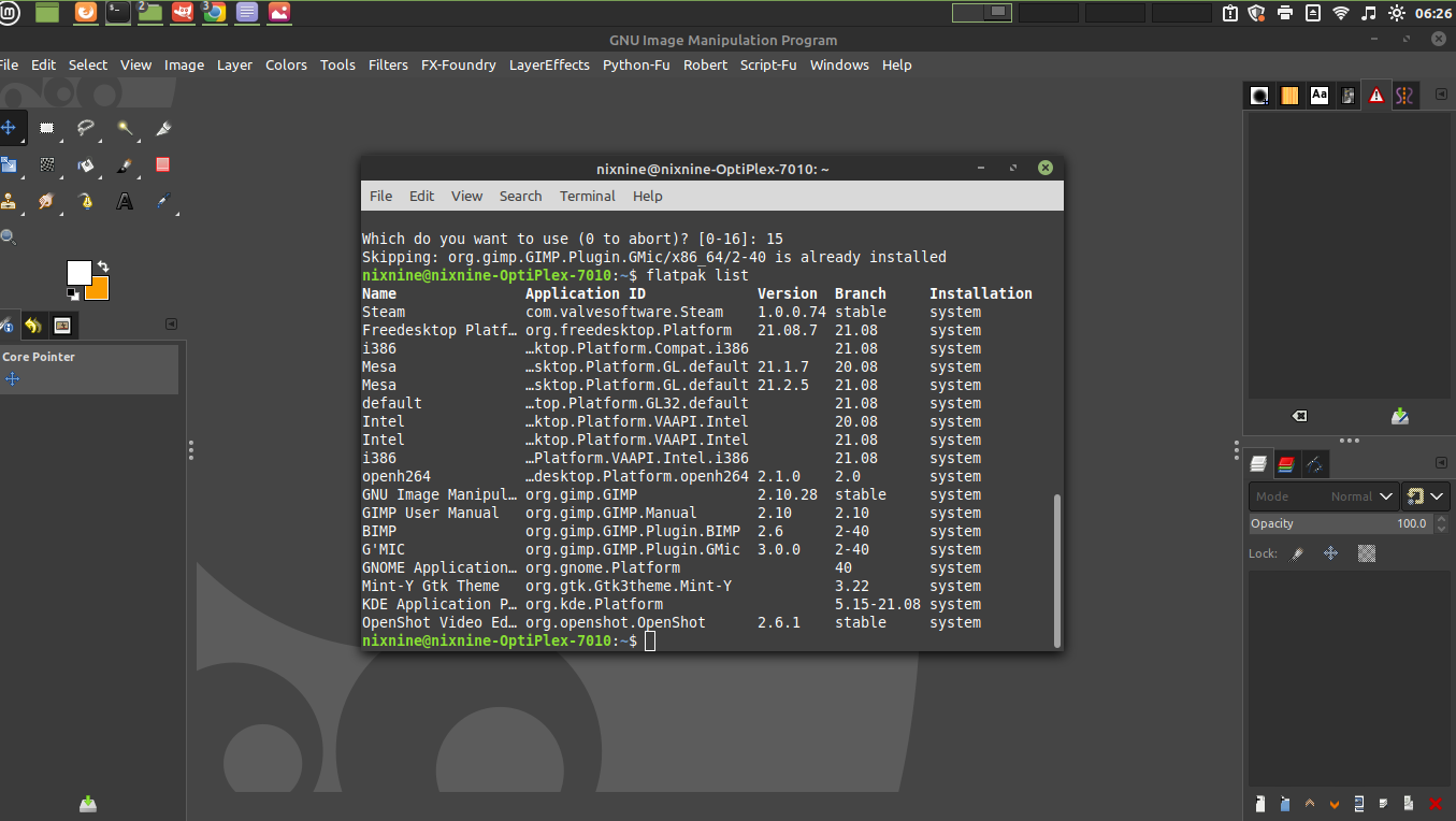

open a terminal and type
flatpak list
It'll produce a list of what is installed which you can post here, so we can help further
Regards
nelo
PostPosted: Mon Feb 14, 2022 7:27 am  (#20)
Joined: Oct 07, 2010
Posts: 439
Here are the results:
