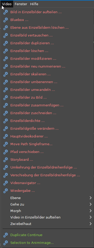

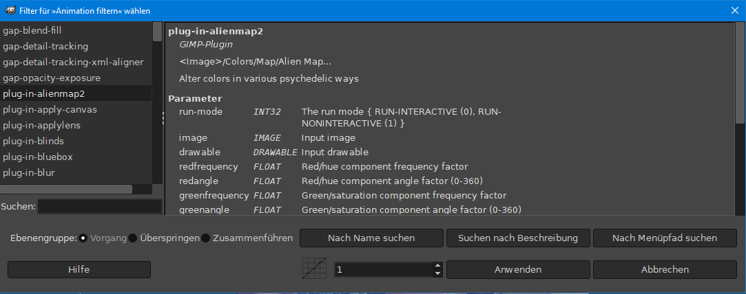

Where do the .mo files go on a windows system?
Regards
nelo
 Post subject: Re: gimp-gap v2.7.0 for windows 32Bits(unstable developers version)
PostPosted: Sat Aug 20, 2022 8:04 am  (#17)
Hi Nelo.
Unfortunately, only where the source files were located during the compilation.
In my Gimp_Gap_64bit build it will be::
c:\msys64\mingw64\share\locale\de\LC_MESSAGES\gimp20-gap.mo
As for the JamesH compilation (32 or 64Bit), I don't know.
The German version of gimp20-gap.mo contains a lot of errors (spaces, dots, no translations) and probably never fulfilled its purpose.
Without delving into the correctness of the translation, I only fixed the errors and it works (if you want to use it, it is in the attachment).
