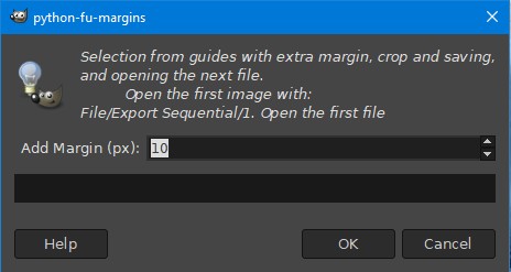

My suggestion is to use two script-fu (required to run - are added in appendix and updated for Gimp-2.10):
1. Export Sequential_processing.scm by Rob Antonishen viewtopic.php?f=9&t=4846&start=0&hilit=Sequential_processing
2. Guides-to-selection-mk2.scm by SteveMi viewtopic.php?f=9&t=14565&hilit=guides+to+selection&start=20#p201330
As many as 8 lines of code came out of it. :hehe
Test it on a small batch copy and let me know if it is right for You.
Test Margins.zip [4.67 KiB]
Downloaded 86 times
