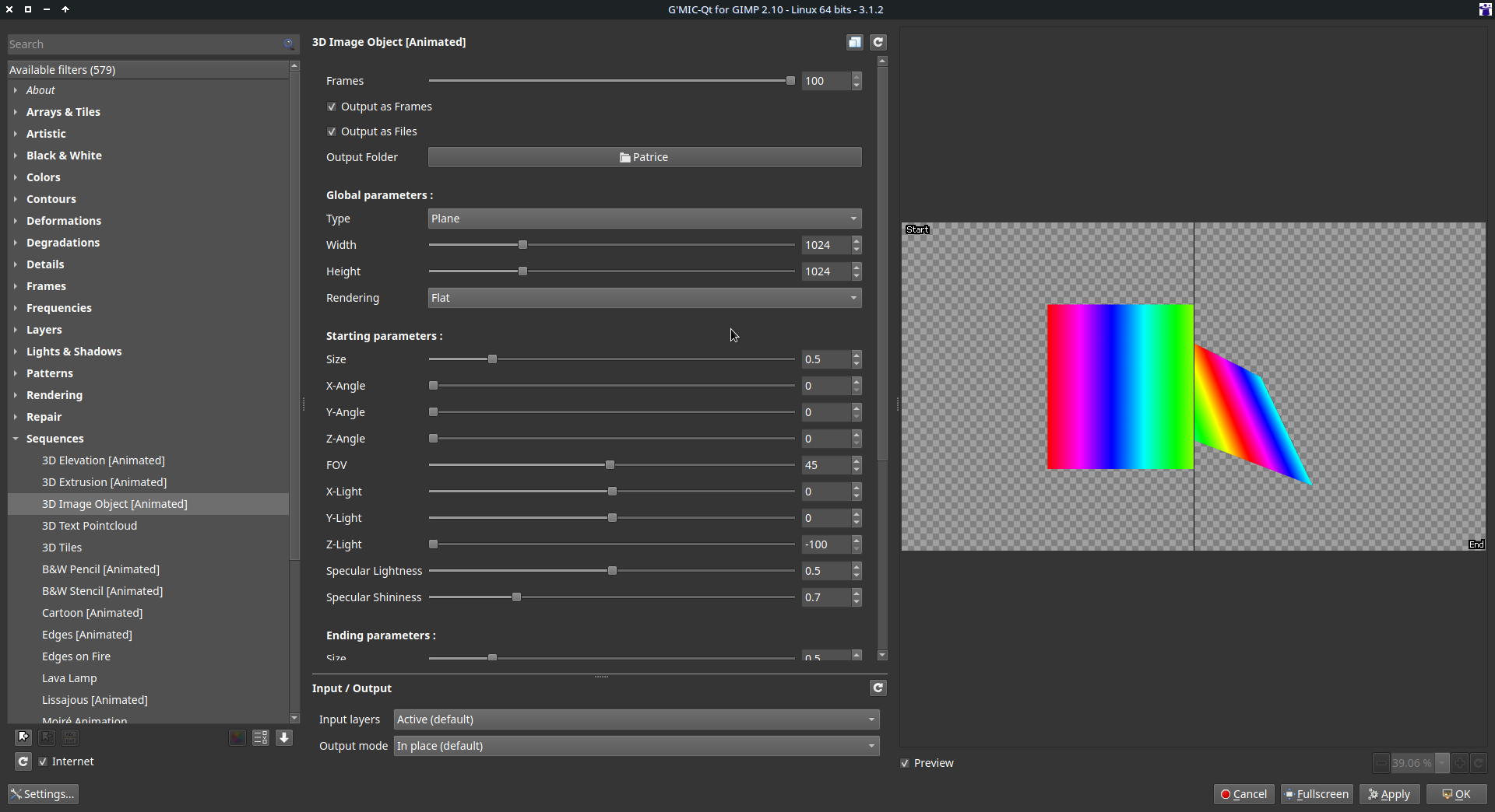

Learning Python is nice, but if you wish to do your animation now, G'MIC can do it in less than 5 minutes
in GIMP menu "Filters >> G'MIC" a window opens, go to "Sequences >> 3D Image Object [Animated]"
You will see that the maximum number of frame is 100, but once you rendered, select your last layer and re-do G'MIC for the remaining 80 frames
Above you can see some basic parameters, you can even chose a folder where to put each frame if you "tick" the "output as files"
below some "Starting and Ending parameters" (all in between will be frames) at the bottom you can chose your output if you click on "Output Mode" (for this exercise I did just let everything as default)
