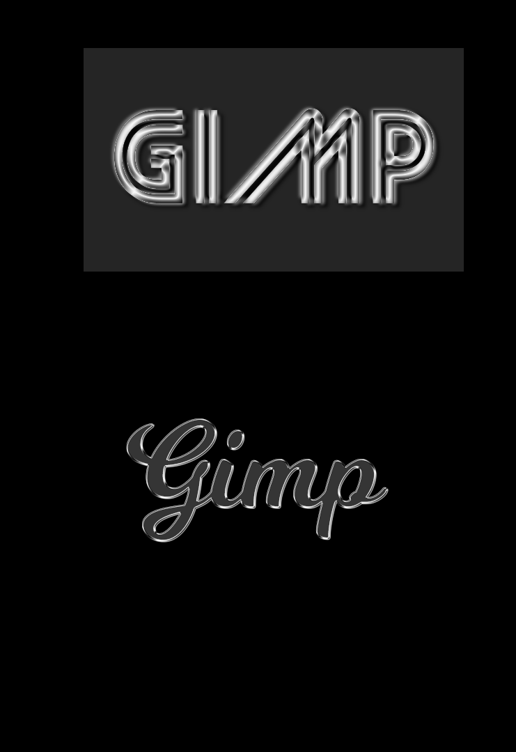

There is nothing wrong in my side GIMP 2.10.32:

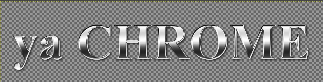

I don't get a good result with Chrome, no a nice chrome look.
I find the only great chrome look I like is this and I thank the auhor for this one.

Is this one. I thank the author again as I love that look.
yaChrome299.zip [3.7 KiB]
Downloaded 121 times

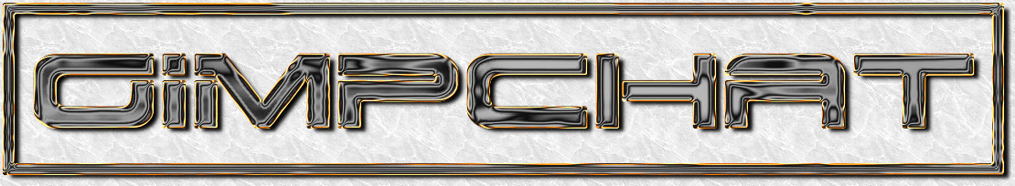

These two also give a nice result!
2428_mhchrome.scm [5.91 KiB]
Downloaded 171 times
chrome-logo.scm [4.87 KiB]
Downloaded 164 times
