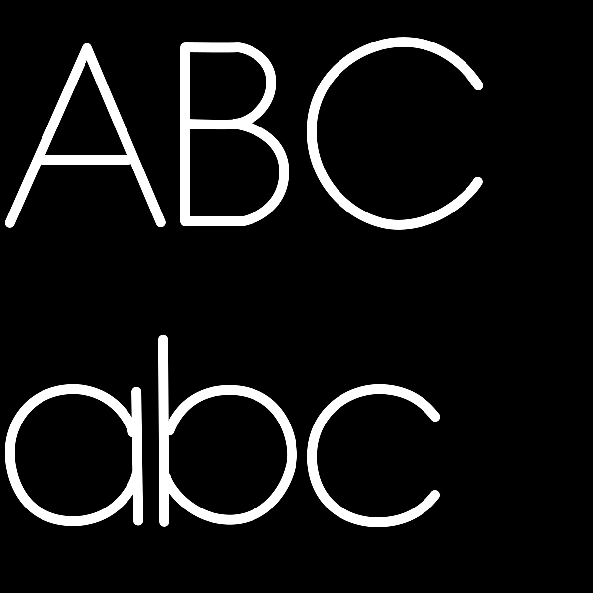

Use the filter setting the 'Stroke path with' option to line and a 'Primary stroke size' of 20. Press 'Ok'.
This creates a set of characters in a thinner style which can be used with other custom font filters.

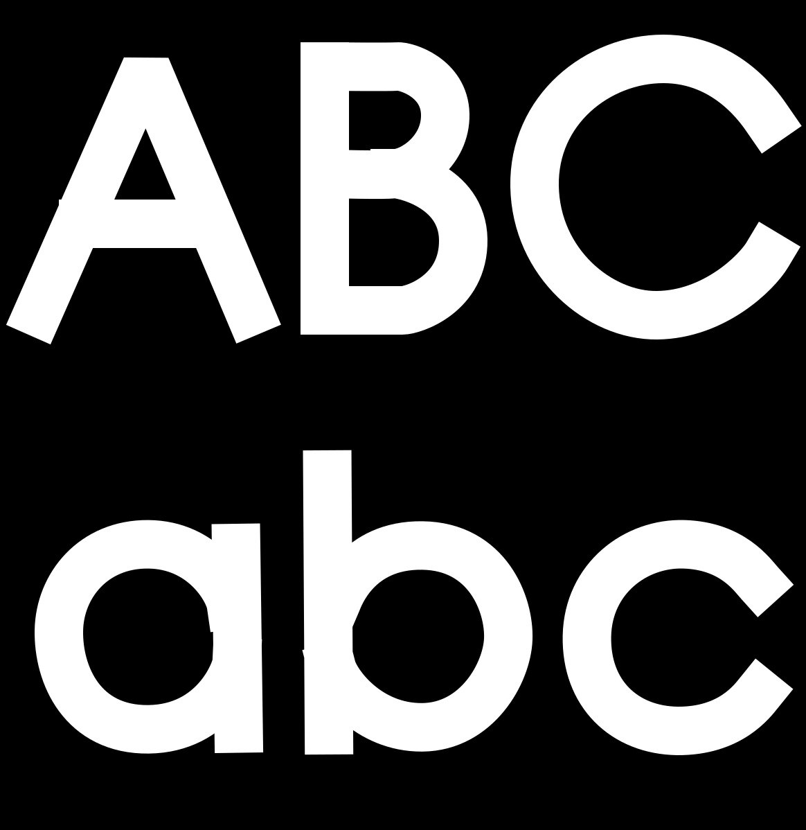

To produce characters in a heavier weighting use a larger stroke size; here I used a value of 90:

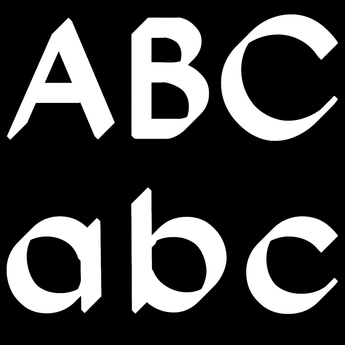

You can use an italic shaped brush to create an italic whitebase version of a custom font: The spacing will need to be set really low (at one or two) to produce a smooth set of characters.
To try this out open the test custom paths file in Gimp and choose an italic brush from the brush dock.
Open the filter:
Set the 'Stroke path with' option to 'brush' and change the 'Brush spacing' value on Tab 2 to 1.

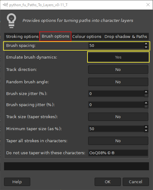

Tab 2 Brush Options:
The Brush spacing option used to live on the first tab and the ‘Emulate brush dynamics’ option has a new default option of ‘Yes’.

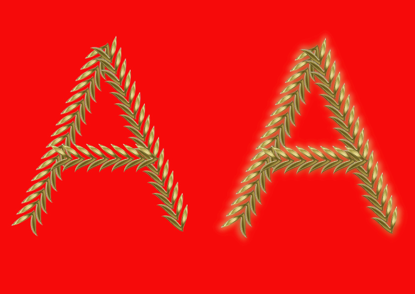

This option can also produce some interesting results with abstract/shaped brushes. Gold is a current theme!

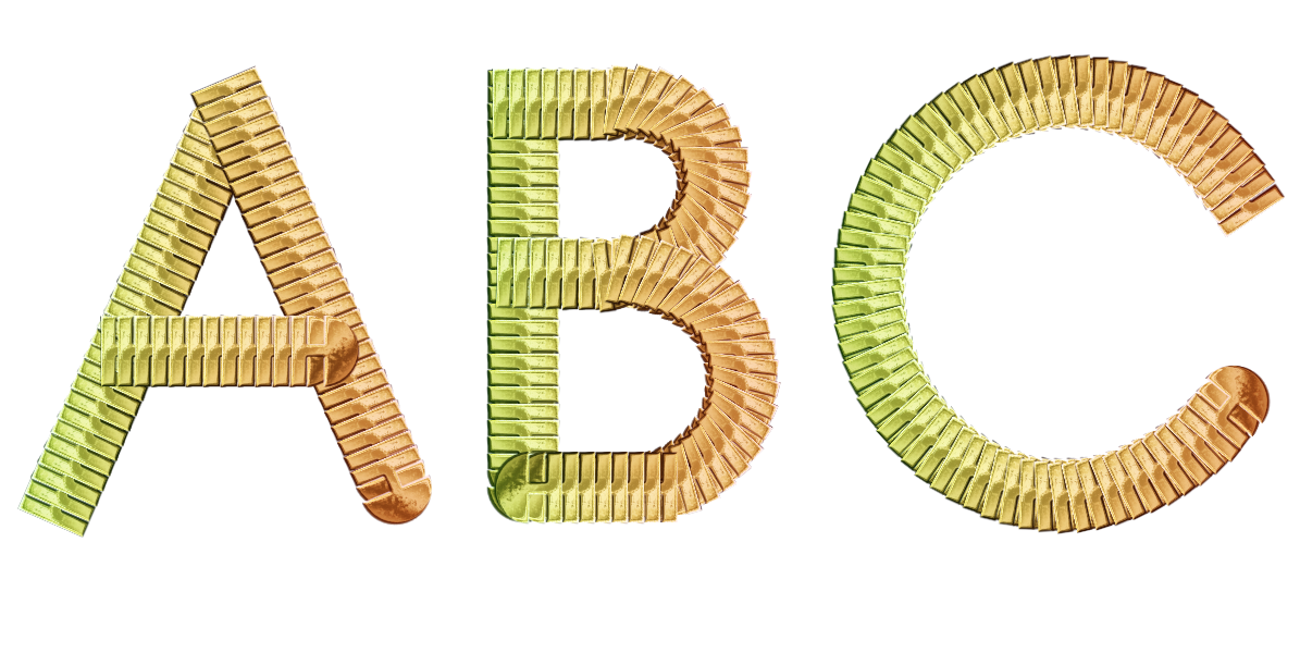

'Apply colour' also allows you to apply a coloured gradient (linear) to existing characters: E-W used here with a Green-Red FG to BG RGB gradient. Choose a gradient from the gradients dock in Gimp.

You can create a glow effect if you use zero for the x and y offsets with a suitable colour:
