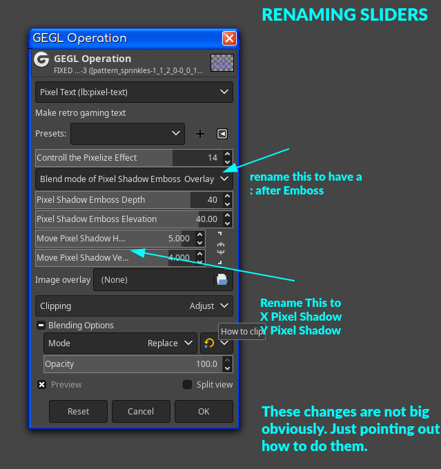

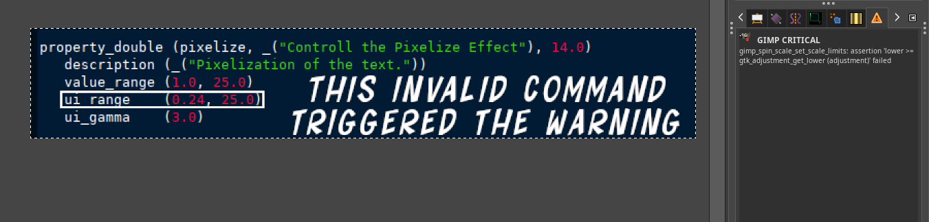

The GUI options are coming about
These are four sliders so far, Pixelize, Blend Mode Choice, Depth and Elevation.
property_double (pixelize, _("Pixelize Meter"), 14.0)
   description (_("Pixelization of the text."))
   value_range (1.0, 25.0)
   ui_range    (0.24, 25.0)
   ui_gamma    (3.0)
enum_start (emboss_blend_pixel)
   enum_value (BLEND_MODE_TYPE_OVERLAY,    "overlay",    N_("Overlay"))
   enum_value (BLEND_MODE_TYPE_MULTIPLY,  "multiply",  N_("Multiply"))
enum_end (embossblendpixel)
property_enum (switchblendmode, _("Blend mode of Emboss"),
               embossblendpixel, emboss_blend_pixel,
               BLEND_MODE_TYPE_OVERLAY)
  description (_("Select a scale algorithm. No Halo works best on scaling down images less then half and LoHalo works best on scaling down images more then half."))
property_double (depth, _("Emboss Depth"), 40.0)
   description (_("Emboss Depth for the emboss effecting the text."))
   value_range (10.0, 60.0)
   ui_range    (10.0, 60.0)
   ui_gamma    (3.0)
property_double (elevation, _("Emboss Elevation"), 40.0)
   description (_("Emboss Elevation for the emboss effecting the text."))
   ui_gamma    (3.0)
All sliders but "switchblendmode/embossblendpixel" correspond to this section of the .c file
gegl:pixelize's size-x and size-y parameter are combined into one slider meaning this one slider controls both x and y together in synch. X and Y of gegl:pixelize will not be separate sliders in this filter.
gegl_operation_meta_redirect (operation, "pixelize", state->pixel, "size-x");
gegl_operation_meta_redirect (operation, "pixelize", state->pixel, "size-y");
gegl_operation_meta_redirect (operation, "depth", state->emboss, "depth");
gegl_operation_meta_redirect (operation, "elevation", state->emboss, "elevation");

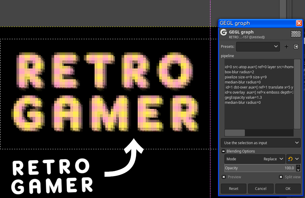

Test this filter without installing by pasting this syntax into Gimp's GEGL graph. This filter works best with an image file upload
id=0 src-atop aux=[ ref=0 layer src=/home/USERNAME/Pictures/Magic/pattern_fills/pattern_plaid-pattern-2_1_3_0-0_0_1__ff8ab3_00e1ff.png   ]
pixelize size-x=14 size-y=14
median-blur radius=0
id=1 dst-over aux=[ ref=1 translate x=5 y=4 levels out-high=0.2 saturation scale=1
id=x multiply aux=[ ref=x emboss depth=40 elevation=10] ]
gegl:opacity value=2

Its missing some of its GUI sliders that I planned., but the blend mode switcher, pixelize slider and emboss features work.
This filter is NOT yet complete.
New properties were added for GUI sliders
property_double (x, _("Move Pixel Shadow Horizontal"), 5.0)
    description (_("Horizontal Movability of the Pixel Text's tail end"))
    ui_range (-6.0, 6.0)
    ui_meta ("unit", "pixel-distance")
    ui_meta ("axis", "x")
property_double (y, _("Move Pixel Shadow Vertical"), 4.0)
    description (_("Vertical Movability of the Pixel Text's tail end"))
    ui_meta ("axis", "y")
property_file_path(image, _("Image overlay"), "")
    description (_("Optional image file overlay to be put over the text text. Source image file path (png, jpg, raw, svg, bmp, tif, ...)"))
gegl_operation_meta_redirect (operation, "x", state->offset, "x");
gegl_operation_meta_redirect (operation, "y", state->offset, "y");
gegl_operation_meta_redirect (operation, "image", state->layer, "src");

 Post subject: Re: GEGL Pixel Text (In Development)
PostPosted: Wed Dec 06, 2023 5:35 pm  (#6)
Joined: Oct 31, 2020
Posts: 2025
When running Pixel Text in Gimp we get this warning. I have seen this many times in development. It means that a slider is beyond its parameters.
In example, gegl:emboss depth=100 is the max parameter of gegl:emboss and gegl:emboss depth=1 is the lowest. The range is 0-100. Anything higher or lower will be an invalid parameter and trigger this error. Lets look through the source code to find the cause of the error.
...After a few minutes of me looking at the code...
Pixelize cannot be below 1 or any decimal number because it is an integer only property.
Here is the warning trigger
Decimals are numbers with points, in example (0.5,1.5,2.5,3.5,4.5) and integers are whole numbers (1,2,3,4 or two billion and twenty eight) if it has a point like 100.3, its a decimal.
In good practice we can do this. This does not fix a trigger warning but it is a good practice that I usually don't do.
Now lets restart Gimp, load the plugin, and see if the error is there.

Let's rename sliders in GEGL.
Under is where name changes are happening
Now lets recompile
Now comes the hard part, we have to make two modes for this filter (original color mode, and user defined color mode)
currently this uses whatever original color was in Gimp but we can tell it to use any color by having a gegl:color-overlay node that kicks beginning when the user selects a from a drop down list.

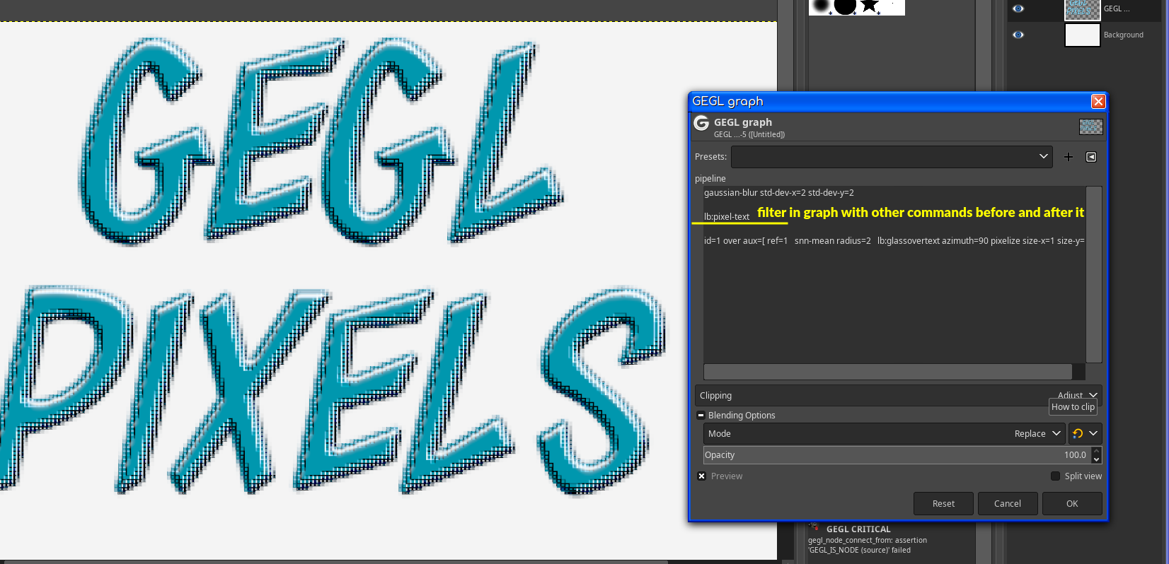

This filter would be released now, but there is a problem of a new discovery.
NEW DISCOVERY MADE several minutes ago
A gaussian blur before anything and my "glass over text plugin + gegl:pixelize" after ward creates bettereffect.

static void
update_graph (GeglOperation *operation)
  GeglProperties *o = GEGL_PROPERTIES (operation);
  State *state = o->user_data;
  if (!state) return;
/* This is where the stateless blendmodechange gets swapped for multiply or overlay.
"switchblendmode will be its property name in the GUI" */
  GeglNode *blendmodechange = state->multiply; /* the default node is multiply  */
  switch (o->switchblendmode) {
    case BLEND_MODE_TYPE_OVERLAY: blendmodechange = state->overlay; break;
    case BLEND_MODE_TYPE_MULTIPLY: blendmodechange = state->multiply; break;
default: blendmodechange = state->overlay;
/* This is where the stateless colorsetting gets swapped for default color mode or any color mode.*/
  GeglNode *colorsetting = state->nopcolor;
  switch (o->colorpolicy) {
    case NOP_COLOR: colorsetting = state->nopcolor; break;
    case COLOR_ANY: colorsetting = state->color; break;
default: colorsetting = state->nopcolor;
/* This is the GEGL Graph itself and nodes do have to be in the correct order.
"blendmodechange" lacks a state-> because it will be either or blend mode we want (overlay or multiply)*/
  gegl_node_link_many (state->input, colorsetting, state->alphalock, state->pixel, state->fix, state->idref1, state->behind, state->idref2, blendmodechange, state->opacity, state->fix2, state->output, NULL);
  gegl_node_link_many (state->idref2, state->emboss,  NULL);
/*idref2 also know as gegl:nop connects to emboss because it is the last node in the second link_many. It is sending a image of the graph's current state to be embossed. That is why it is seen
before and after "blend mode change"*/
  gegl_node_connect_from (blendmodechange, "aux", state->emboss, "output");
/*blendmodechange the only node without a state-> is connecting to emboss so it can be a blend mode switcher of either "gegl:overlay or gegl:multiply"*/
/*The lock alpha channel blend mode (gegl:src-atop) is connecting to gegl:layer src=imagepathhere.jpg for an image file upload ability*/
  gegl_node_connect_from (state->alphalock, "aux", state->layer, "output");
/*Idref1 (The first gegl:nop) exist to make a duplicate of pixelize's effect and put it behind the original image and then tweak it with levels and saturation to darken it.
It connects to levels because that is the last node.*/
  gegl_node_link_many (state->idref1,  state->offset, state->saturation, state->levels,  NULL);
  gegl_node_connect_from (state->behind, "aux", state->levels, "output");
static void
gegl_op_class_init (GeglOpClass *klass)
  GeglOperationClass *operation_class;
GeglOperationMetaClass *operation_meta_class = GEGL_OPERATION_META_CLASS (klass);
  operation_class = GEGL_OPERATION_CLASS (klass);
  operation_class->attach = attach;
  operation_meta_class->update = update_graph;
  gegl_operation_class_set_keys (operation_class,
/* This is where the operation name, title name, description, menu path and menu label go.*/
    "name",        "lb:pixel-text",
    "title",       _("Pixel Text"),
    "reference-hash", "action52avgnmeme",
    "description", _("Make retro gaming text"),
    "gimp:menu-path", "<Image>/Filters/Text Styling/",
    "gimp:menu-label", _("Pixel Text..."),
    NULL);
#endif

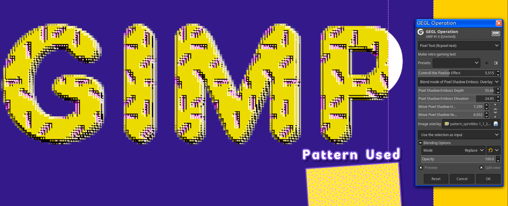

 Post subject: Re: GEGL Pixel Text - plugin download
PostPosted: Fri Dec 15, 2023 6:50 pm  (#9)
Posts: 2025
Pixel text binary downloads on Github have been released. I did not yet add the glass over text or gaussian blur at the start of the graph
https://github.com/LinuxBeaver/Gimp-Pix ... imp_plugin
Everything listed above is documentation of how this plugin was made.
