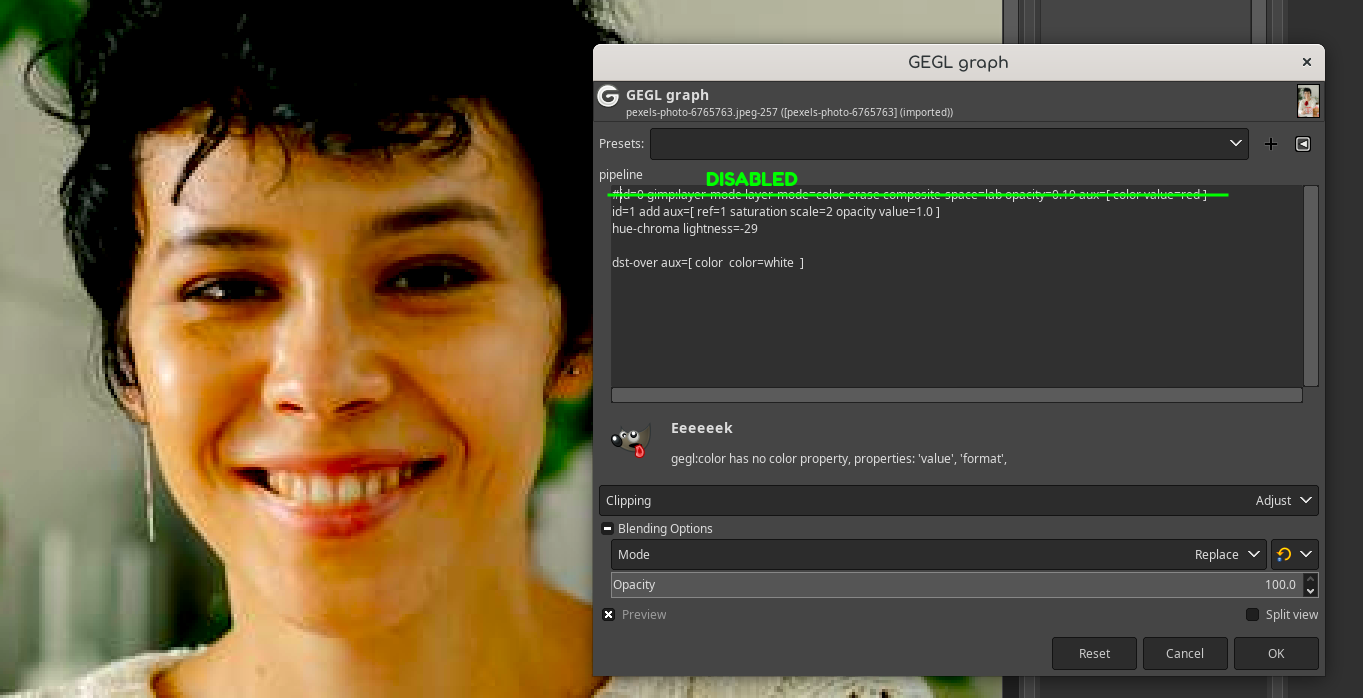

Test this filter without installing by pasting this GEGL Syntax inside Gimp's GEGL Graph filter
id=1 add aux=[ ref=1 saturation scale=2 opacity value=1.0 ]
hue-chroma lightness=-29
end of syntax

I just wrote a bunch of GEGL syntax that dulls the color red from saturation but preserves everything else. It is sloppy because it depends on the original image file and not id and ref.
 Post subject: Re: GEGL Vibrance - fancy saturation plugin (coming soon)
PostPosted: Fri Feb 02, 2024 4:02 pm  (#7)
Joined: Oct 31, 2020
Posts: 2025
I found a simple way to keep green and blue saturation but decrease red saturation using only a few lines of GEGL syntax.
The saturation is kept on green in the image but the red is reduced.
If I disable this line the red comes back
