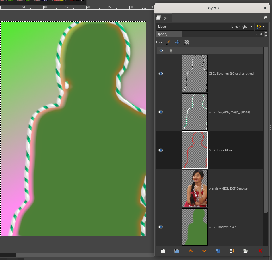

The importance of this thread is paramount. Look how my GEGL plugins are applying on individual layers in Gimp
while fusing with blend modes

The same thing can even be done in CMYK Student's build all in one layer by using the default blend modes switcher that all GEGL filters have. Though for some reason Gimp 2.99 crashes when a filter users a uploaded image file.
The image of the Brenda (the asian lady) can have its background layer unchecked, saved as an xcf, and it can be pasted or imported into any other composition like a smart object in Photoshop/Pixelitor.

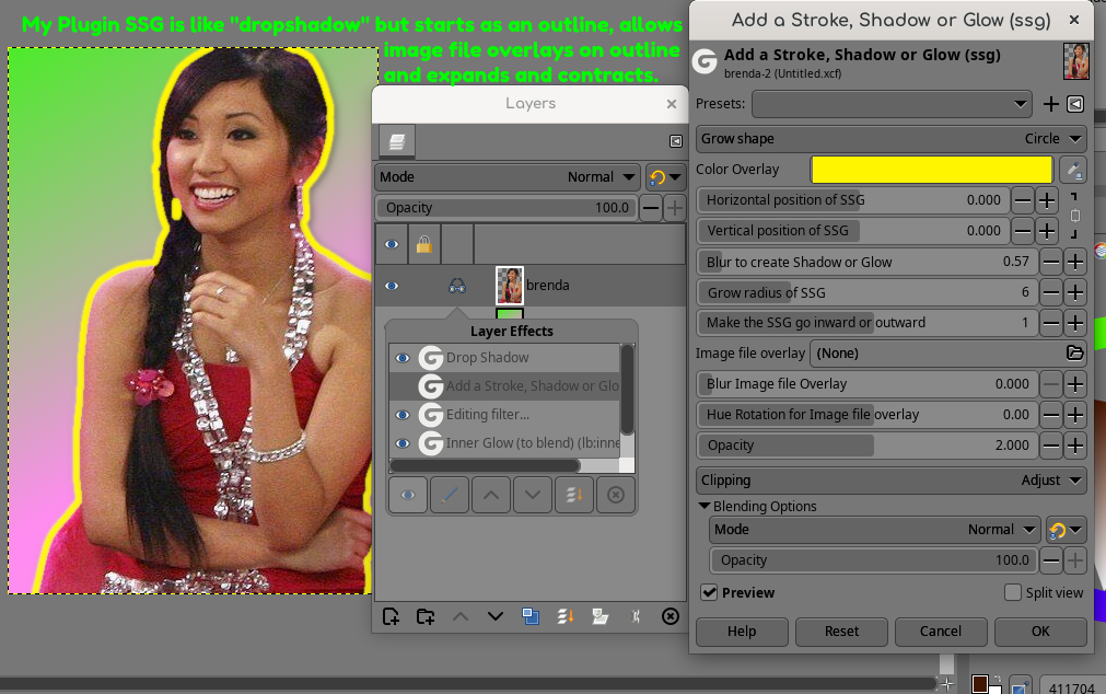

Apply the effect on a duplicate layer of the transparent image and change its blend mode (using Gimp layers). If chrome text broke it is likely because a binary here is dated that broke it. You can fix it by updating to the latest chrome text on Github

Make a duplicate of a transparent image then apply the effect on the duplicate layer.

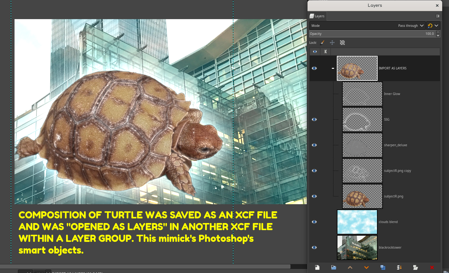

Lastly, you can save the transparent turtle composition with blend modes as an .xcf and "open as layers" in another composition inside a layer group set to pass through and it will mimic a "smart object" in Photoshop.

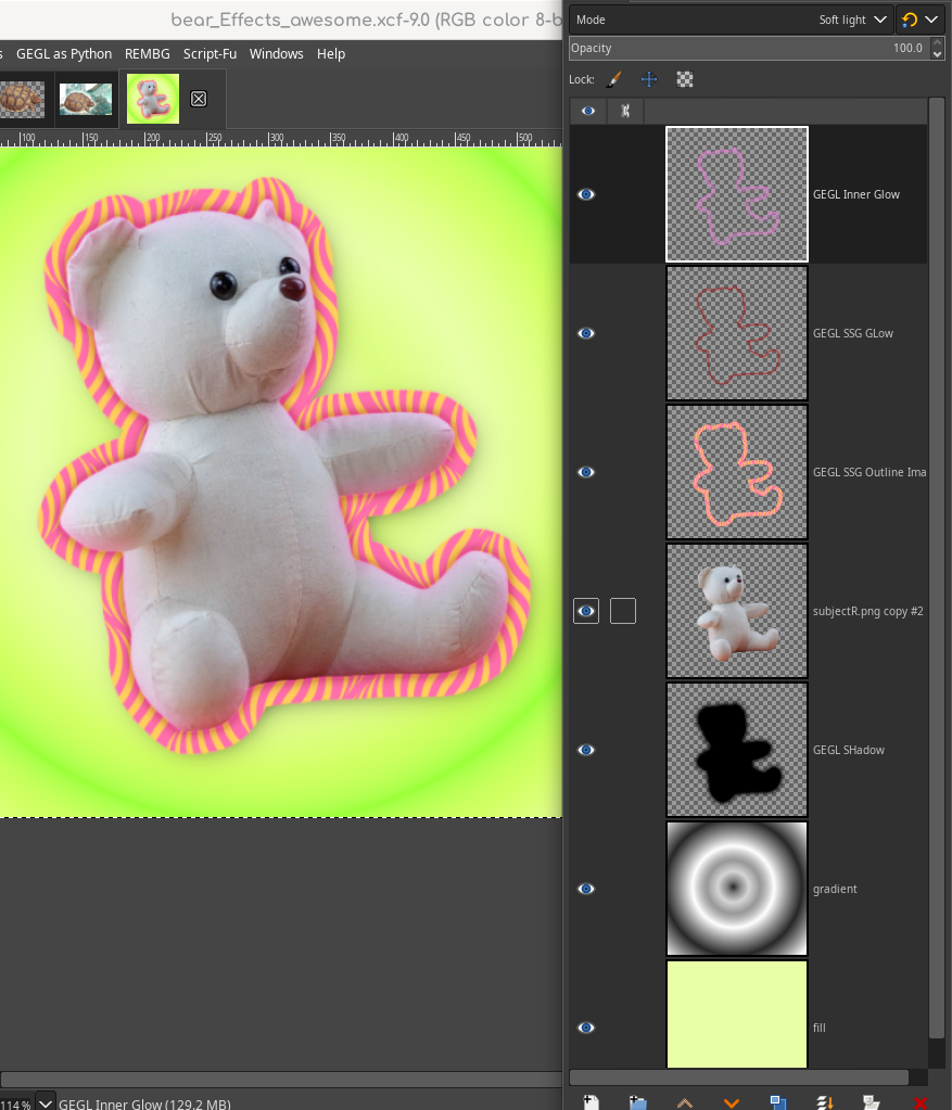

Look what I am doing to a duplicate layer of the bear. I'm making the "outline layer" that goes above the original image of the bear.
The original image of the bear is "Subject R copy #2" everything else is effects and fill and gradient blends applied above and below it.
If this was CMYK Student's build (its not) we could go back and edit the effects individually, but at least we can change the color using Gimp's alpha channel lock (then dragging a new color) and the "GEGL SHadow" layer can be manipulated with Gimp's move tool to change the position of the shadow. I did that intentionally while making the plugin.
