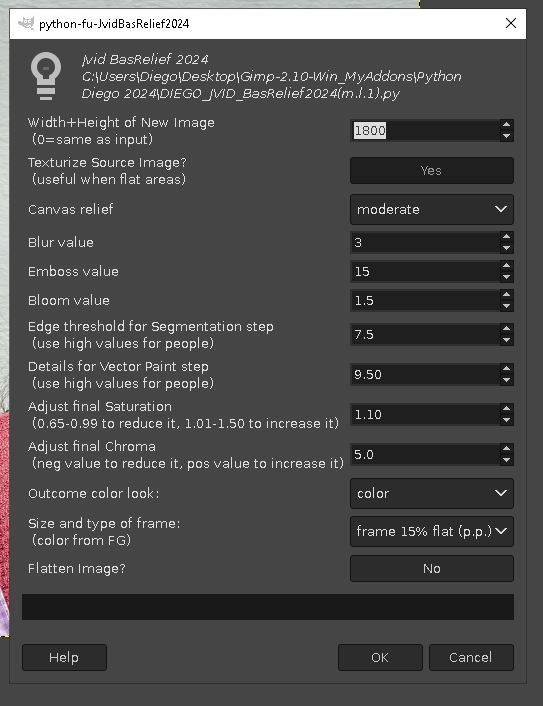

 Post subject: Re: My filters of the year 2024: 3) Bas Relief 1.1.mod.level1
PostPosted: Tue Feb 06, 2024 10:52 am  (#3)
The launching panel 1.1.1
The two new options are:
(PF_ADJUSTMENT, "embosval", "Emboss value", 15, (5, 25, 1)),
value for embossing, it was fixed at 10 in 1.1.0
(PF_ADJUSTMENT, "bloomval", "Bloom value", 1.5, (0.0, 10.0, 0.1)),
new parameter (add some blurred lighting)

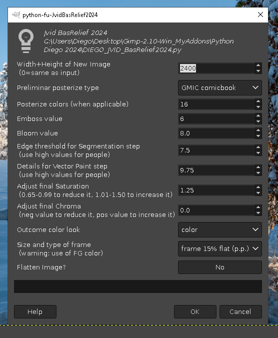

 Post subject: Re: My filters of the year 2024: 3) Bas Relief 1.2.0 <
PostPosted: Mon Feb 12, 2024 3:05 am  (#4)
Release 1.2.0
download it here
DIEGO_JVID_BasRelief2024.7z [6.73 KiB]
Downloaded 85 times
Launching panel
new option: Preliminary POSTERIZE step with many choices possible
