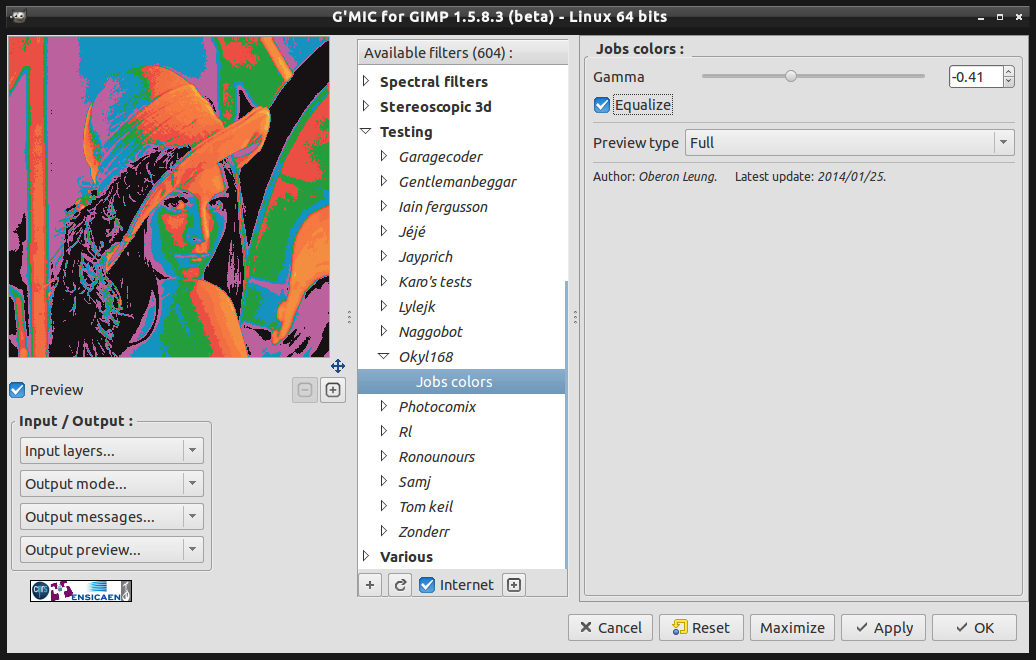

I've transcribed your python script into a G'MIC filter, you can already access it bu updating your filters.
I've put this filter in Testing / Okyl168 /
For information, here is what I wrote for doing this (13 lines in total) :
#@gimp Jobs colors : gimp_jobs_colors, gimp_jobs_colors_preview
#@gimp : Gamma = float(0,-2,2)
#@gimp : Equalize = bool(0)
#@gimp : sep = separator(), Preview type = choice("Full","Forward horizontal","Forward vertical","Backward horizontal","Backward vertical","Duplicate horizontal","Duplicate vertical")
#@gimp : sep = separator(), note = note("<small>Author: <i>Oberon Leung</i>.      Latest update: <i>2014/01/25</i>.</small>")
gimp_jobs_colors :
  -n 0,255 -if $2 -equalize 256 -endif
  -luminance -apply_gamma {10^$1} -n 0,9 -round
  (22,187,20,36,235,240,245,243,247,209^18,97,147,157,79,110,121,142,170,200^19,158,192,60,67,65,64,64,64,185)
  -map[^-1] [-1] -rm[-1]
gimp_jobs_colors_preview :
  -gimp_split_preview "-gimp_jobs_colors $*",$-1
Let me know if this is what intended.

Ronounours, Great! How do I download your version? I am new here, I tried the latest beta 1.5.8.3 from sourceforge, but doesn't have the entry under Testing. Oh I found it by pressing the refresh button. LOL
Ronounours wrote:
Hi.
I've transcribed your python script into a G'MIC filter, you can already access it by updating your filters.

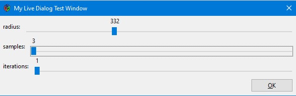

While I was looking for a way to do live-preview, this topic came up.
And I wanted to try out my own (of course it has to gtk) which is kind'a ok I guess (wish there was a way to do with PF_variables but doesn't look like you can connect to PF_variables.
So this example is gtk (I have always been afraid of poking around in gtk) but this time I used help from ChatGPT and I tried to comment as much as I can so if I read it later I'll know what needs changing/fiddling.
At first I was going to try calling gegl c2g but the python_fu wrapper to gegl c2g is too slow to call using this preview so I just changed it to ellipse select and invert just to show me that this works on the fly. (see demo video below).

def dialog(image_, drawable_):
    global image, drawable
    #save these for updates
    image = image_
    pdb.gimp_image_undo_disable(image) #for speed and also when user undo it doesn't see our preview creations/deletions
    drawable = drawable_
    dialog = gtk.Dialog("My Live Dialog Test Window", None, gtk.DIALOG_MODAL | gtk.DIALOG_DESTROY_WITH_PARENT)
    dialog.set_default_size(600, 100)
    # Create an HBox to hold the label and slider -------------------------------------------------------------
    hbox = gtk.HBox()
    dialog.vbox.pack_start(hbox, expand=True, fill=True)
    # Create a label on the left-hand side
    label1 = gtk.Label("radius:")
    hbox.pack_start(label1, expand=False, fill=False, padding=5)
    # Create an adjustment for the HScale (slider) with a range from 10 to 90
    adjustment1 = gtk.Adjustment(value=50, lower=2, upper=1000, step_incr=1, page_incr=0)
    param1_scale = gtk.HScale(adjustment=adjustment1)
    param1_scale.set_digits(0)  # Display only integers
    hbox.pack_start(param1_scale, expand=True, fill=True, padding=5)
    # Connect callback functions for user interaction
    param1_scale.connect("value-changed", on_param1_changed)
    hbox2 = gtk.HBox()
    dialog.vbox.pack_start(hbox2, expand=True, fill=True)
    label2 = gtk.Label("samples:")
    hbox2.pack_start(label2, expand=False, fill=False, padding=5)
    adjustment2 = gtk.Adjustment(value=4, lower=3, upper=17, step_incr=1, page_incr=0)
    param2_scale = gtk.HScale(adjustment=adjustment2)
    param2_scale.set_digits(0)  # Display only integers
    hbox2.pack_start(param2_scale, expand=True, fill=True, padding=5)
    param2_scale.connect("value-changed", on_param2_changed)
    hbox3 = gtk.HBox()
    dialog.vbox.pack_start(hbox3, expand=True, fill=True)
    label3 = gtk.Label("iterations:")
    hbox3.pack_start(label3, expand=False, fill=False, padding=5)
    adjustment3 = gtk.Adjustment(value=10, lower=1, upper=30, step_incr=1, page_incr=0)
    param3_scale = gtk.HScale(adjustment=adjustment3)
    param3_scale.set_digits(0)  # Display only integers
    hbox3.pack_start(param3_scale, expand=True, fill=True, padding=5)
    param3_scale.connect("value-changed", on_param3_changed)
    # Add an OK button
    ok_button = dialog.add_button(gtk.STOCK_OK, gtk.RESPONSE_OK)
    ok_button.connect("clicked", on_ok_button_clicked)
    # Show the dialog
    dialog.show_all()
    dialog.run()

 Post subject: Re: How to write python plugin preview?
PostPosted: Tue Nov 07, 2023 3:15 pm  (#14)
For me it's a total revolution (although it seems that the samples & iteration parameters are not active)

    update_live_preview()
# Callback function for updating the live preview when param2 changes
def on_param2_changed(scale):
    global global_param2
    global_param2 = scale.get_value()
def on_param3_changed(scale):
    global global_param3
    global_param3 = scale.get_value()
# Callback function for the OK button
def on_ok_button_clicked(button, data=None):
    global drawable
    apply_final(preview_layer) #preview layer because we don't want to apply the invert to final layer it's just for viewing
    button.get_toplevel().destroy() #destroys the gtk dialog window
# Register the Python-Fu plugin
register(
    "python_fu_grow_shrink_live",
    "Grow/Shrink Current Selection with Live Preview",
    "TT",
    "TT",
    "NAME",
    "<Image>/Python-Fu/Live Preview/Grow-Shrink Live",  # Menu location
    "*",  # Image type
    dialog
main()
PostPosted: Sun Nov 26, 2023 10:06 am  (#20)
Posts: 4561
here's some coded added to existing previous example
that I pulled out from ChatGPT for a YES/NO button (so toggle)
and a combo choice selection (so options)
I do not fully understand it but I can work with what it gave me.
#!/usr/bin/env python
#grow-shrink-live.py
# Creator: TT
# This should allow user to adjust grow/shrink current selection with live preview
# Open Source
from gimpfu import *
import gtk
# Global variables to store the parameters used for our effect/work to show preview or actual layer when user OK it
global_param1 = 0 #in this example it's shrinkgrow radius
global_param2 = 0   #in this example it's feather_radius
global_param3 = 10  #in this example it's iterations
global_param4 = 0   #in this example it's enhance_shadows
chosen_color = 0
sample_integer = 13
image = 0 #we'll set these when dialog() is called so that we can access them later
drawable = 0
has_preview = False
preview_layer = 0
#for this operation
selection_channel = 0
proceed_with_changes = False
def apply_effect(layer): #function to do work on either preview layer or actual drawable when user clicks OK
    global image
    radius = global_param1
    feather_radius = global_param2
    pdb.gimp_image_select_item(image,CHANNEL_OP_REPLACE,selection_channel) #first we selected the original saved channel
    if radius < 0:
        pdb.gimp_selection_shrink(image,-radius)
    else:
        pdb.gimp_selection_grow(image,radius)
    pdb.gimp_selection_feather(image,feather_radius)
    #do something to it to show it's effect so that user can distinguish between selected area or not
    pdb.gimp_drawable_edit_fill(layer,FILL_FOREGROUND)
    #pdb.gimp_ellipse_select(image,image.width/2-width/2,image.height/2-height/2,width,height,CHANNEL_OP_REPLACE,TRUE,FALSE,0)
    #pdb.gimp_drawable_invert(layer,TRUE)
    #pdb.gimp_selection_none(image)
    gimp.displays_flush()
def apply_final(layer): #wrapper to apply effect on final and remove preview_layer meant to be called by on_ok_button_clicked
    global preview_layer
    #pdb.gimp_image_undo_group_start(image) #so it's undone in Ctrl+Z
    pdb.gimp_image_undo_enable(image) #so that user can undo this next step
    apply_effect(preview_layer)
    #pdb.gimp_image_undo_group_end(image)
    if has_preview:
        pdb.gimp_image_remove_channel(image,selection_channel) #so that we don't leave a saved channel laying around
        pdb.gimp_image_remove_layer(image,preview_layer)
    pdb.gimp_image_set_active_layer(image,drawable)
    pdb.gimp_context_set_foreground(save_foreground)
# Function to update the live preview
def update_live_preview(): #this is called everytime some parameter changes
    global global_param1, global_param2, global_param3, global_param4
    global image,drawable
    global has_preview,preview_layer #deal with preview layer
    global selection_channel #this will save our current selection
    # Apply your plugin's effect using the current parameters
    # Use global_param1 and global_param2 to access the user's inputs
    if not has_preview: #create a preview layer
        #pdb.gimp_message("Creating preview")
        preview_layer = pdb.gimp_layer_new(image,image.width,image.height,RGBA_IMAGE,"preview",70,LAYER_MODE_NORMAL)
        pdb.gimp_image_insert_layer(image,preview_layer,None,0) #insert top most so we see it
        non_empty,x1,y1,x2,y2 = pdb.gimp_selection_bounds(image)
        if non_empty == TRUE:
            pass #there's already a selection
        else:
            pdb.gimp_selection_all(image) #if there's no selection we just select the whole image and work with that
        selection_channel = pdb.gimp_selection_save(image)
        has_preview = True #now set it true so we can deal with existing layer in later calls
    else: # already have preview layer
        pass
        #pdb.gimp_message("Removing existing and creating new Preview")
        pdb.gimp_image_remove_layer(image,preview_layer) #remove it to create a new one to work on
        preview_layer = pdb.gimp_layer_new(image,image.width,image.height,RGBA_IMAGE,"preview",50,LAYER_MODE_NORMAL)
    pdb.gimp_image_set_active_layer(image,preview_layer)
    #debug message
    #pdb.gimp_message(str(global_param1)+","+str(global_param2)+","+str(global_param3)+","+str(global_param4))
    # Update the live preview layer with the modified image
save_foreground = 0
hilightcolor = (255,0,0)
    global image, drawable, save_foreground
    if chosen_color==0:
        global chosen_color
        chosen_color = (0, 128, 255)  # Set default color
    image = image_
    save_foreground = pdb.gimp_context_get_foreground()
    pdb.gimp_context_set_foreground(hilightcolor)
    dialog = gtk.Dialog("Shrink/Grow Feather Selection Live Preview", None, gtk.DIALOG_MODAL | gtk.DIALOG_DESTROY_WITH_PARENT)
    #color_selection.ok_button.connect("clicked", on_color_ok_button_clicked)
    hbox = gtk.HBox()
    label1 = gtk.Label("Shrink/Grow Radius:")
    adjustment1 = gtk.Adjustment(value=0, lower=-400, upper=400, step_incr=1, page_incr=0)
    # # Create an HBox to hold the label and slider -------------------------------------------------------------
    hbox2 = gtk.HBox()
    label2 = gtk.Label("Feather Radius:")
    adjustment2 = gtk.Adjustment(value=0, lower=0, upper=400, step_incr=1, page_incr=0)
    # Create an HBox to hold the label and integer/float input box =====================================================
    hbox4 = gtk.HBox()
    dialog.vbox.pack_start(hbox4, expand=True, fill=True)
    # Create a label for the integer input
    label4 = gtk.Label("Sample Integer:")
    hbox4.pack_start(label4, expand=False, fill=False, padding=5)
    # Create a text entry for the integer input
    entry4 = gtk.Entry()
    entry4.set_text(str(sample_integer))
    entry4.set_width_chars(5)  # Adjust the width of input box as needed
    entry4.connect("changed", on_sample_integer_changed)
    hbox4.pack_start(entry4, expand=False, fill=False, padding=5)
    # Create an HBox to hold the label and color picker button =================
    hbox5 = gtk.HBox()
    dialog.vbox.pack_start(hbox5, expand=True, fill=True)
    # Create a label for the color picker
    label5 = gtk.Label("Color Picker:")
    hbox5.pack_start(label5, expand=False, fill=False, padding=5)
    # Create a color picker button
    color_button = gtk.ColorButton()
    color_button.set_use_alpha(False)  # Set to True if you want to include alpha channel
    #default_color = gtk.gdk.Color(65535, 0, 0)  # Red in RGB, where values are between 0 and 65535
    pdb.gimp_message("set:" + str(chosen_color[0]))
    color_button.set_color(gtk.gdk.Color(chosen_color[0]*256, chosen_color[1]*256, chosen_color[2]*256))
    color_button.connect("color-set", on_color_changed)
    hbox5.pack_start(color_button, expand=False, fill=False, padding=5)
    #toggle button ==============
    hbox6 = gtk.HBox()
    dialog.vbox.pack_start(hbox6, expand=True, fill=True)
    label6 = gtk.Label("Sample Toggle:")
    hbox6.pack_start(label6, expand=False, fill=False, padding=5)
    toggle_button = gtk.ToggleButton()
    # Set initial label
    update_toggle_button_label(toggle_button)
    # Connect the toggle event
    toggle_button.connect("toggled", on_toggle_button_toggled)
    hbox6.pack_start(toggle_button, expand=False, fill=False, padding=5)
    #Combo box ===================================
    hbox7 = gtk.HBox()
    dialog.vbox.pack_start(hbox7, expand=True, fill=True)
    label7 = gtk.Label("Sample Choice:")
    hbox7.pack_start(label7, expand=False, fill=False, padding=5)
    # Create a ComboBox
    combo_box = gtk.ComboBox()
    hbox7.pack_start(combo_box, expand=False, fill=False, padding=5)
    # Create a ListStore model for ComboBox
    list_store = gtk.ListStore(str)
    options = ["Option 1", "Option 2", "Option 3"]  # Add your options here
    for option in options:
        list_store.append([option])
    # Set the model for ComboBox
    combo_box.set_model(list_store)
    # Create a CellRendererText to render the text in the ComboBox
    cell_renderer = gtk.CellRendererText()
    # Pack the CellRendererText into the ComboBox
    combo_box.pack_start(cell_renderer, True)
    combo_box.add_attribute(cell_renderer, 'text', 0)
    # Set up the "changed" signal handler
    combo_box.connect("changed", on_combobox_changed)
    # Set the default option to "Option 1" ======================================
    default_option = "Option 1"
    default_iter = list_store.get_iter_first()
    while default_iter is not None:
        if list_store.get_value(default_iter, 0) == default_option:
            combo_box.set_active_iter(default_iter)
            break
        default_iter = list_store.iter_next(default_iter)
#     color_selection.show_all()
#     color_selection = gtk.ColorSelectionDialog("Select Color")
#     # Run the dialog
#     response = color_selection.run()
#     # Connect the "clicked" signal after the dialog has been shown
#     color_selection.ok_button.connect("clicked", on_color_ok_button_clicked)
# # Check the response and destroy the dialog
#     if response == gtk.RESPONSE_OK:
#         on_color_ok_button_clicked(color_selection)
#     else:
#         color_selection.destroy()
    # hbox3 = gtk.HBox()
    # dialog.vbox.pack_start(hbox3, expand=True, fill=True)
    # # Create a label on the left-hand side
    # label3 = gtk.Label("iterations:")
    # hbox3.pack_start(label3, expand=False, fill=False, padding=5)
    # # Create an adjustment for the HScale (slider) with a range from 10 to 90
    # adjustment3 = gtk.Adjustment(value=10, lower=1, upper=30, step_incr=1, page_incr=0)
    # param3_scale = gtk.HScale(adjustment=adjustment3)
    # param3_scale.set_digits(0)  # Display only integers
    # hbox3.pack_start(param3_scale, expand=True, fill=True, padding=5)
    # # Connect callback functions for user interaction
    # param3_scale.connect("value-changed", on_param3_changed)
    # Add an OK button
    # Show the dialog
    dialog.show_all()
    update_live_preview() #call this once so we see effect
    dialog.run()
def on_combobox_changed(combobox):
    global selected_option
    model = combobox.get_model()
    active_iter = combobox.get_active_iter()
    if active_iter:
        selected_option = model.get_value(active_iter, 0)
        pdb.gimp_message("Selected option:" + str(selected_option))
def on_toggle_button_toggled(button):
    global proceed_with_changes
    proceed_with_changes = not proceed_with_changes
    pdb.gimp_message("Sample toggle result:" + str(proceed_with_changes))
    update_toggle_button_label(button)
def update_toggle_button_label(button):
    label = "Yes" if proceed_with_changes else "No"
    button.set_label(label)
def on_sample_integer_changed(entry):
    global sample_integer
    try:
        sample_integer = float(entry.get_text()) #int(entry.get_text())
        pdb.gimp_message(sample_integer)
    except ValueError:
        # Handle the case where the input is not a valid integer
