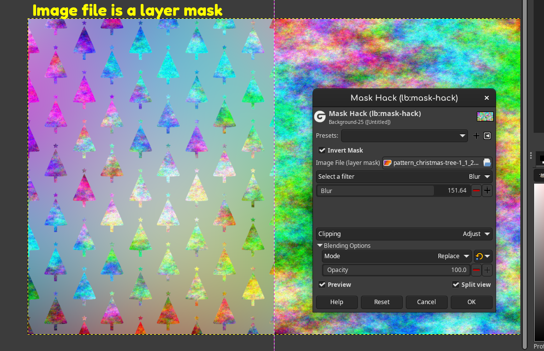

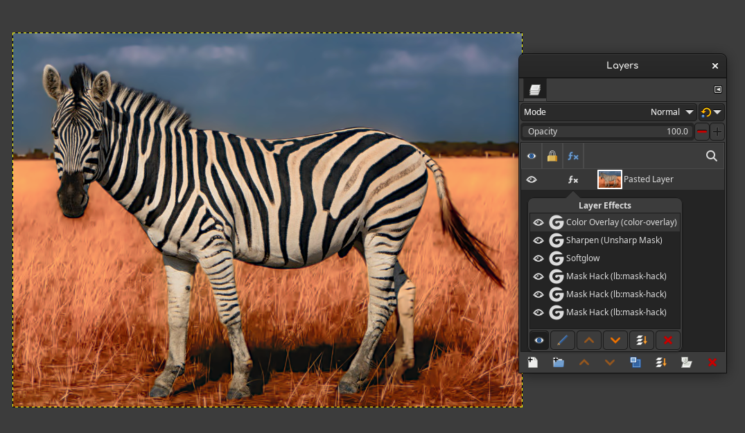

I made a new GEGL plugin that gives layer mask to individual non-destructive GEGL filters. It is going to be released soon.
It allows 3 GEGL ops and four GEGL commands in total. (Gaussian blur, Hue rotation, Lightness and Saturation) to be given a layer mask via a transparent image file upload. Soon there will be more filters to use with layer mask. This is a hack because in the future non-destructive GEGL filters will have layer mask of their own and this will be entirely deprecated. Below is an attached pic showing the Plasma filter in GIMP given a non-destructive layer mask of gaussian blur with an image file upload as the mask parameters.
Non-destructive filters Plamsa and gaussian blur
but Gaussian Blur has a layer mask of its own
Gaussian Blur and all filters here are labelled "hack mask" unfortunately they cannot use their original names.
If you can't wait and want to test this plugin now here is the code to compile it

Preview of update with denoise filter as a mask
It will be on Github soon

Layer Mask filter being used three times for the background only
1. Hue rotation
2. Gaussian Blur blended by a blend mode
3. Denoise dct
Then it is followed by a normal softglow, sharpen and black color overlay at 10% opacity that applies to everything
Before Effects
After Effects
Source code for the latest update that includes Gaussian blur with blend modes (nicked named orton) is here

Mask image file is here
