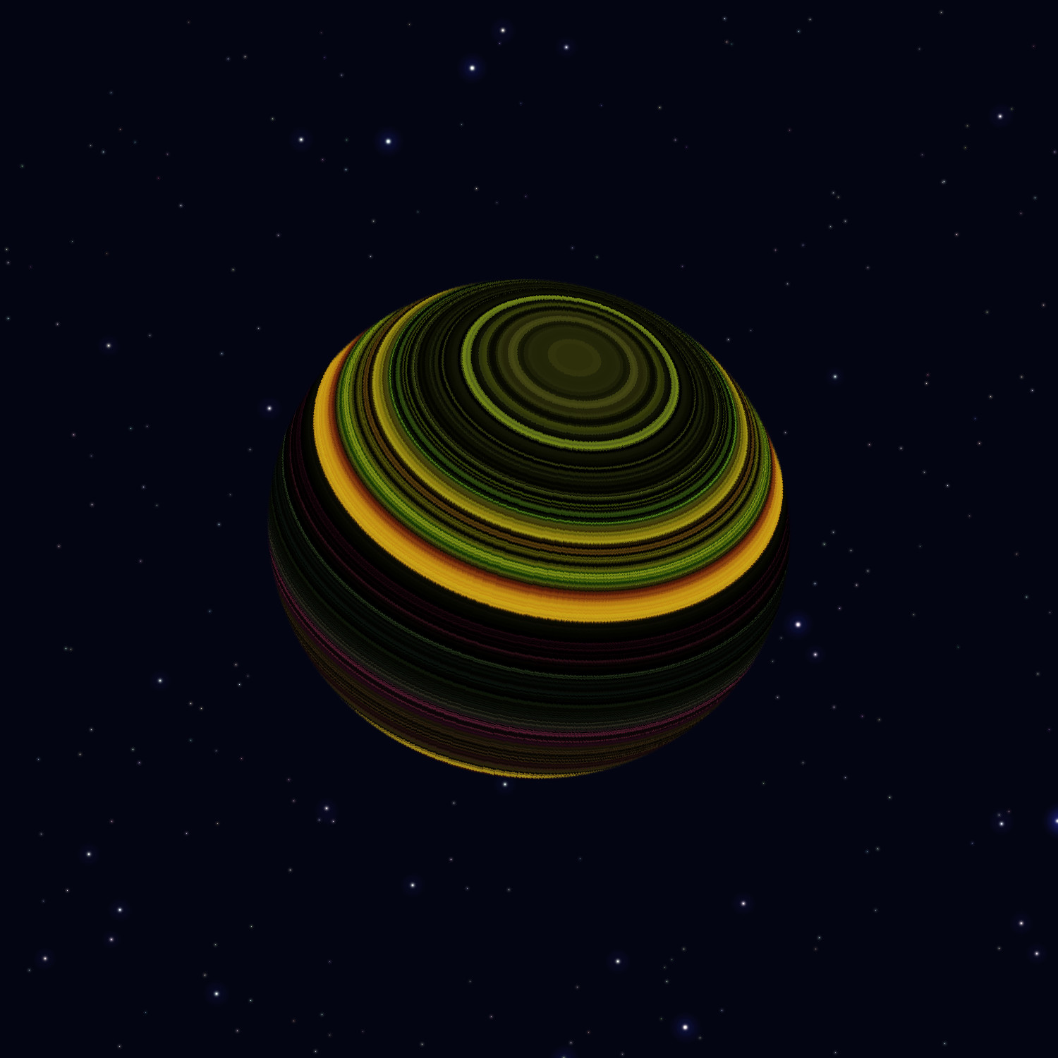

For those who wish to try this script
planet-gas-giant.scm [3.75 KiB]
Downloaded 320 times
it is located at Image>/File/Create/Patterns/Gas giant Planet
The script works on RGB or GRAY images, without an alpha channel
It works by stacking ellipses, the number of ellipses being equal to the number of pixels in the image height
The script utilises a single (the left most) vertical column of pixels in the open image
The 0 to 90 setting of the Polar tilt was intended to be the degree of tilt, but the results don’t quite match up to the intention
A small pixel height image combined with a low Polar tilt will give distorted results. An image 750 pixels high breaks down if the Polar tilt is set to less than 12. Larger image heights allow smaller Polar tilts to be set
It takes up to 20 seconds to run on an image 800 pixels high
I left the last two steps open as an option for the user
Steve
