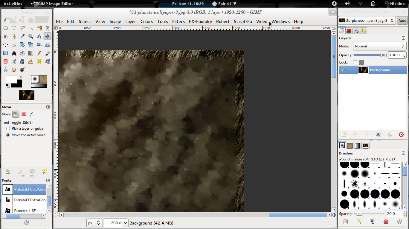

I am using the preset, but the outer edge of the image is without the effect. It is more pronounced the smaller the image. Any ideas on how to correct this?
 Post subject: Re: Filter Effects
PostPosted: Fri Nov 11, 2011 8:45 pm  (#20)
Nixnine: I can't duplicate your problem. What filetype are the images?
