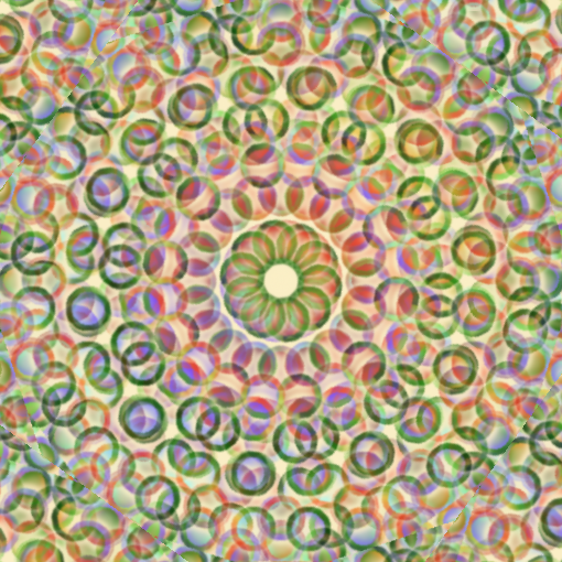

Here is mine :)
File comment: now with small tiles.
File comment: rotoidoscope
File comment: kalidioscope :)

PostPosted: Sat Apr 23, 2011 5:36 pm  (#20)
Joined: Dec 20, 2010
Posts: 174
Location: Wherever the voices in my head tell me I am.
Wow! :kpix
Some really creative results here using the original script and creative adjustments to it by our talented users. Very impressive.
