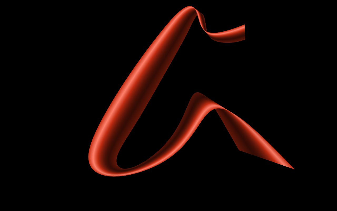

The interesting effects come with transparent or partially transparent gradients. Here is an example with one called (appropriately) "Red Tube (which took a good 5 minutes to run on my machine):

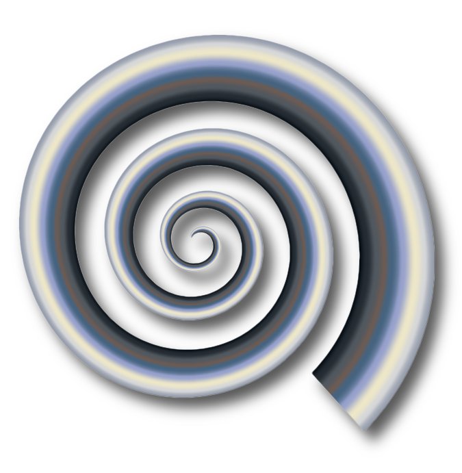

Another quick example using a spiral path imported from inkscape that was rotated and scaled to make the second path... then added a quick drop shadow...

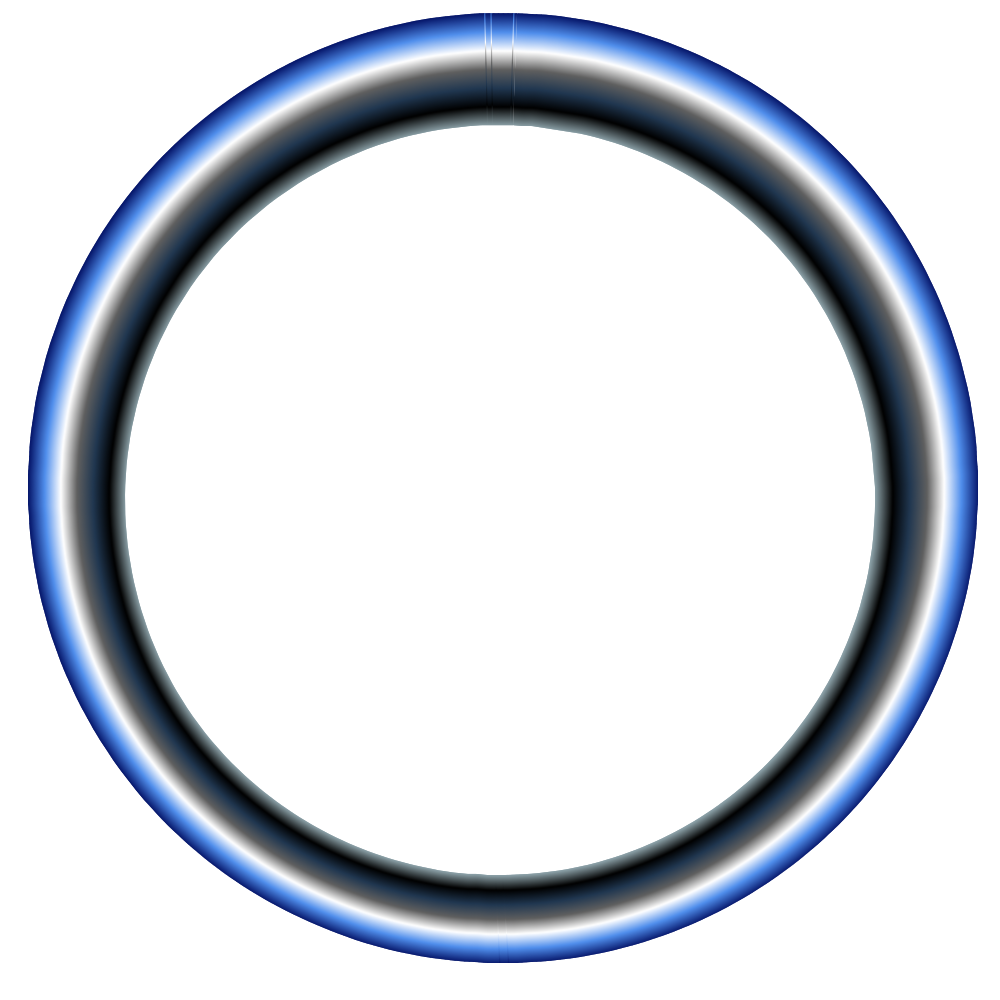

2nd try (not showing first) using your Script-fu Rob. The only issue I see in the scan like lines at only one point in the render; happened with the other render too with a different gradient). Not sure why it is; it might have something to do with GIMP 2.8 rc1 64-bit, but not sure. For this one, it's just one circular selection turned into path and a smaller one doing the same. :)

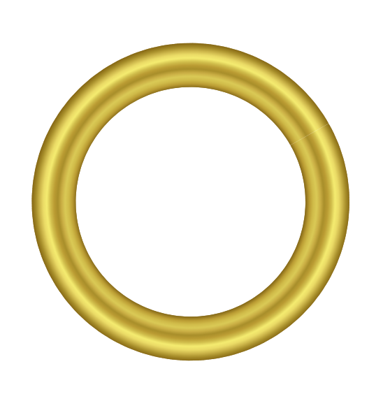

Mainly because turning a circular selection into a path makes a bad circular path ;)
Here is the same thing using two circular paths from inkscape:
There is still a seam at the join however - it is an artifact from making two selection butted up against each other having the same end points. You see the background bleeding through the join. It is reduced if the start/end of the paths are not horizontal or vertical to each other (different gradient, btw):
-Rob A>
 Post subject: Re: Path Blend Script
PostPosted: Sat Apr 14, 2012 8:40 pm  (#14)
Posts: 12830
That's cool Rob; thanks for the explanation; not hard to clean of course, but just curious to know. :)

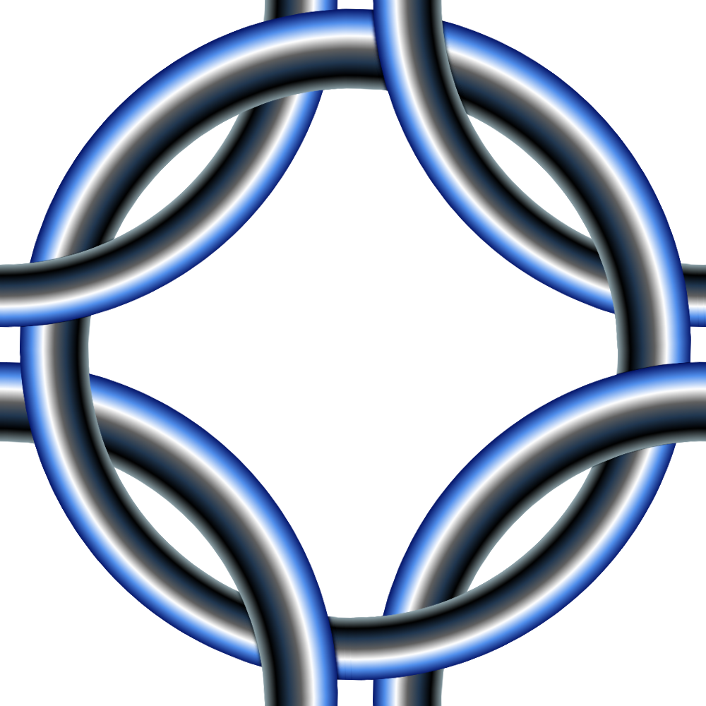

Might as well do something with the ring I made earlier. Erisian might like this one. ;)
Created a seamless interlinked texture and used Droste for the result. :)

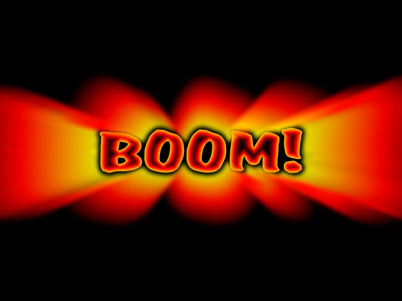

Fun stuff using scaled copies of paths:
