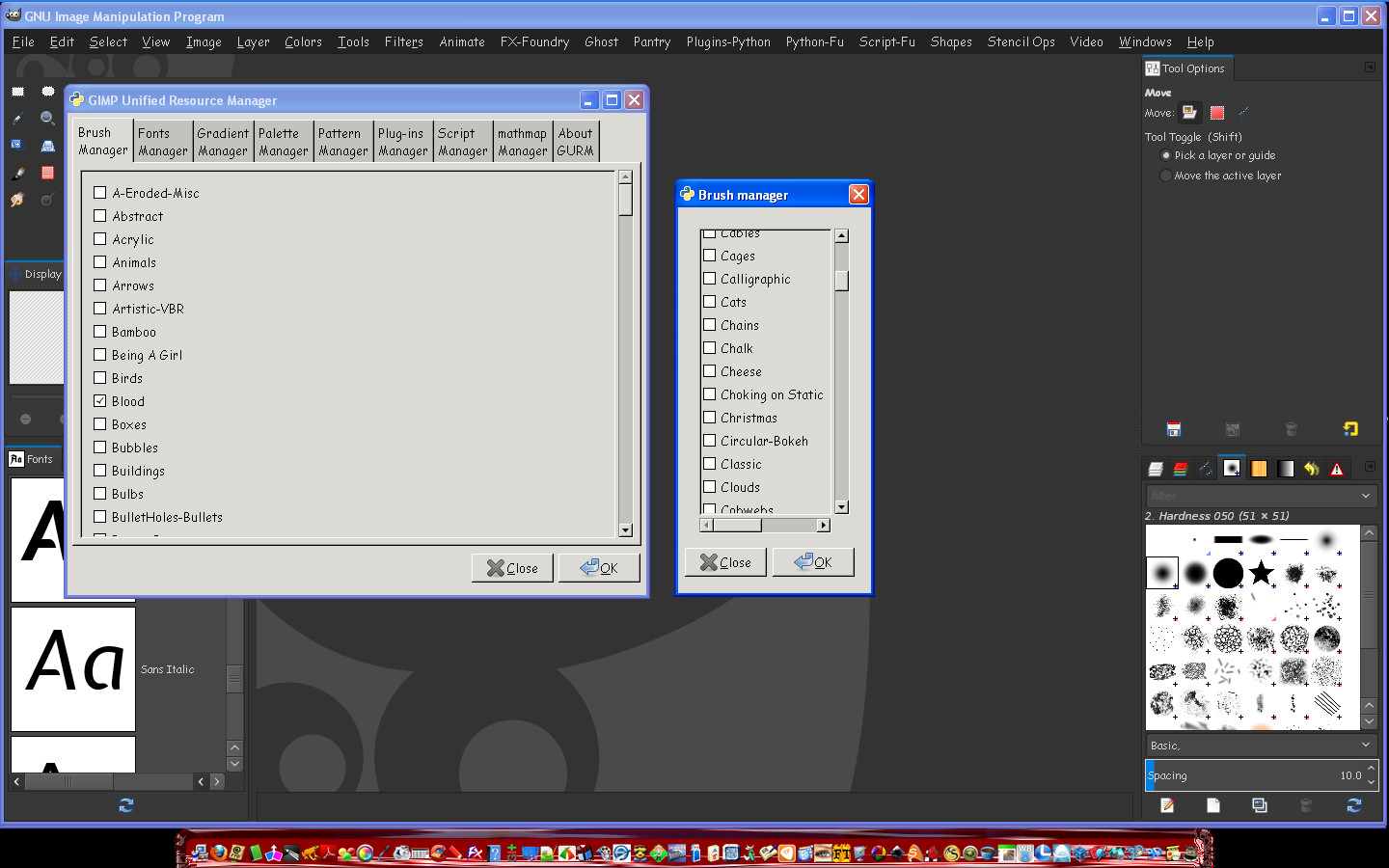

PostPosted: Fri May 25, 2012 11:09 am  (#1)
GURM is very necessary.
http://registry.gimp.org/node/13473#comment-14590
Talk about version 0.8 GURM
http://www.gimpchat.com/viewtopic.php?f=5&t=4357
But I prefer - available from the context menu with auto refresh.
The idea for Brush Manager 2.00 by Sean Bogie
In annex (Basic manager additives.zip)) - to try out - modified managers :
BRUSH
GRADIENTS
FONTS
PALETTES
PATTERNS
All you need - to edit: lines 7 and 8
Basic manager additives.zip [12.04 KiB]
Downloaded 352 times

PostPosted: Fri May 25, 2012 9:57 pm  (#4)
Download Notepad++ 6.1.2
http://notepad-plus-plus.org/download/v6.1.2.html
Open the file in the program and edit lines 7 and 8
Edit:
ACTIVE_DIR=r"C:\Documents and Settings\Marek\.gimp-2.8\brushes" #<<<-----SET ME<<<----- (Directory to hold active sets, select Writable in Preferences)
INSTALL_DIR=r"C:\Documents and Settings\Marek\.gimp-2.8\brushes_alternate"#<<<-----SET ME<<<----- (Directory where you place your sets - in subdirectories)
Type in your path:
ACTIVE_DIR=r"C:\Documents and Settings\Marek\.gimp-2.8 = r"C:\Documents and Settings\~Your Name~\.gimp~Your version~
 Post subject: Re: Old managers additives (with a little modification)
PostPosted: Fri May 25, 2012 10:12 pm  (#5)
The menu item is there in my brush file, but when I select the plugin menu doen't appear.
ACTIVE_DIR=r"F:\Gimp-2.8-32bit-Partha\pref_1\brushes"
INSTALL_DIR=r"F:\Resouces\brushes"
Are my paths correct

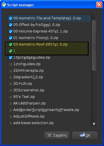

For my master.
You have a choice:
1.The subdirectories
2. Pack (*. zip)
MrQ-Script-Fu_Manager.zip [2.36 KiB]
Downloaded 246 times

PostPosted: Sat May 26, 2012 7:04 pm  (#10)
Do the resources for the script manager have to be in ZIP files.
PostPosted: Sat May 26, 2012 10:06 pm  (#11)
Posts: 16164
This is pretty cool.
I like being able to choose just 2 maybe 3 scripts, and not a whole directory.Can one like scripts be written for brushes and patterns MareroQ?
I would definitely use them then. :)
Also can you just load 1-3 scripts at one time (not zipped) ?

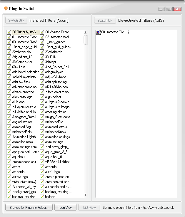

Old topic - more mixing (Cybia)
http://www.gimpchat.com/viewtopic.php?f=8&t=1894
