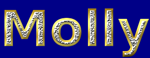

Mine turned out ok too

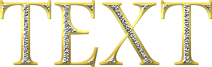

Location: Wisconsin
I just looked at the script. It uses the background color for the diamond inset color, so:
Make sure your background color is set to white!
This is what I got with a medium orange background color.
