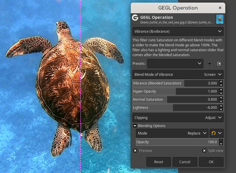

Image of The Vibrance Effect
GEGL Syntax to create vibrance effect

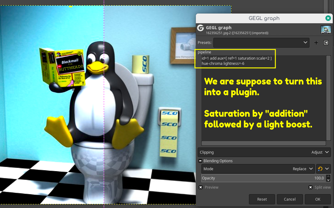

This GEGL plugin exercise is VERY EASY TO DO. I completed the exercise in 4 minutes. This is the first GEGL plugin of 2024 btw.

/* This GEGL node list needs to include three seperate names of your choice So far it only contains "???" as substitutes for the following operations.
"1. gegl saturation" "2. gegl hue chroma" 3. gegl add .
The goal is to give these operations names three unique names of your choice while listing their true GEGL operation name.
"*input" and "*output" which is the default read image from gimp and render image from gimp are already done. */
static void attach (GeglOperation *operation)
GeglNode *gegl = operation->node;
GeglNode *input, *???, *???, *???, *output;
I will make up three names. They can be anyname but I choose
GeglNode *input, *luma, *sat, *addition, *output;[/b]
now that I listed these three names, what goes in each "???" Remember that gegl:??? must contain an operation name like gegl:dropshadow or gegl:bloom but the "???" at the start of gegl_node_new_child can contain ANY NAME that we defined. Lets see if anyone can fill in these blanks. The URLs listed literally provide the answer to the GEGL operation name but not the name for gegl_node_new_child.
/*you can find this filters operation name here https://gegl.org/operations/gegl-hue-chroma*/
??? = gegl_node_new_child (gegl,
"operation", "gegl:???",
NULL);
/*you can find this filters operation name here https://gegl.org/operations/gegl-saturation.html*/
NULL);

I am going to release an actual Vibrance plugin soon that will have a lot more options not available in my tutorial, such as the ability to switch through blend modes and opacity above 100%. The plugin I am making is much more advance then this exercise.
Vibrance in split view mode on the turtle
Selection mask on the dress only applying Vibrance
Once the plugin is done it will have its own thread on GimpChat.
