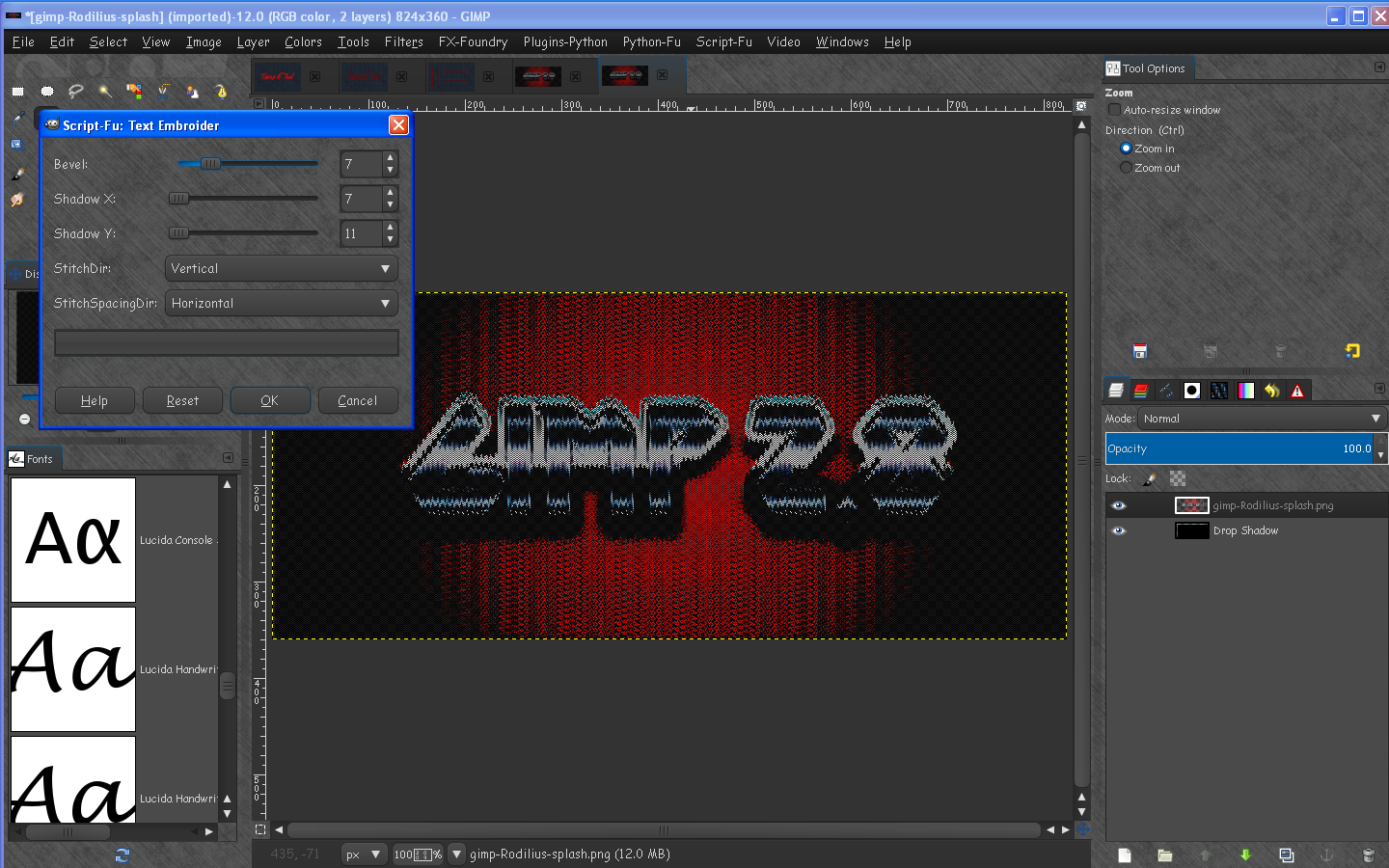

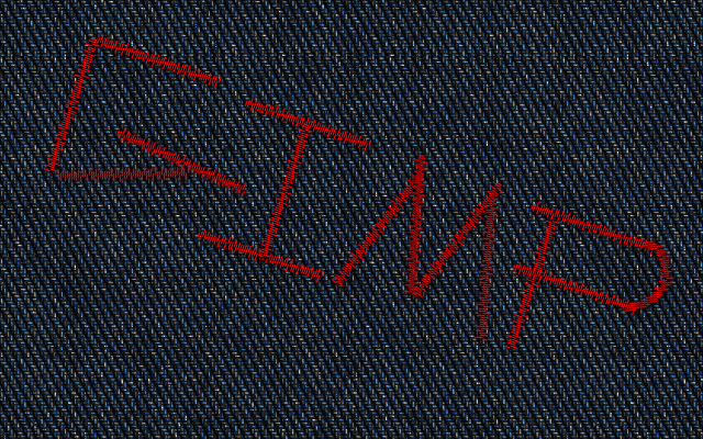

Here are the results on a red text layer.
Values are set to 7, 7, 11, and both Horizontal directions.
If you run the script on a straight line you get this.(both directions set to vertical

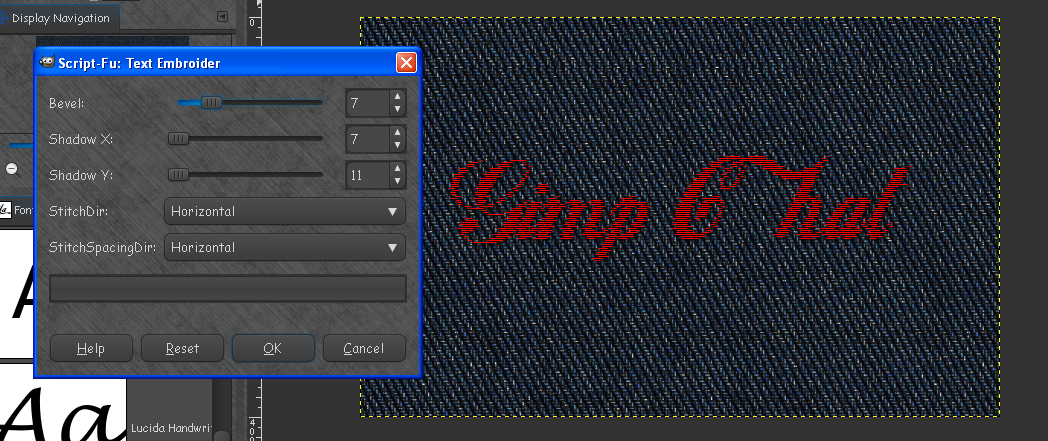

Both directions set to Horizontal

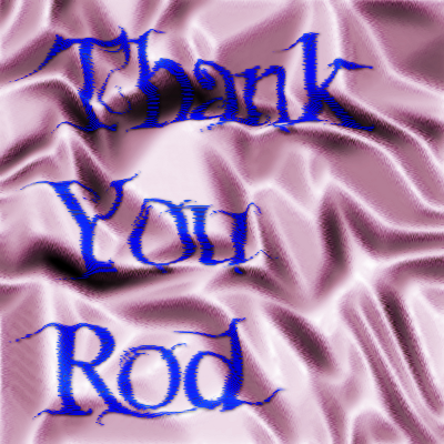

Thanks Rod, thats better. I will experiment more later after I get my chores done. lol
I will pick a better backgroud etc.

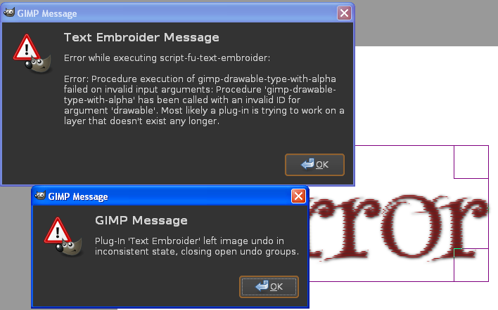

Hey Rod, nice work with the scripts but I'm having problems with this one. After running it a couple of times I get this:
The first time it happened I restarted Gimp and made sure I was selecting the right layer. It worked fine a couple of times then errored out again. It creates the shadow and stitching layer but not the drop shadow. Also, is there anyway you could add a way to control the spacing between the stitching? How did you get the diagonal in the lines below? I was trying to figure that out when I started getting errors.

But I'm getting an error message towards the end in 2.6.11.

Didn't post, but I was getting these errors too Rod. Still another pretty cool Script-fu; it still ran despite the error (just used a test target and result wasn't worth sharing). :)

The error-
That error has something to do with the bevel part of the script.
Maybe one of the INT32 values i used. Work on copy or keep bump layer.
The error is not fatal. As Lyle stated it still runs the through the steps, and has an undo all feature. :) (thanks Lyle)
I will check out the script more tonight and see if i can fix that.Maybe add the python bevel instead.
That would work better but you would need Python to run the script in Gimp-2.6.
Gimp-2.8 comes with Python27 as install default now.
Running this script in Gimp-2.6 may give deprecation errors as i created it with the Gimp-2.8.1 Procedure data Base parameters.

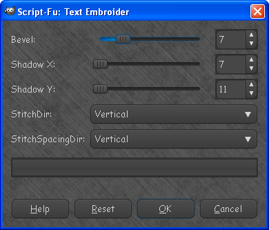

What i did to create the angled stitching-
Make a selection with the polygon select tool.
Stroke it the color you want about 6-7 pixels and then rotate the results.
Set the values in the script dialog to 7, 7, 11 and vertical for both directions.
Run the script.

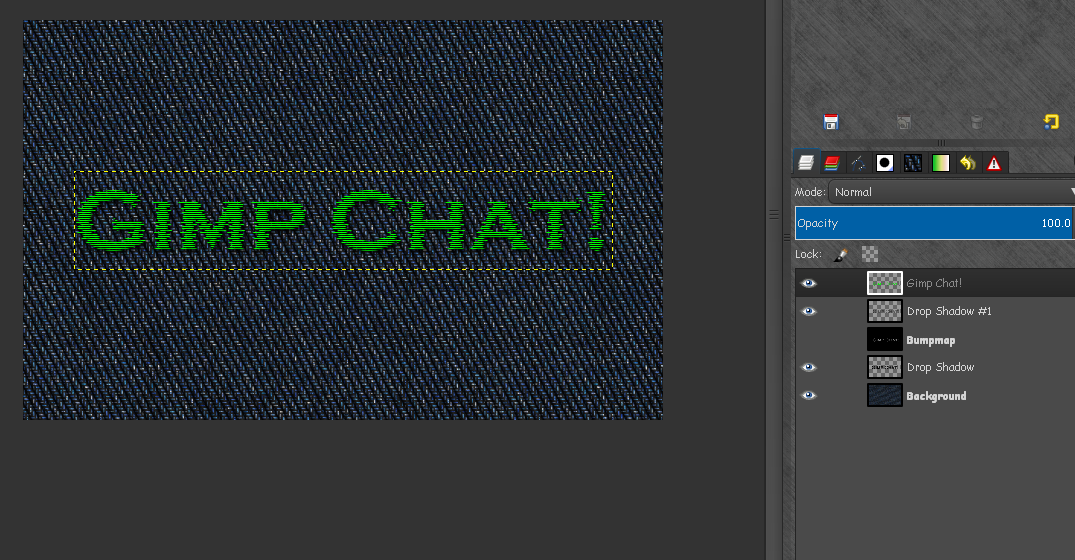

The script now will leave you with 4 extra layers
Text
Drop shadow #1
Bump map
Drop shadow
Your bg layer or pattern
I will get to work on adjusting spacing. :)

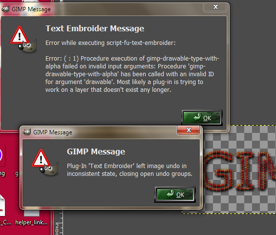

Hey Rod, getting the following error with the current version and was not before that I recalled. :)
Edit:
Best add that I will be gone for the best part of this day so may not be able to immediately reply. Using text-embroider_RD_V-2.0.scm
