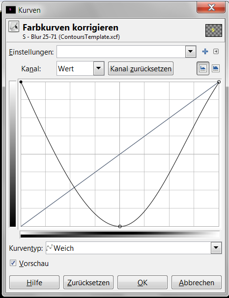

I have investigated and that does not seem to be the case. Could you please double-check?
I did, and for Cove-deep; Cove-shallow; Gaussian and Half Round i get exactly the same curve (See screenshot)
all the other look like they should
