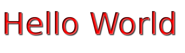

Here's a very quick go at a script to follow your instructions although I'm not sure what your example image is showing as your instructions don't make any of those examples.
It should give you some idea of what you need to do.
