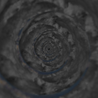

First create your best effort cloud ring (made horizontally seamless cloud line and ran Pan to Bow Script-fu set to 360 degs).

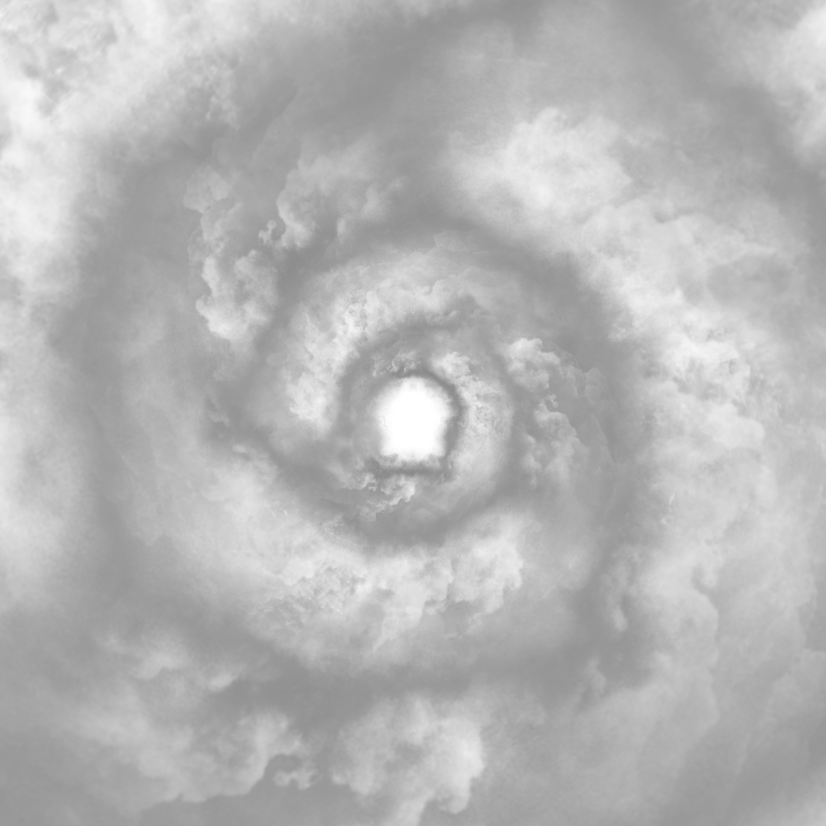

Now run Mathmap's Droste preset:
Do some addition clone/heal work and voila. :)

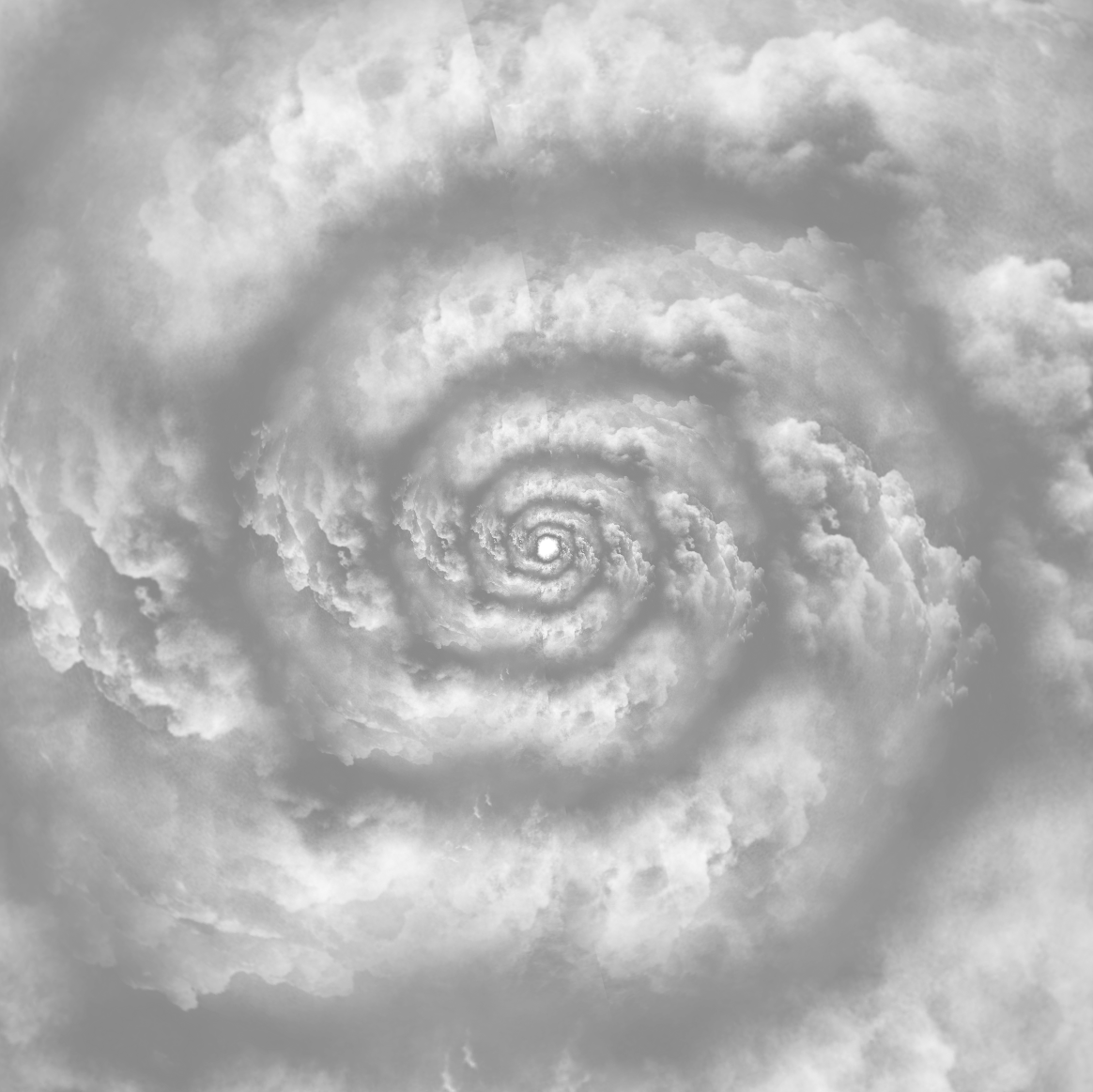

Fixed my ring and played with the Droste settings to give a wider ring and bigger center hole. :)

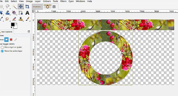

PostPosted: Wed Jun 11, 2025 6:21 am  (#14)
Posts: 2630
Amazing that it still works, this Gimp 2.10.38
script-fu-pan-to-bow.scm [4.99 KiB]
Downloaded 1717 times
