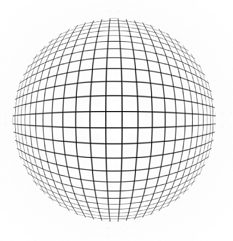

look at this picture
I am trying to write a script that asks user for N sections they want to have and then divide
a square (or rectangle) image into that many NxN squares (or rectangles).
I thought if i loop from 1 to N for Y and then inside that loop i loop from 1 to N for X
selecting the square or rectangle..
using math
I can perspective it into the image shown above...
but i am stuck at the math...
so basically I got cos(180 degrees) down to cos(0 degrees) ..i put degrees here but i actually convert it to radians before calling cos...
But I am still stumpled at the math to get the mapping of these squares/rectangles into the shape shown above.
i am assuming if i have the math down, a rectangle image will turn to an oval shape and a square will turn into a circle...
anyone can offer any help on the math behind this?

Wolfram MathWorld is worth a look.

Assuming center at 0,0:
a=atan2(y,x) # not the same as atan(y/x)!
X=x*cos(a)
Y=y*sin(a)

I can create pretty much the same thing using the plug-in-lens-distortion run a few times on a grid:

I tried this formula and found an atan2 defined somewhere else on the web...and got this

any idea why it looks like it's the inverted sphere and divided into 4 quarters..instead of what i want?
I thought maybe there's something wrong with my scheme script and thought i'd try a test on codeskulptor with the same formula and I am not getting a quarter of a circle like i was hoping codeskulptor page that uses formula

Absolutely no idea. To figure that out I would add print statements (or gimp messages) at a few places in the code to see what the values are and how often some code blocks are executed.

I would look at Filters>Map>Map Object
Select Map to Sphere.
Check out viewtopic.php?f=10&t=430 or
viewtopic.php?f=10&t=429 for some ideas.
