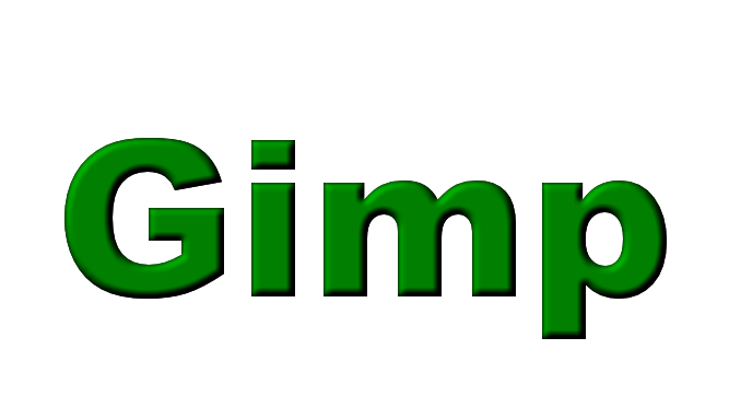

A blur filter with settings that can make it Ideal for fixing many image flaws when blur does to little and Gaussium does to much
Examples below show it's effect on bevelled text(no selections or masks were used)
Original↓
Blurred to correct↓with small 'Matrix Type'
Original↓
Blurred to round the bevel↓with Large 'Matrix Type'
original↓
with default blur↓
with blur [deluxe] small↓
with blur [deluxe] large↓

Sorry Dinasset but I didn't see your comment the script was a bit of an experiment by me and as it turns out the centre value and amount don't seem to do much it's the matrix value that determines the amount of 'Blur' applied, from small (useful for cleaning bevels) to large which tended to round the bevel, and the medium settings are good for applying to the copied layers of images,then changing there mode to grain merge (this brings out the color or pops the image)
To tel the truth the convolution matrix is a very frustrating plugin to work with

I have simplified the Menu in Rel2 (see initial post)
Dinasset I hope the new Menu and examples below will help note! your image size will have an effect on any blur
original↓
with default blur↓
