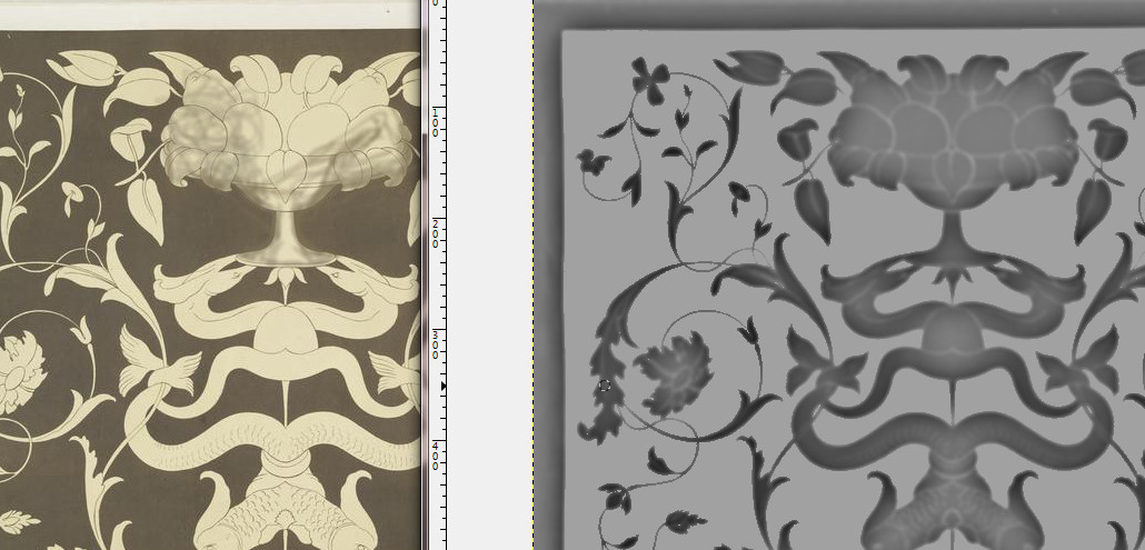

I want to make a normalmap from a simple 2 color image of a fruit bowl with some snakes and things, where the white areas like the fruit bowl are white in the middle and gradually shading to dark on the outside and the snakes also white in the centre and dark on the edges, but if i use blur it would make the snakes darker too fast compared to the fruit bowl because the fruit bowl is bigger.
i had a go with wavelet decompose but it's not quite the desired effect. please tell me some tips and tricks to make round greyscale forms in the middle of these images..
here is a pic to explain:

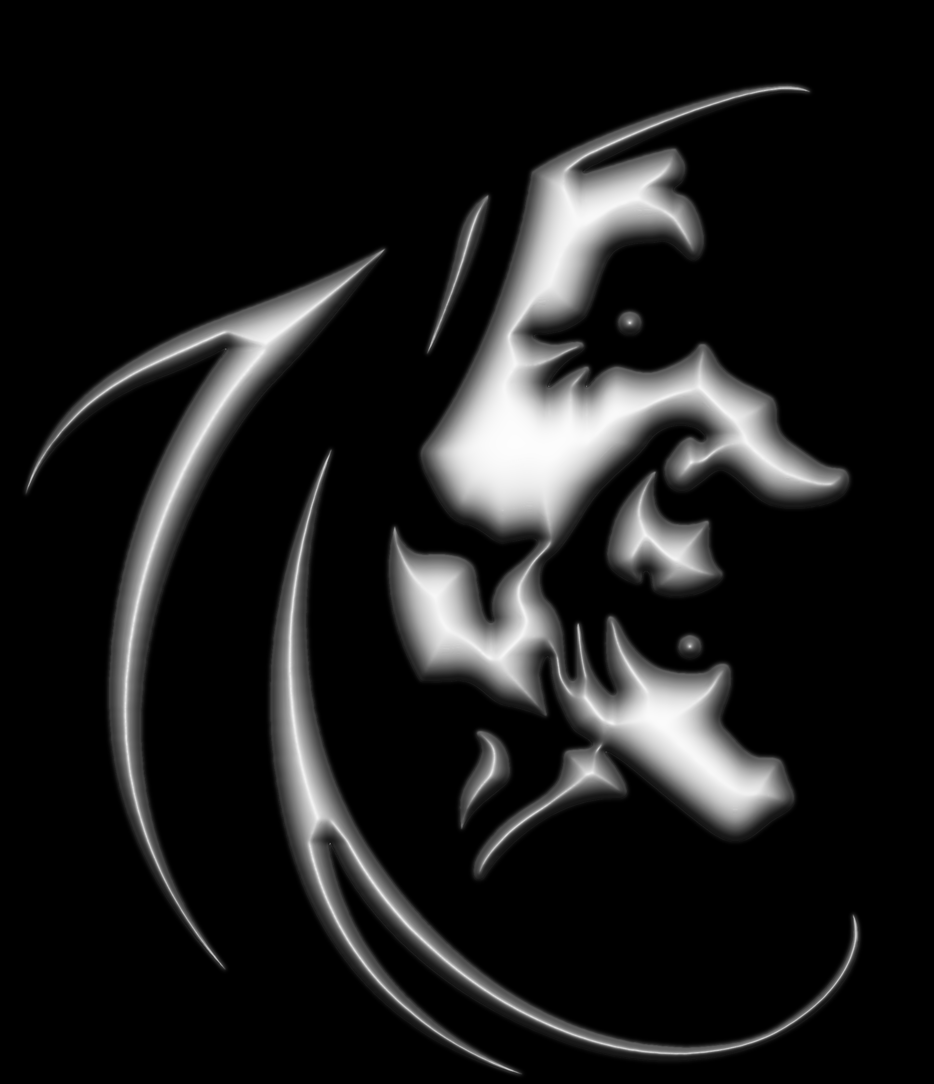

Again thanks for the tut; added a few other things to smooth things some as well. Started out with one of my Dad's pumpkin carving patterns. :)
