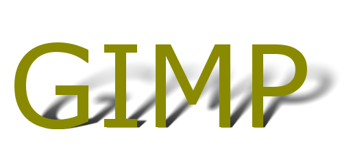

Rod is this close to what you mean

Lyle I'll post tomorrow but it's simple: 'perspective shadow' then add a white-mask on the shadow layer and blend with gradient FG/BG (black and white) from top to bottom on the mask.
Not sure if it's what Rod wanted though

Now that is some shadow Graechan, I don't know how you did it but I would sure like to have it.

This is what I would do:
Which is a perspective shadow, with a focus blur using a black to white gradient as a depth map to get the "deeper" areas increasingly blurred, then a layer mask using the same gradient to fade the shadow.
.xcf attached
Kevin
(actually what I would really do is use POV-Ray to render it properly ;) )

Is it just me, or in Graechan's result does it not make the letter 'P' seem closer to the viewer than the other letters?

Fluffybunny you are correct.
Thank you Kevin and Graechan that is almost perfect. Just needs more sharpness at the front of the shadow i think.

guess I just got n'jd. lol. I was looking for my post and wasn't there, Yes Fluffy I also agree that it looks closer but maybe it is because the tail on the p goes below the bottom of the other letters. Tjhe script is really looking good though.
