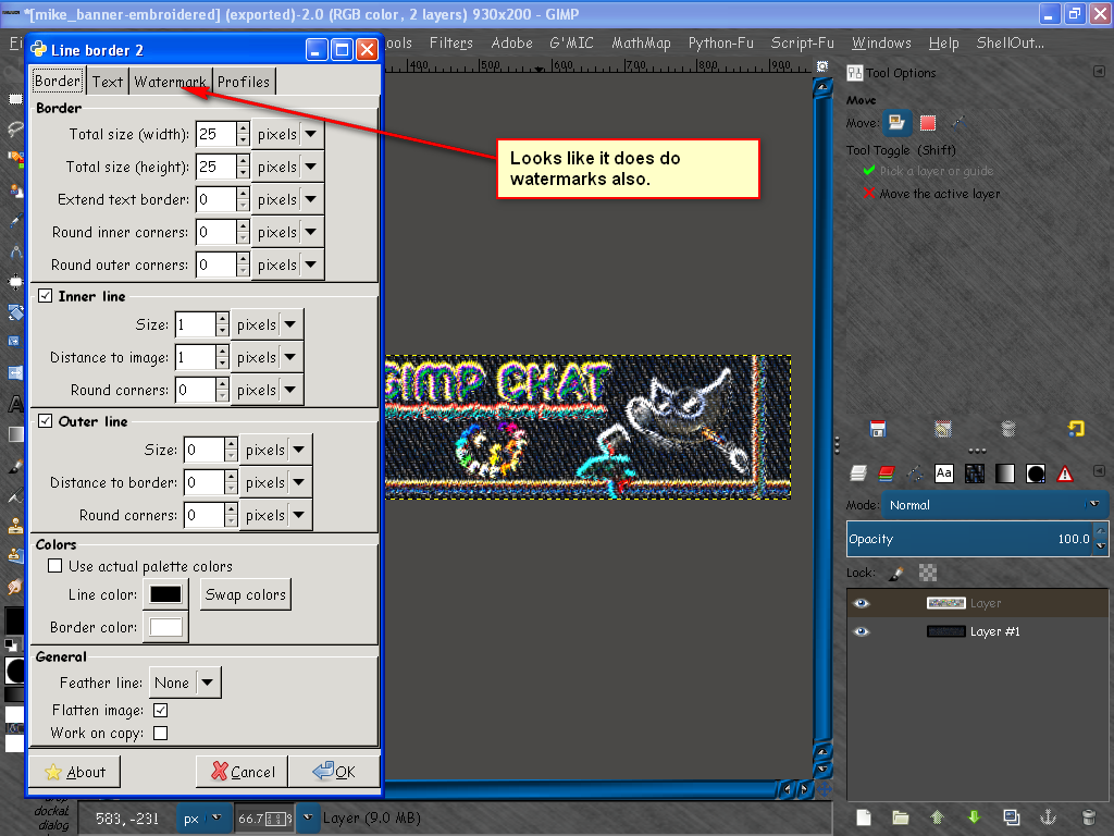

Doesn't the Line Border script do all these things?
http://registry.gimp.org/node/24784

:jumpclap IT DOES !! :jumpclap
Not all , no invisible watermarks and alas doesn't call fancy logo scripts but does all the essential
cool script but the author is really too modest, calling a similar script Line Border , i really overlooked for its name i was thinking was a script for the most simple solid color frame instead is almost my dreamed Total Finalizer
It would be possible replace the section for visible watermark, with a call to Saulgoode or Fencepost scripts for hidden watermark ?
Or leave it , but add also a option for invisible watermark
Anyway the script really need a more descriptive name ...even simply use as name what it does even something as
" Add Frame Title & Watermark" would be better .
I even HAD the script ....but how i could guess that a script called Line border may do watermark and add titles and copyright info ? :hoh
