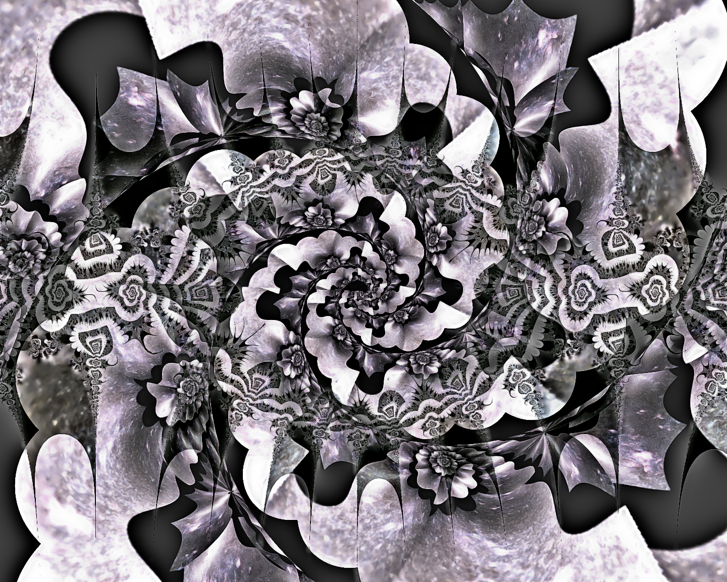

This is our Milky Way galaxy converted via the Droste technique using Mathmap (from reading the Flickr posts I appear to be some 4 years behind the times). I duplicated the original image and inverted the image layers using Soft Light mode, then ran PC's Graphic Boost Dark on the flattened image.
I was originally seeking a way to make some "unique" fractal designs for screen printing, which I would then apply to t-shirts. Droste appears to be an interesting way to create fractals.

The original layer of my above image went into repeated sequences, but the technique was all too common with anything you threw at it. It looked nice, but it was just more of the same pattern repeated to infinity. I decided to toss the droste filter's pole settings and fractal generator into high gear and it added some punch-drunk "pizazz" into the scene to spread the cheer around. Duplicating the layer and reversing the effect (then combining the two) made for some real eye-popping imagery. The only problem then was, with so many settings to play with, picking which setting/imagery you liked best. You could literally waste hours trying to find that "perfect storm".
I followed Josh Sommers tutorial found here: http://www.flickr.com/photos/joshsommer ... 4/sizes/o/
I strongly recommend those who haven't tried this, to give it a shot.

I am finally getting somewhere with MathMap, using the composer with Droste and Mercator filters. I did have to jump into G'MIC to use mirror array, (is there anything similar in MathMap? - I didn't see it) Anyway, I'm liking the fractal generations I get using this combination. As soon as I can figure out the best 4 color combination for screen printing, I will test some patterns out. (I'll probably go with gray monochrome colors on black cotton).
