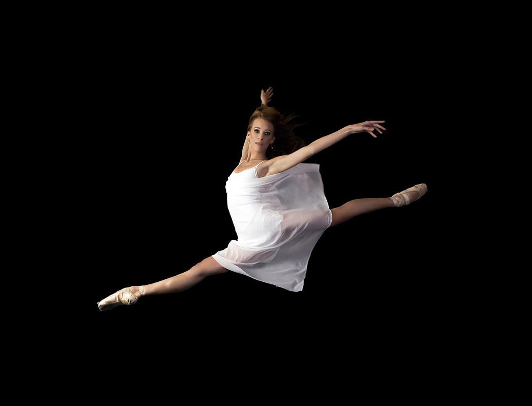

Change the black background color of the image below to white.
Don't say it's a piece of cake yet. The hardest part is to change the midtones 'behind'
ballerina's translucent chiffon tulle skirt without destroying the image and most importantly your computer :crash
I've done a 30-40 minutes work trying different approaches (color to alpha, messing with channels, gmic filters, color substitution, etc.)
The best I could come up with so far is this
If you have a recipe for doing such a task in the most efficient way in GIMP, please, come out and share your wisdom with us ;)
Good luck!
P.S. To convince us there is indeed a translucency place an object of distinct color (e.g. blue) behind the skirt :bigthup
P.S.S. To track image integrity and changed BG behind the skirt open both images as layers in gimp

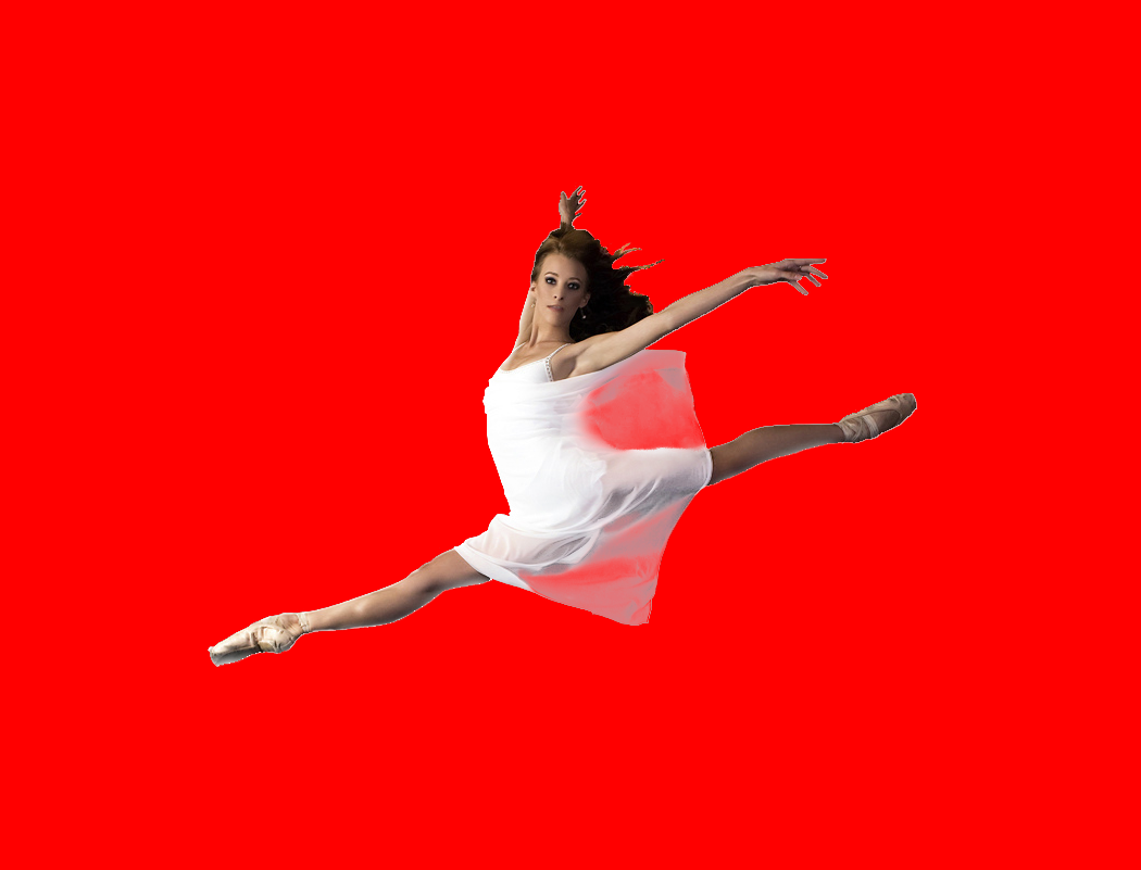

This is what I tried
separate the background, filled with required color
separate the translucent area, filled with required color and overlay with lower opacity

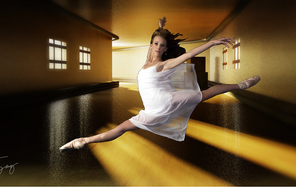

My attempt.
Masks, curves, and lots of patience
bbbbbbbbbbbImage
 Post subject: Re: Handling translucency is tough [challenge]
PostPosted: Thu Jul 10, 2014 7:39 am  (#4)
Posts: 14125
Akros, you got it! I love the atmosphere created and the translucent through the dress, great! :coolthup :clap

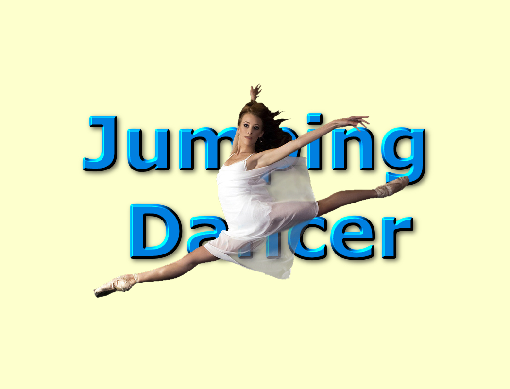

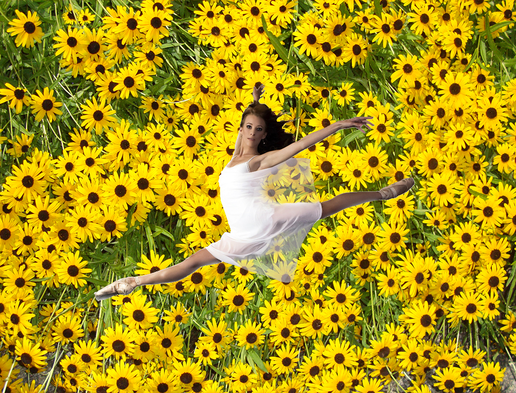

@okyl168 good results, however, overlaying with color-filled layer may work sometimes but it colors the fabric of a skirt rather than the
background; imagine now that you have a customer who wants you to make a foreground selection so he can put any image on the background
that would show through the translucent areas of the skirt. Real translucency is a must in such cases. (images below)
@dinnaset nicely done, the only critique is that the selection of the background obviously grown 1-2 pxls to get rid of the black outline also shrank ballerina's fingers.
My attempts aren't perfect either so I just keep trying.

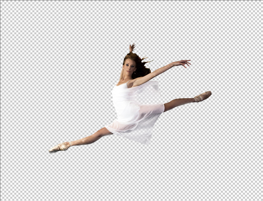

Real translucency [screenshot]
so that the BG can be easily replaced
