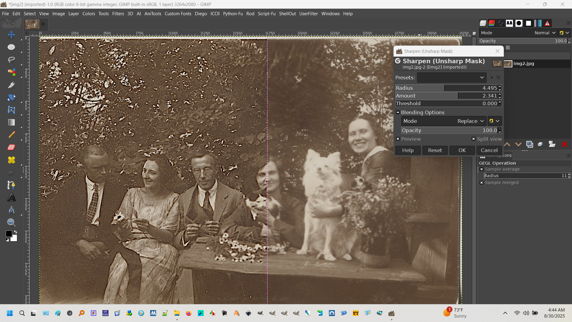

I just ran it through Filters>Enhance>sharpen unsharp mask (GEGL with preview).
After that you may want to remove the noise as Rich stated.

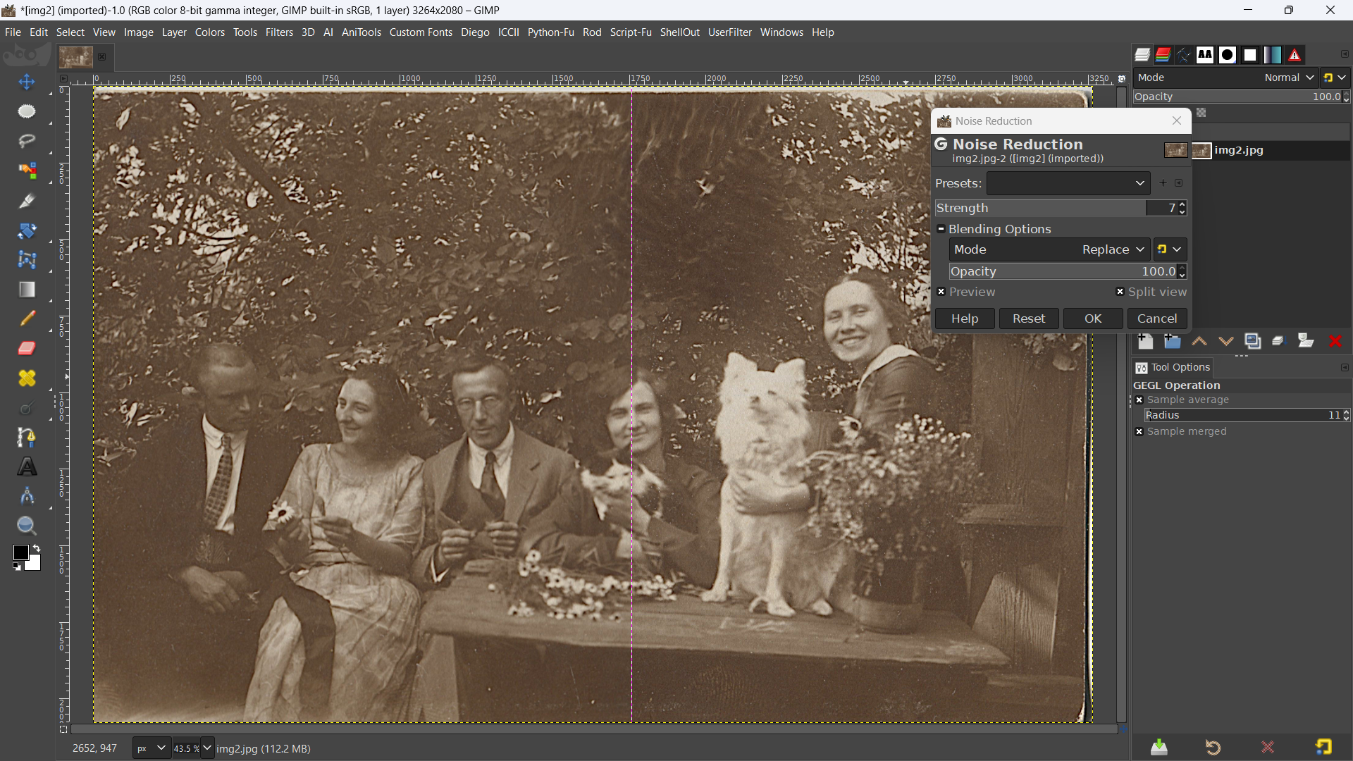

Or perhaps Filters>Enhance>Noise Reduction. After sharpen unsharp mask.
