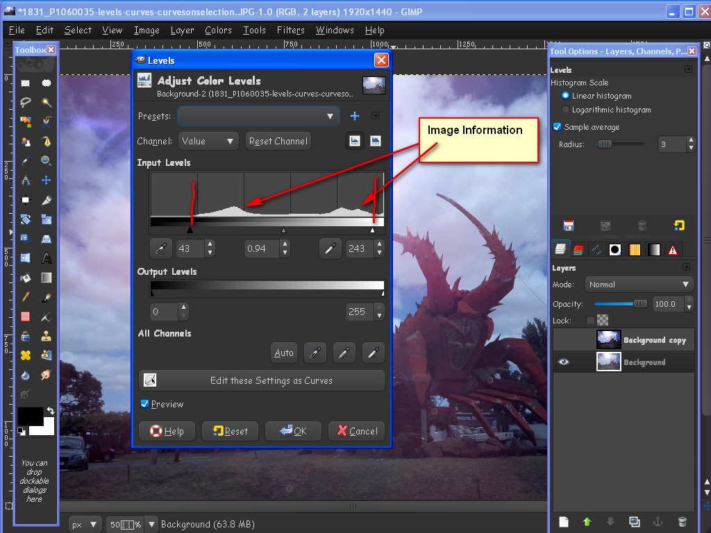

Sallyanne if you open your image in GIMP and go to Colors>Levels just by pushing the arrows towards the image information (that would be indicated by swells), you can retrieve much of the information that can be lost in a photograph.
This is with just levels as a mentioned above then a selection with the scissor tool to make the lobster horn that has the wire hanging on it darker by using Colors>Curves.
Original-
Adjusted-
 Post subject: Re: Can this be saved?
PostPosted: Sun Jan 12, 2014 1:53 am  (#18)
Posts: 16149
Thought i would add an explanation with an image so you know what i mean. :)
