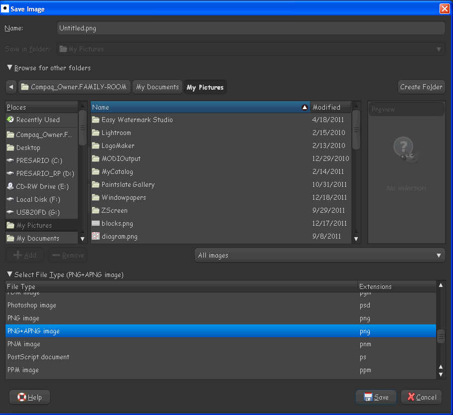

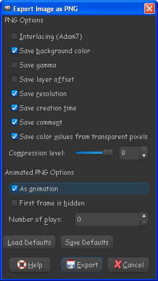

Slide wrote:
Maybe I don't know the steps to export them. I bring up 3, or 4 layers and save them as test.png. It saves (1 frame)with nothing as far as save as animation. What are the steps please?
Thanks
Slide when you save the image make sure to open the drop down menu (bottom left of the save dialog window)
In that drop down is a whole list of extensions Gimp understands.
Select png-apng and a dialog like this will open -
Be sure and click as animation and then select Export.
Your image will be saved as a animated png file.
To re-open that same file you have to open Gimp, go to File>Open, and use the same drop down menu and open your animated PNG AS png-apng to see the layers. :)
Hope that helps you.
Thanks
Your image will be saved a s a animated png file.
Thanks Rob. I finally figured out where to put the files. I was using .gimp\plug-ins as the dir. Not the GIMP-2.0\lib\gimp\2.0\plug-ins dir like you said in the other post. It's working.
