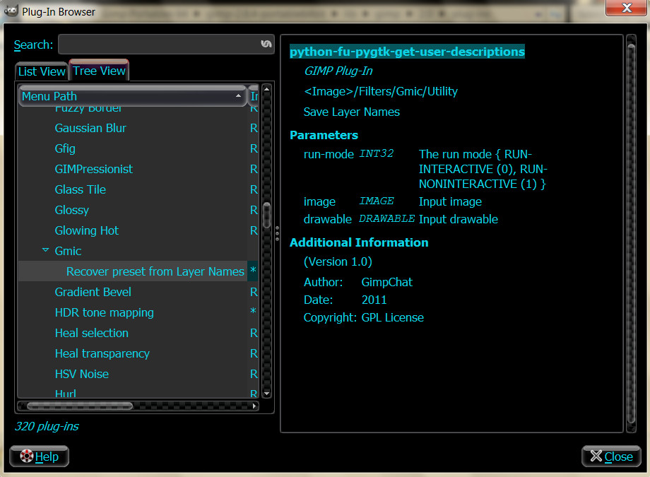

There is already a script to save Gmic settings to a text file. I am using partha portable 2.8.4 and G'MIC 1.5.6.1(beta). Under filters there are two G'MIC chioces. the original "G'MIC" and another a little above it "Gmic". Selecting Gmic>Utility>Recover preset from layer names, will give you a text file "Layer0_preset.txt" for the selected layer. In this case layer 0.

No, I just noticed it after the G'MIC 1.5.6.1(beta) install, and thought it was part of it. It could have been there b4 but I hadn't noticed it. From the name "G'MIC 1.5.6.1(beta)" I think it is the one from the gmic download page: "gmic_gimp_1.5.6.1_beta_win64.zip". It doesn't show up in the plugin browser or the procedure browser, so it might be part of the new gmic? I tried to attached the file, but it is over the 5MB size limit. I will check further and report back!
:jumpclap :jumpclap :jumpclap :jumpclap Edit: It is a plugin and not in Gmic. Attached is a photo of the the gimp description. Surprisingly, its author is GimpChat date 2011. I have not found the actual plugin yet, but considering it is in Partha's 2.8.4 portable and the date, I have the feeling it came with Partha's build.

Forgot to add the photo. Sorry!
The filter is here.
viewtopic.php?f=28&t=978&start=40
Thanks bilbo9955! :bigthup
