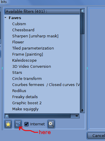

In G'MIC you refresh the 'filters' where the refresh icon is at the bottom of the menu list. Make sure you are conected to the internet at the time
Are you using the latest G'MIC oldmangrumpy?
