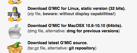

Thanks Wallace, but I went to the g'mac site and the 1.6.6.1 appears to be for OS X 10.10 and El Cap would need a 10.11 version ? right ?

The link for El Capitan build is given in my first post. If the plugin is copied correctly the version has to be 1.6.6.2 prerelease, NOT 1.6.6.0!
You have to find out where the 1.6.6.0 plugin comes from or where it is located (plugins folder!).
By the way I think the Yosemite build is usable for El Capitan too. I tried the El Capitan build to ensure the functionality of the plugin for the older OS versions! I have actually only 10.10 and 10.11 not the others!
As far as there are no claims or failures from users with older OS I will move over to 10.11!
Wallace, by the way, it is recommended to use the latest gmic versions, actually 1.6.6.2 pre. They are quite stable. Only for problems you should use the stable version.
