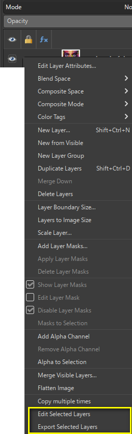

Eeeeeek
And also in the context menu in the Layers dock:

MareroQ wrote:
Eeeeeek
Thanks for posting the image. Batcher appears exactly like that. :)

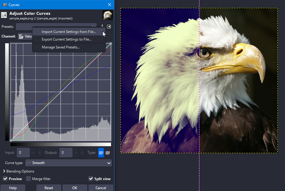

One of my comments about Color Correction:
Adjust Color Curves in Gimp3 supports old and new curve formats.
Batcher only accepts the new format, so a simple operation is needed: import the old file format and export as new:
