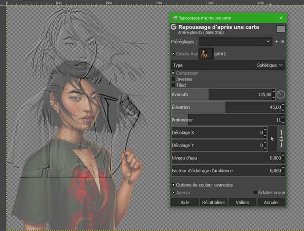

This filter:
The embossed object is not above the original object.
how to set so that it is automatically in the same position as the initial object, because too long to move pixel by pixel with the cursor "Offset Y"? :(

Nidhogg wrote:
Works okay for me.
Did you try to reset (reinitialiser) and select the aux input (Entrée Aux) again?
Nidhogg Image
After reset,it's the same.

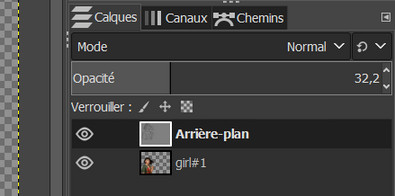

no selection and just 2 layers
The offset is because the layer (or a selection)used as the bump map is a different size to the layer that is bump mapped.
example - two layers the X for the bump map smaller than the canvas
Apply a bump map and the X is set top-left-corner (offset X / Y = 0)
To keep it in position:
Either apply an offset (which you do not want to do ;) )
or more usually resize the bump map layer to the same size as the bumped layer.

Go to Layer > Layer to image size and apply it in both layers (the bumpmap layer and the layer receiving the bumpmap).
This should fix the problem; As rich2005 said, the offset is caused because the filters take input from the individual layers and not the whole image.

rich2005 Image and Dionisio Image
that's it :bigthup :bigthup :bigthup :bigthup
