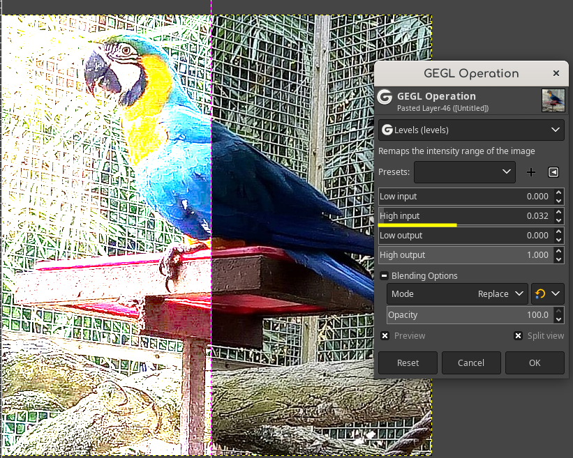

Example of Levels High Input setting

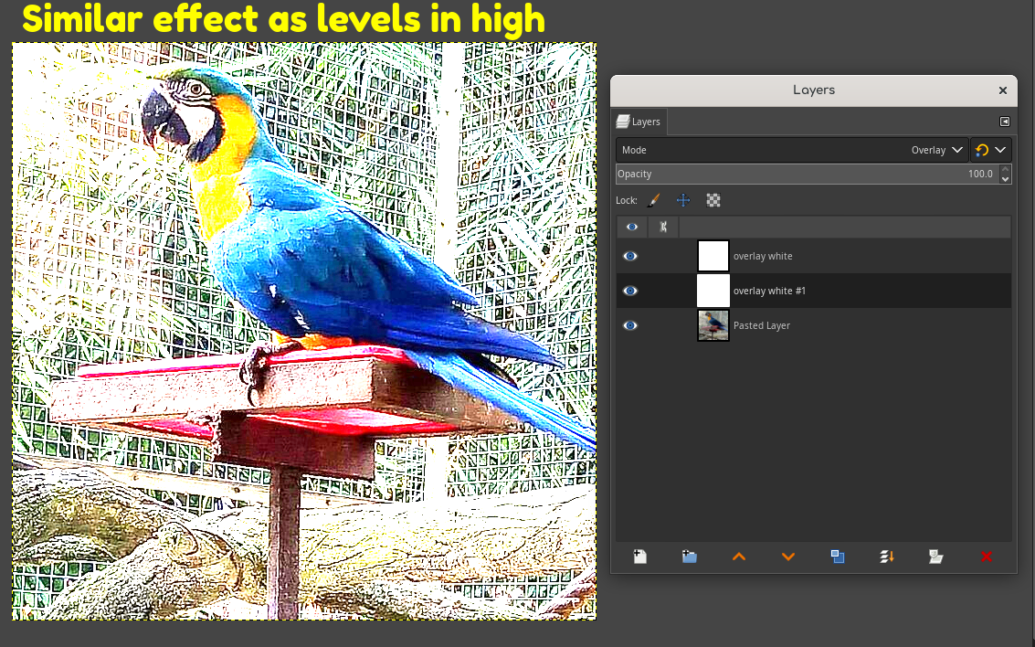

The same effect being mimicked using Gimp layers

This thread is a short guide on how to mimic Levels settings and invert using Gimp blend modes. Please remember that all of these are shown on very high values and that lowering a layers opacity or making a grayscale color fill can make the effect much less intense, and to optionally put the color fills inside a pass through layer group. You can also set a keyboard shortcut to auto fill the canvas with the primary color like I do. The instructions are below.
1. A Grain Merge black fill on Blend Space RGB Linear is similar to Low Input or gegl:levels in-low
2. A double stacked Overlay on a white fill is similar to High Input or gegl:levels in-high
3. Normal on a white fill is similar to Low Output or gegl:levels out-low
4.Normal on a black fill is similar to High Output or gegl:levels out-high
