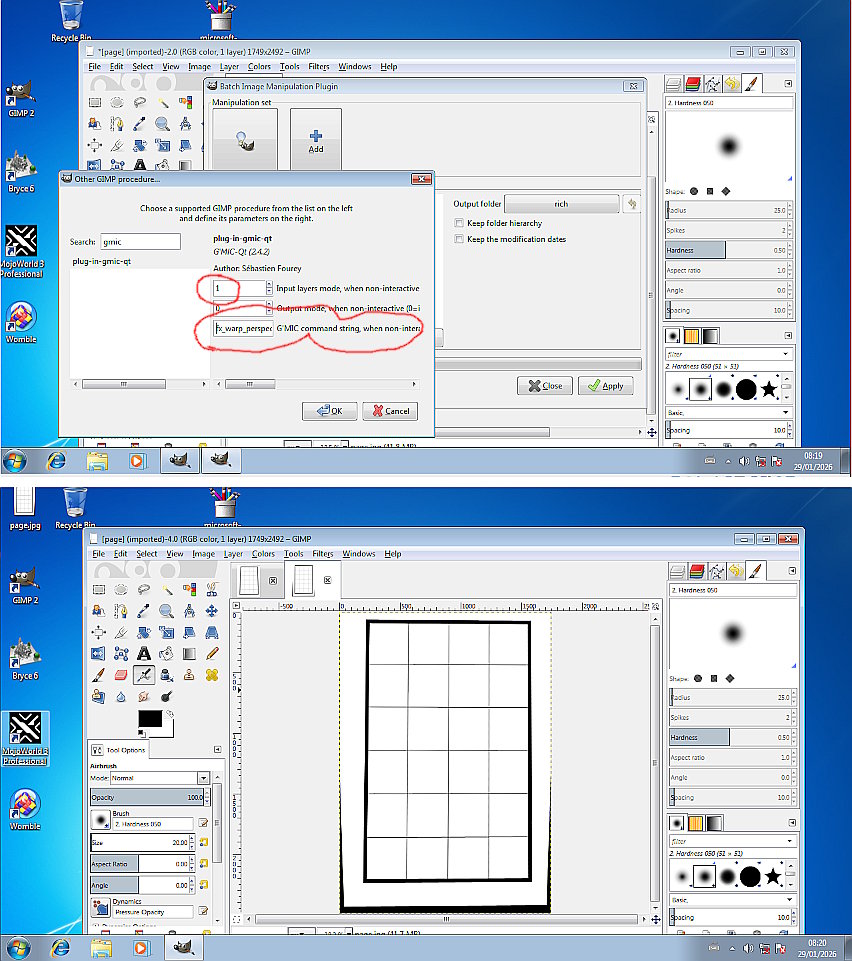

Like Tasmamnia it fell back to using the gmic plugin. The next problem is just "old-stuff" I did the following in a 32 bit Win 7 VM Gimp 2.8.20 and gimp_gmic_qt 2.4.2 The gmic perspective filter. Fortunately I did not delete all the files so ;)
This is the gmic filter, the only settings required are the x angle and boundary = transparent, That gives a gmic string. You can edit that first term (-0.096) depending on image.
fx_warp_perspective -0.096,0,1,50,50,0,0,0
It goes into BIMP like as shown. Bottom is the result.
Best of luck.
