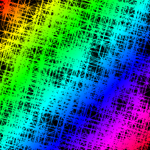

The "textures" you were admiring are, I'm afraid, just an artefact .. a side-effect of the way the script produces the sparkles. If you create a blank transparent image (File>New plus Advanced option>Fill with transparency) and then run Filters>Alpha to logo>Chrominium on that null image you get something like this:
The alpha-to-logo simply has no contours to work upon, so no "chrome" effect is produced and all that is output is just the sparkles (generated by GIMP's sparkle plug-in). It is the interlacing and crossing of those sparkles which gives the appearance of a texture.

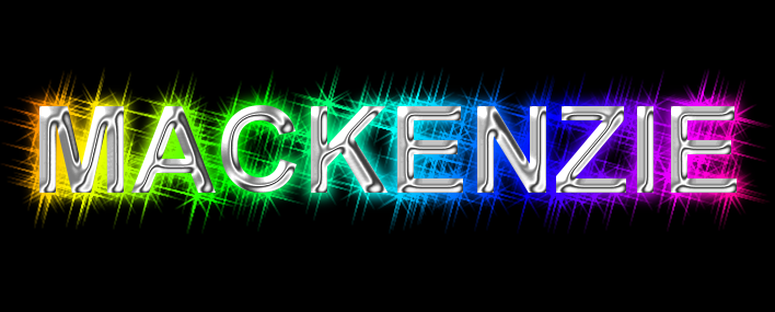

PostPosted: Thu Jan 05, 2017 6:56 pm  (#27)
Posts: 2662

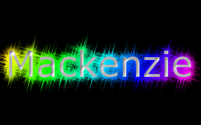

This is what I get when I use the Chrominum script. Located here: Filters>Alpha to Logo
Unfortunately, The text itself doesn't have a chrome look to it. I am currently using the the most recent version of gimp.. 64 Bit Windows 7.
The first one is version 1
Here's the 2nd version:
With this version, I had to deleted the layer named Background #1. I shouldn't have to delete a layer. Is there a way around this?
 Post subject: Re: Chrominium Script.. how does it work?
PostPosted: Fri Jan 06, 2017 3:15 am  (#28)

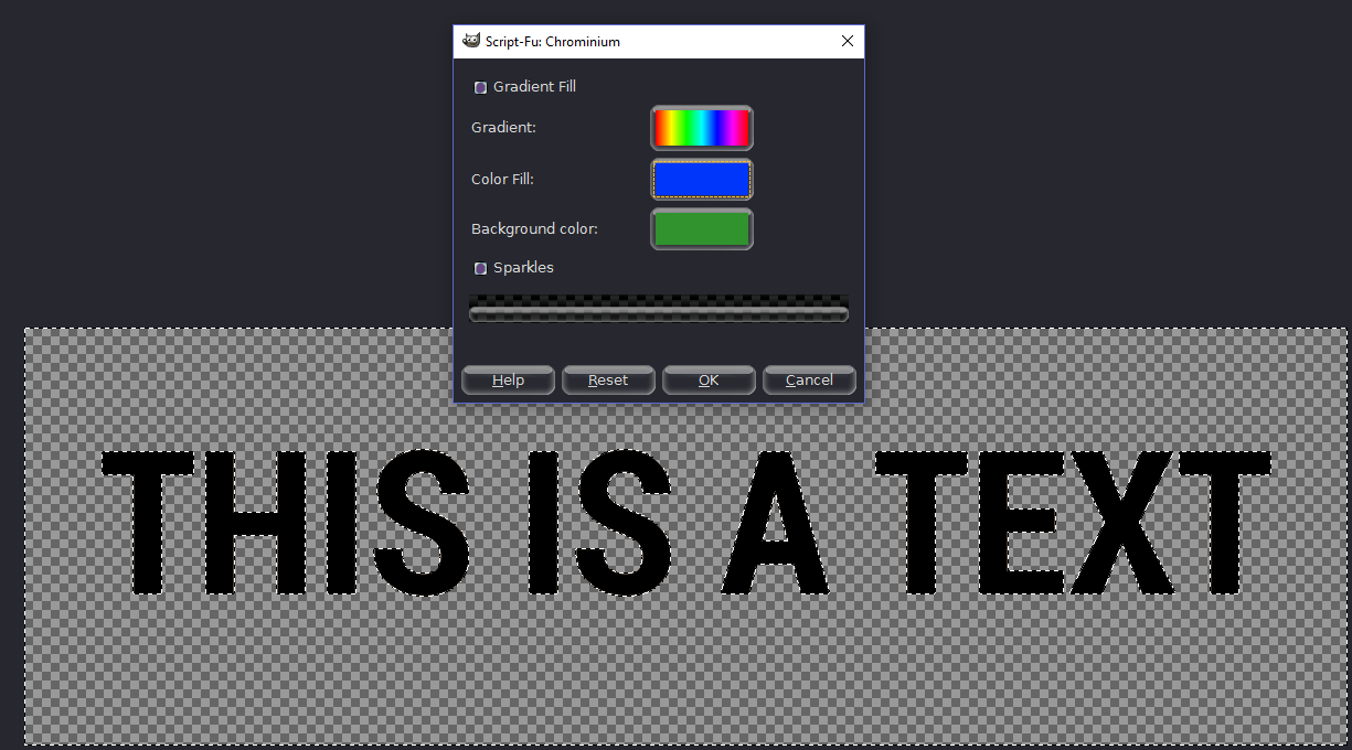

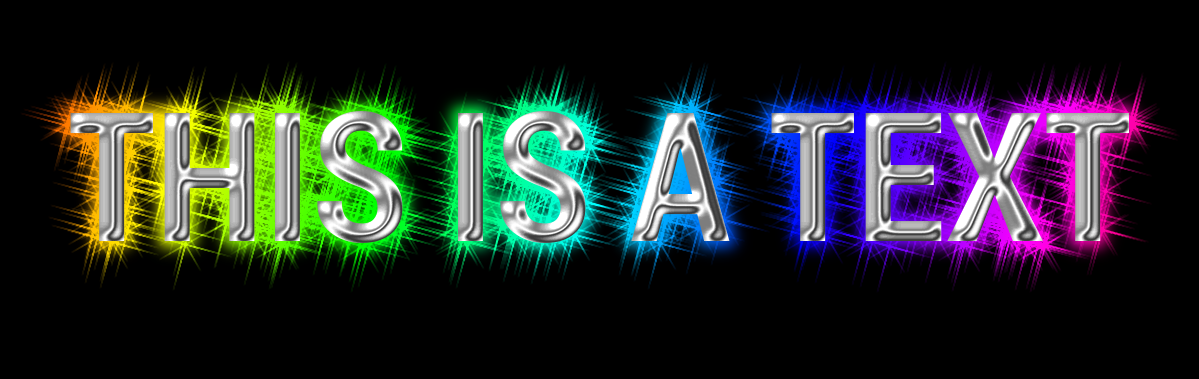

With this input: (selected text on a transparent BG, default parameters)
I get this output
no need to remove any layer
PostPosted: Fri Jan 06, 2017 3:20 am  (#29)

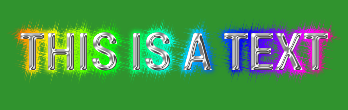

With this input: (selected text on a transparent BG, changed parameters)
I get this output
still no need to remove any layer
PostPosted: Fri Jan 06, 2017 7:12 am  (#30)
Posts: 1436
Sure you need to remove or hide the background layer and also the mapper layer if you want transparent background to be shown automatically after the script is run.
Unless you´re not doing whole lot of them, like for .png export this should not matter. Otherwise the .scm needs to be modified.
The result with the logo version is exactly same.

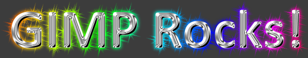

Is there a way to set the background color to transparent? Wouldn't that do it?
Mine turned out well, even with a background color.
:D
PostPosted: Fri Jan 06, 2017 3:10 pm  (#33)
Posts: 2662
I wasn't working on a transparent layer when I did both results. I was working on a black background layer. How ever, I do agree that the .scm file does need to be modified.
