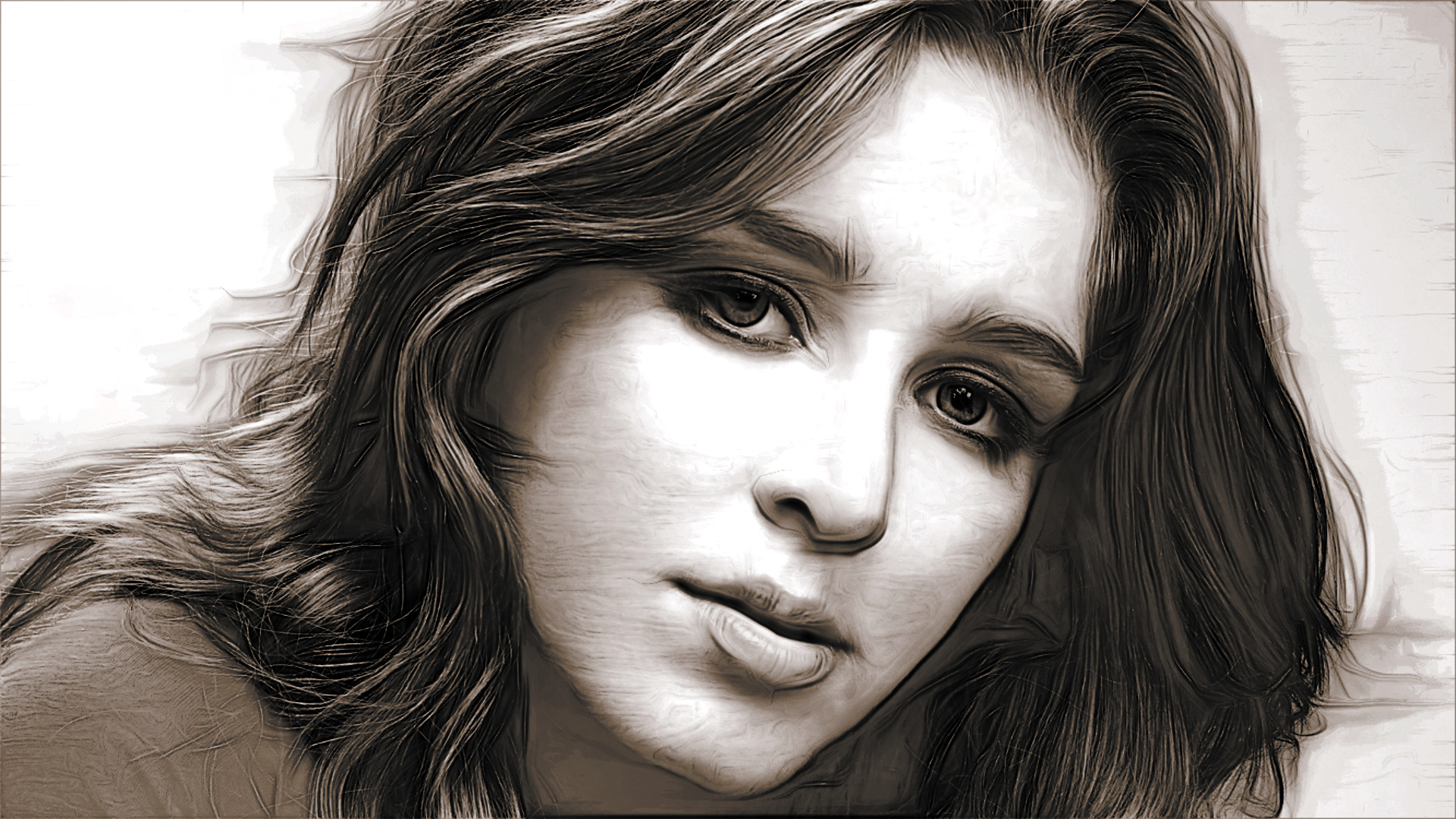

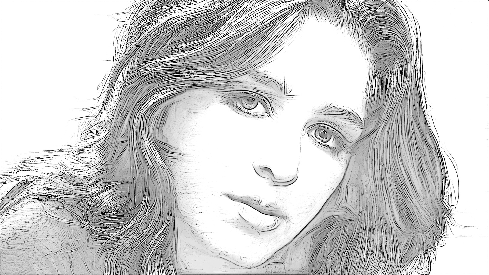

Rod that's interesting!
This same effect is achieved by desaturate the image and apply a mask to specify the areas to be colored. Pretty simple.
So I decided to compare the results using the two techniques, and the same mask.
By Pencil Shade - Rod's Tecnique
By Dessaturation Tecnique
The large difference seems to be the opacity (lower contrast). But it is very subtle.
I'm still using version Rel1, has not given any error in my Gimp.

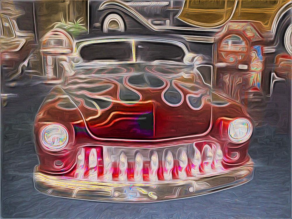

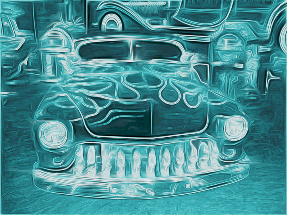

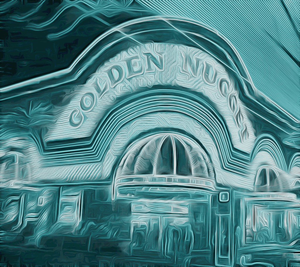

Well, I suppose that could be said for lots of different filters. Some filters just work better with certain kinds of images, or certain size images, than others. For proof of concept, I was able to implement the effect with just a few lines of code added to the script. The effect looks good, at least with the photos I tested out. There really isn't many parameters to change in the filter and those options could be easily added, if needed.
; Add Effect to Pencil Script (GnuTux)
        (gimp-layer-set-mode lineLayer NORMAL-MODE)
        (gimp-layer-set-opacity lineLayer 100)
        (gimp-image-raise-layer image shadeLayer)
        (gimp-layer-set-mode shadeLayer DIFFERENCE-MODE)
        (set! lineLayer (car (gimp-image-merge-down image shadeLayer EXPAND-AS-NECESSARY)))
        (gimp-colorize lineLayer 187 70 -15) ; +7 to blue, +20 sat, -15 lightness
        ; Call GMIC
        (plug-in-gmic
                        1 ; Mode: interacive=0, non-interactive=1
                    image ; Input Image
                lineLayer ; Inout Drawable (not used)
                        1 ; Input layers mode, when non-interactive (see below)
                          ; 0=none, 1=active, 2=all, 3=active & below
                          ; 4=active & above, 5=all visibles, 6=all invisibles
                          ; 7=all visibles (decr.), 8=all invisibles (decr.), 9=all (decr.)
        ; GMIC Command String (Run GIMP from terminal set GMIC to verbose to see command string)
                   (string-append
                   "-v - "                ; Required to work properly in Script-fu
                   "-gimp_dreamsmooth "   ; GMIC filter name
                   "2,1,1,0.8,0,0.8,0"    ; GMIC filter arguments
    );end GMIC call
Classic Car
Golden Nugget

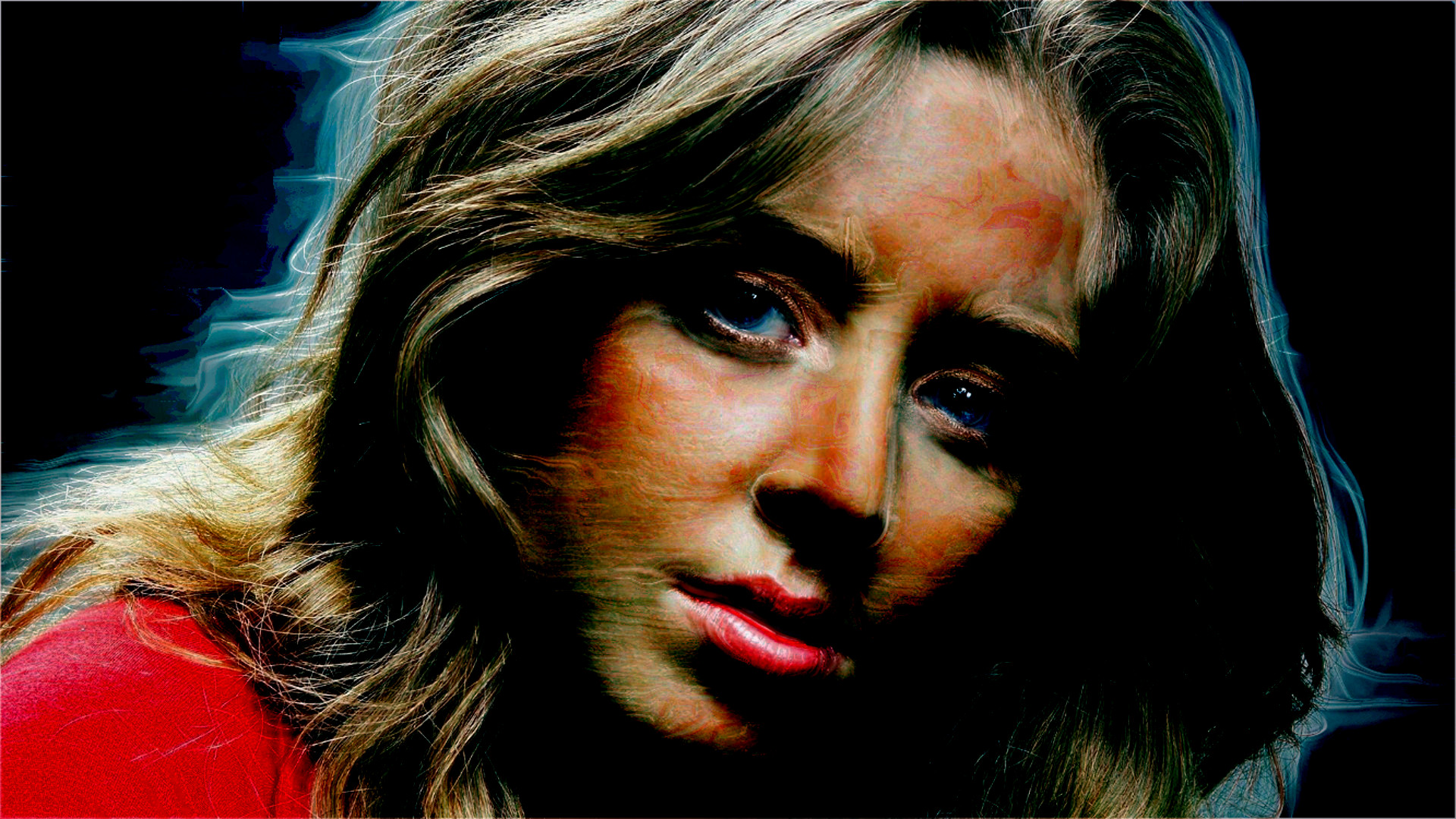

has anyone tried this with a burn overlay mode on top of the original image. Wow!
Nice Graechan. Thanks for the new wisps filter.
 Post subject: Re: Pencil Shade script Rel5 [now with wisps]
PostPosted: Tue Jul 16, 2013 1:54 pm  (#53)
Posts: 16168
First run wisps-keep all layers
change mode to grain extract layer mode (bottom layer is original image) , flatten the layer (duplicate) , and run pencil-shade with defaults on the top layer. :)
Now
Place line layer in center and set to grain merge 100 percent opacity and set the shade layer on top to color mode. 100 percent opacity also.
PostPosted: Tue Jul 16, 2013 2:02 pm  (#54)
Great effect, Rod! I also like placing the original on top and selecting color mode.
