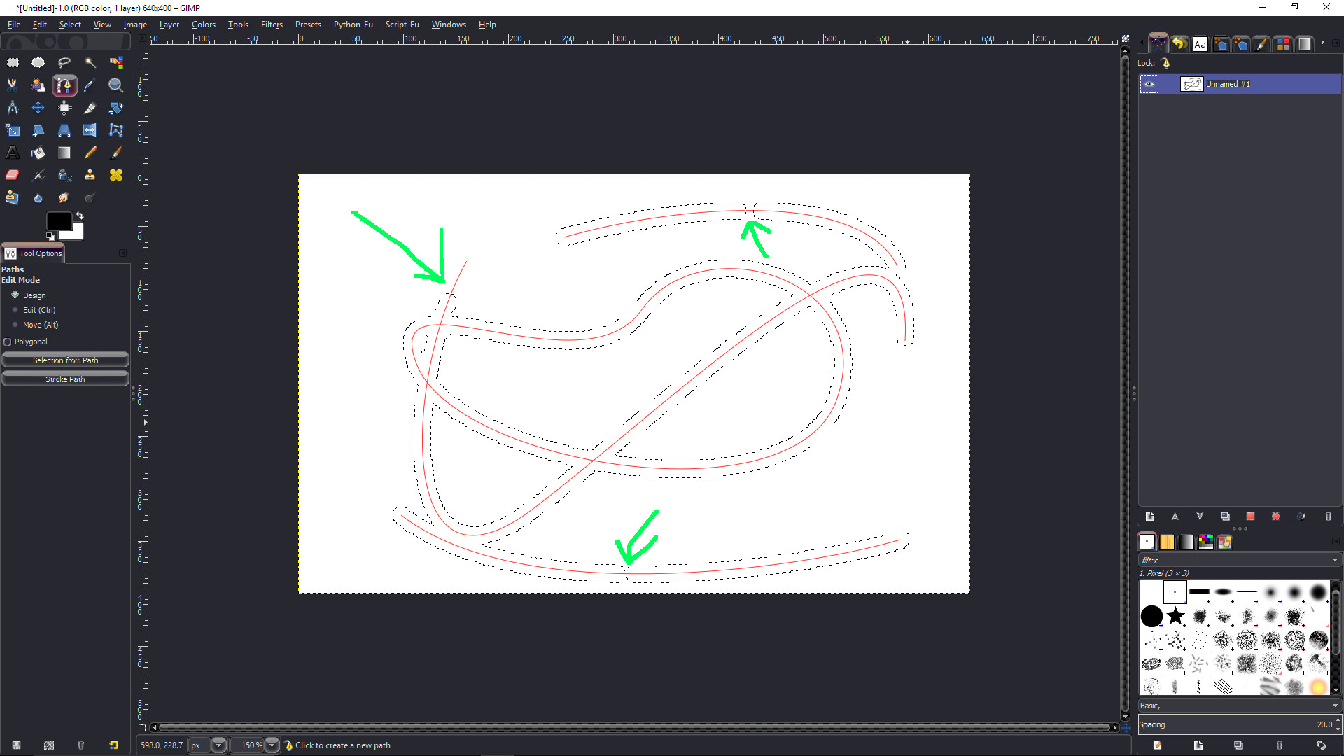

I have noticed that while having the pen tool selected when I run it, the resulting selection doesn't go the full length of the path. But if I have the pencil tool selected it goes the full distance of the path. Either all the way around a closed path or the full length of the open path.
It doesn't work that good if I have the airbrush or paintbrush tool selected either.

PostPosted: Sun Aug 21, 2016 1:45 pm  (#17)
Joined: Feb 14, 2012
Posts: 426
Here's an example screen shot
Now if I had the pencil tool selected it would have been a full selection.
