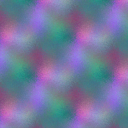

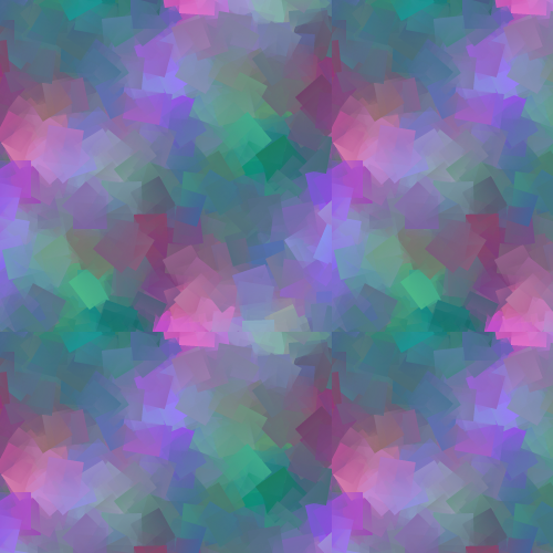

Thank you, RobA. Is it my understanding that the original image must be seamless for your filter to work?
So I can't just fill an image with plasma and run the tileable cubism filter on it?
OK, filled an image with plasma, made it seamless and ran the tileless cubism filter on it. Very nice!
Love the tileless spread.
