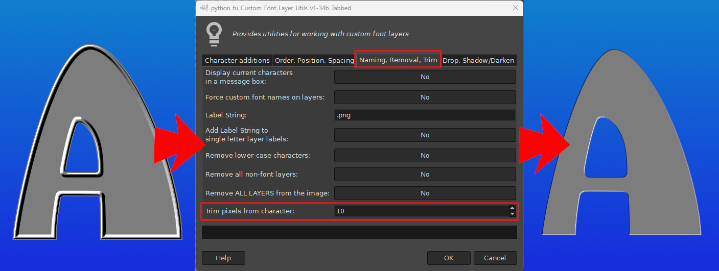

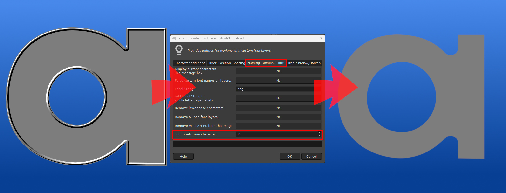

Open Custom Font Layer Utils and set the trim value on Tab 3 of the dialog to turn the characters into smaller panels.
If you are happy, save the new panel characters with an appropriate name. If not, hit undo and use a different value for the trim.

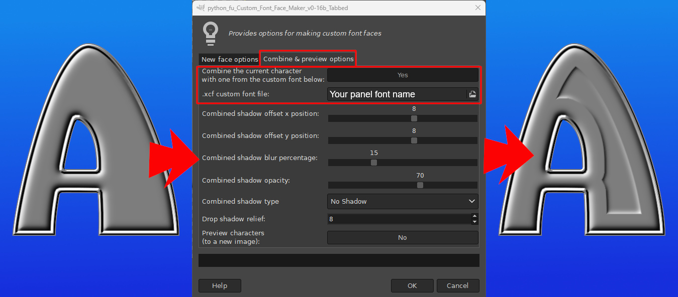

Return to (or re-open) the Box characters and use FaceMaker to combine the two character sets using the options on tab 2 of the dialog; make sure that you use Normal mode on tab 1.

Open your box characters (Part 2 shows you how to make them) and use the option on Tab 3 of Custom Font Layer Utils to trim the border from the characters (adjust the value used for your own needs):

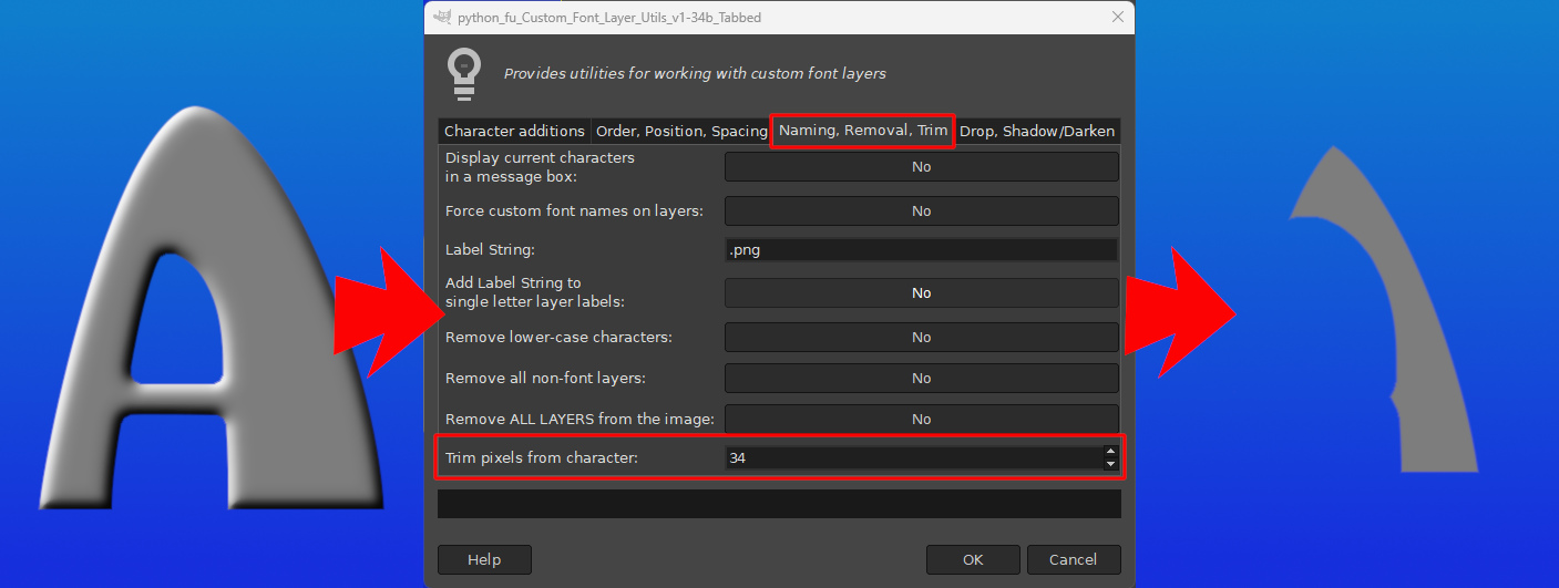

Use the Layer Utils trim option again with this new set of characters to create a smaller set of character panels. The aim is to trim enough off so as to completely lose the thinner sections of the characters; you may want to work on a single layer (Edit>>Copy then Edit>>Paste as>>New Image) to find the value that works for you.
It may be a good idea to check through the layers and remove any ‘stray’ unwanted areas that have been left un-trimmed.

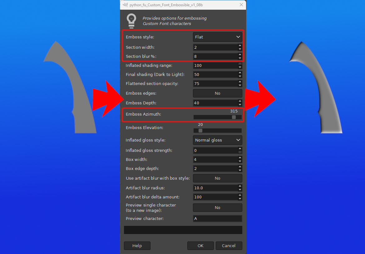

Use the Embossible filter to add a flat emboss to this new set of panel characters. You may also want to adjust the section width now. Change the azimuth value to send light in the opposite direction across the embossed character. If you are not sure about this new value, add 180 to the original number; If that value is larger than 360, subtract 360 from it. (My original azimuth was set to 135 so 135 + 180 = 315.)
f you want to add a different style of décor to the panels do this now.
Save the new panel characters to combine in the next step.

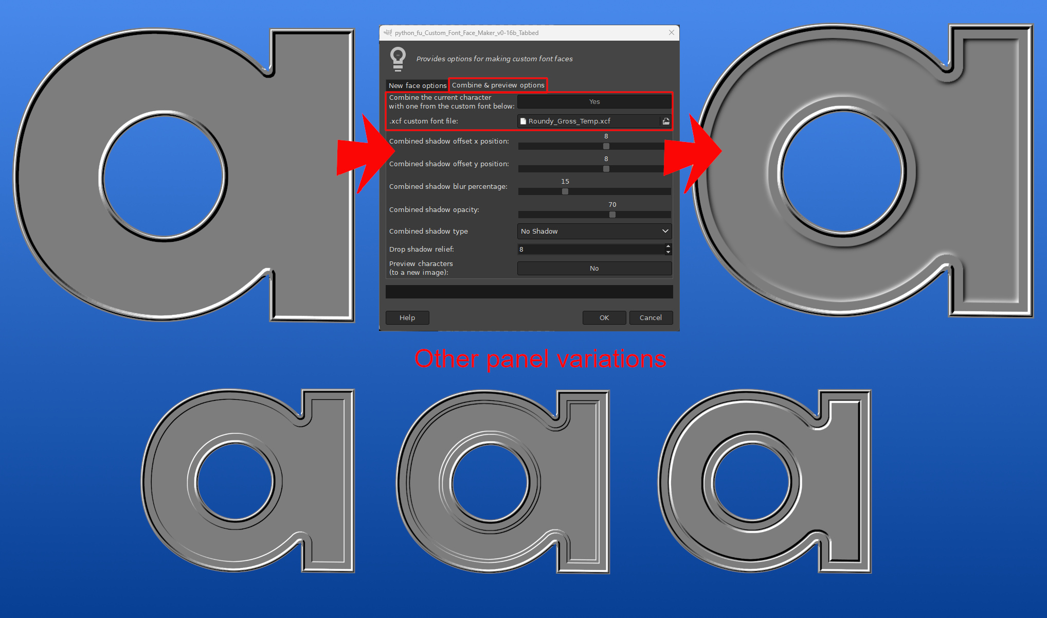

Return to, or re-open, the main custom font file and use FaceMaker again to combine the panel file.
Now we can see the effect taking shape (pardon the pun)...
If you have the will-power to continue you can even add further smaller panels by trimming the panel characters...
and giving the result a flat emboss before combining again.
As you can see my example is awaiting a final décor finish...

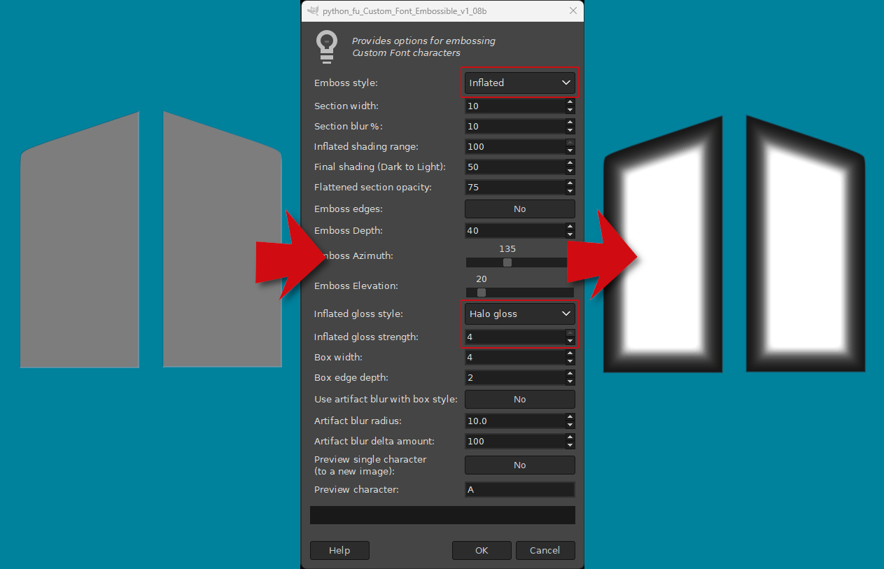

And finally, another example of panelling using the inflated and gloss styles with the Embossible filter:
and then using FaceMaker to add colour.
